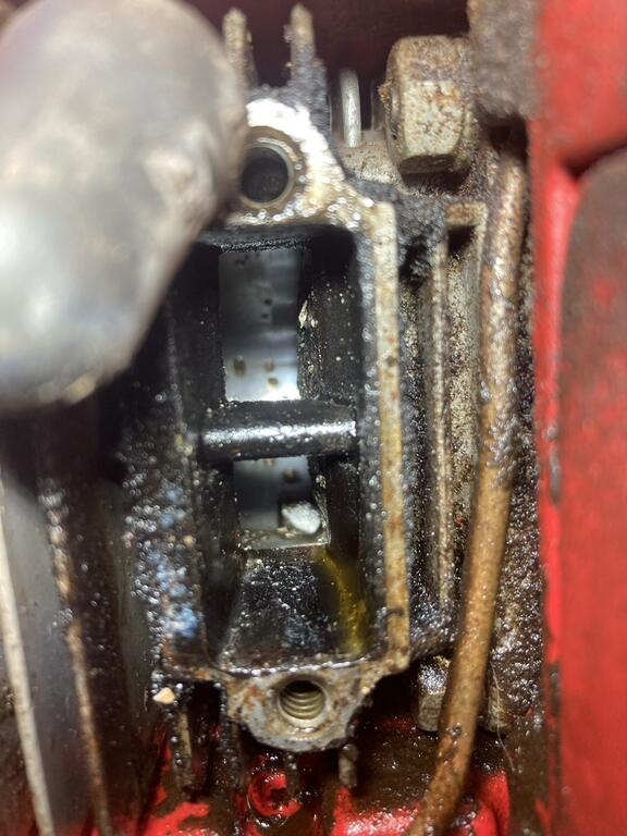

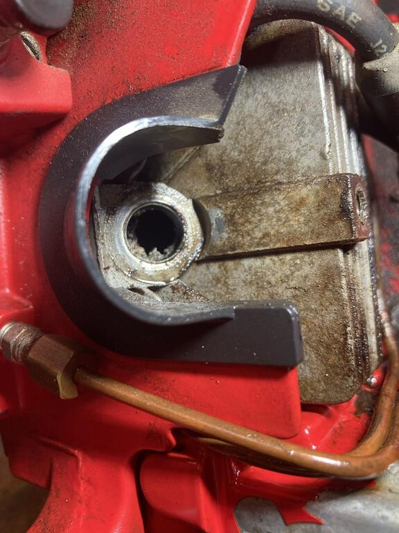

So I’ve ended up with another old homelite XL-12. When I got it, it was locked up solid. My initial thought was it was probably heat seized.
Until I pulled the plug and muffler and found… Sand? Speedy dry? Something gritty? But like big chunks that probably wouldn’t make it past the carburetor.
Almost like it was intentionally dumped in there. I cleaned it out and broke it loose. Seems to just have one scoring mark by the exhaust side of the piston. It will run for a second until I give it some throttle. Perhaps it still has the compression to run?

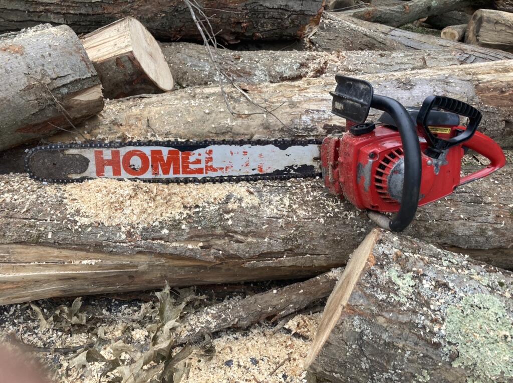

Regardless I hope to get this one running. It looks like a nice low hour saw. It has the original 24in bar as well. Most of the paint is good as well.531128D7-A5A7-410C-A60A-F3181AD8F754.jpeg.0002e19e5048a6cabeac7fec60bb33ab.jpeg

I suspect that the white stuff is corrosion that formed inside the engine.  Are you seeing sand in the intake or exhaust?

That looks like the stuff that was in my gt14 bowl when I started on it. A gritty, dry sandy texture gunk that I am still wondering what it was. Cleaned up and rebuilt the carb, changed fuel lines and hope to get it going soon.
oliver2-44
I picked up an old 50's boat motor and pulled the plug to see if it would free up.  It had several teaspoons of  Aluminum corrosion just like that..
Thankfully I just wanted it for a wall hanger!

Well, after a slight carb adjustment she’s building chip piles again. Got real lucky on this one.
honestly baffled how this still runs, let alone with 150PSI compression. Has slight scoring on the piston.
I’ll just use it as my beater saw. It’s rough all around but seems to run like a top
