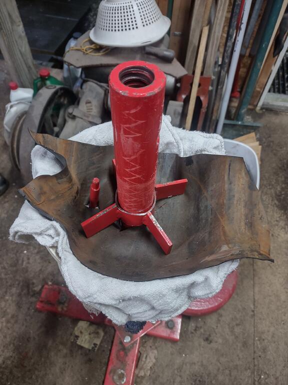

lynnmor 7,229 #28 Posted September 7, 2022 11 hours ago, ebinmaine said: Me n the BBT and Meeha Mirror finished up the Wheel Horse wheel party by removing the masking and airing them up. 14 lbs in the rears. We also mounted the tri rib tires on the 8" 5 hole rims I got the other day. Here's the HF manual tire changer with a rubber inner tube wheel protector. It kinda worked ok. Not perfect... Try flipping the spider so the tapered side is down. The drawings in the instructions show it your way but the text says the opposite. 1 Share this post Link to post Share on other sites
ebinmaine 66,449 #29 Posted September 7, 2022 4 minutes ago, lynnmor said: Try flipping the spider so the tapered side is down. The drawings in the instructions show it your way but the text says the opposite. Good suggestion and I remember catching that myself as well. I have tried it. If you look at the spider I have you can see that it's bent already. That happened pretty much the first or second time I tried to use the machine and flipping it upside down is... well let's just say it's not exactly user-friendly... I certainly can't say for sure I know what the answer is. I've considered making up some sort of a plate that uses one or two lug nut holes instead of the four legs. Share this post Link to post Share on other sites
lynnmor 7,229 #30 Posted September 7, 2022 12 minutes ago, ebinmaine said: Good suggestion and I remember catching that myself as well. I have tried it. If you look at the spider I have you can see that it's bent already. That happened pretty much the first or second time I tried to use the machine and flipping it upside down is... well let's just say it's not exactly user-friendly... I certainly can't say for sure I know what the answer is. I've considered making up some sort of a plate that uses one or two lug nut holes instead of the four legs. The hold down spider can't be counted on to stop rotation, the wimpy post thru a lug hole is for that purpose. Your idea of making a plate would go a long way towards improving these cheap tire changers. 1 Share this post Link to post Share on other sites
