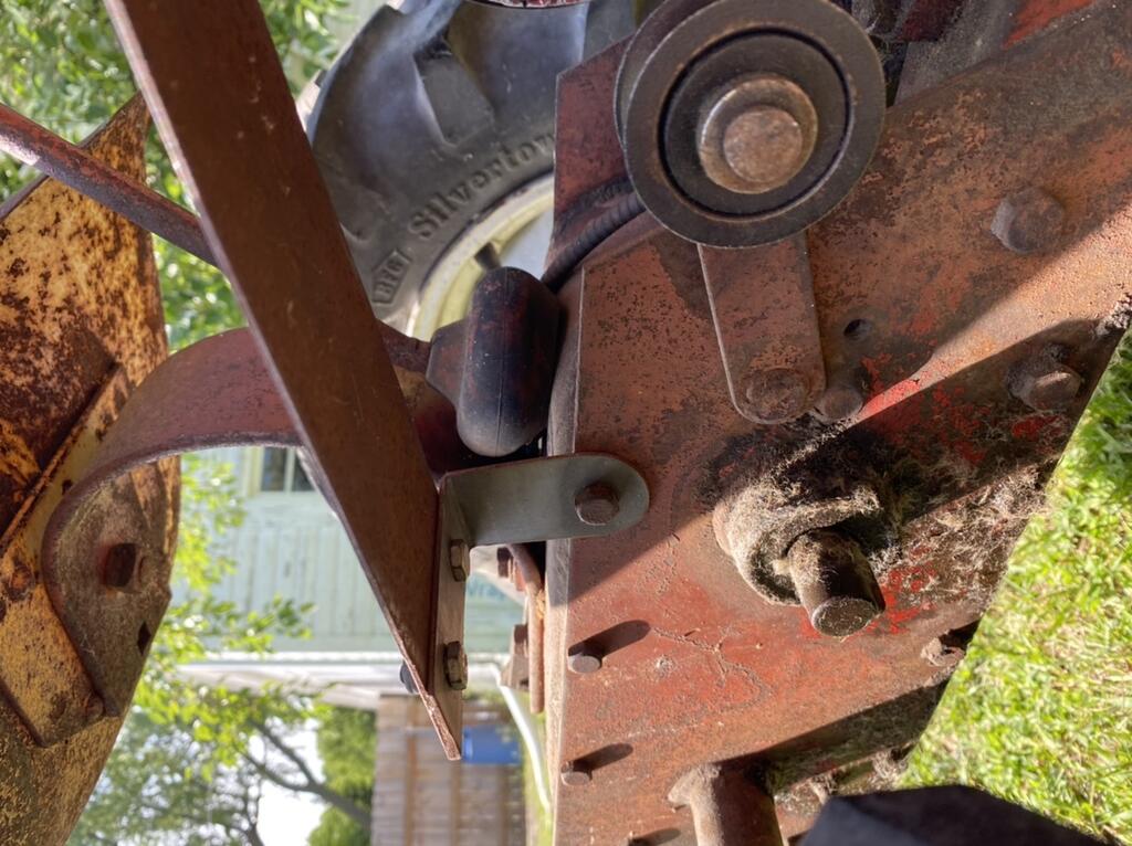

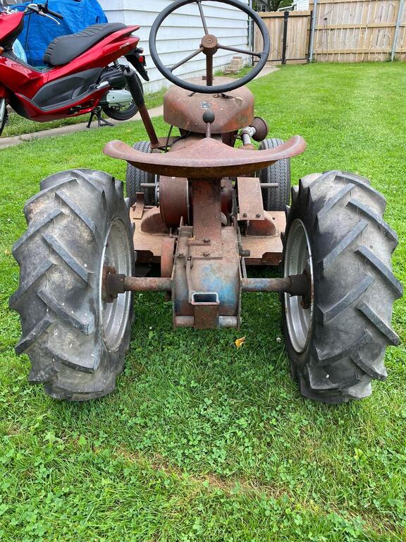

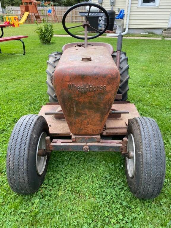

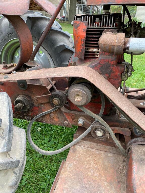

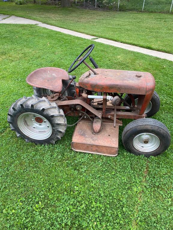

Laplantebd 92 #1 Posted September 3, 2022 Today I picked up this RJ-58. It’s missing the pulley on the gearbox but seems otherwise complete. Kohler K91 turns by hand. Previous owner never ran it. Anything else you guys can tell me about it? I only know what I’ve found the last few days searching around. Is the hitch thing on the rear homemade? Thank you. 6 3 Share this post Link to post Share on other sites
Pullstart 64,622 #2 Posted September 3, 2022 Nice find! The hitch is stock, the belt guard is not 1 Share this post Link to post Share on other sites

Pullstart 64,622 #4 Posted September 3, 2022 I noticed those pulleys, they don’t seem to be correct either. The idler/clutch pulley should be a v pulley not a smooth idler. Also, hood on to the muffler, that’s rare! Share this post Link to post Share on other sites

Laplantebd 92 #6 Posted September 3, 2022 5 minutes ago, Pullstart said: I noticed those pulleys, they don’t seem to be correct either. The idler/clutch pulley should be a v pulley not a smooth idler. Also, hood on to the muffler, that’s rare! thank you. That is a huge help! I’ll have to source a few pulleys and possibly a belt guard. 2 Share this post Link to post Share on other sites

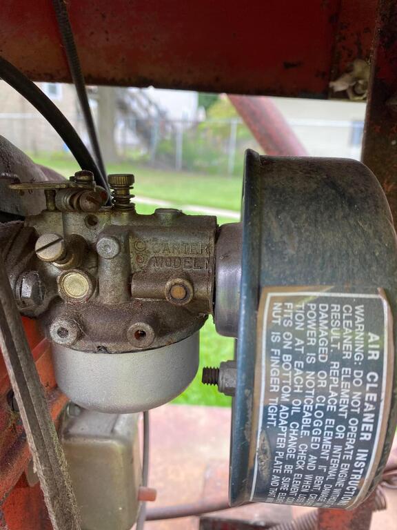

Handy Don 13,340 #7 Posted September 3, 2022 That Carter Model N is a nice carb--easy to rebuild and it just works. Share this post Link to post Share on other sites

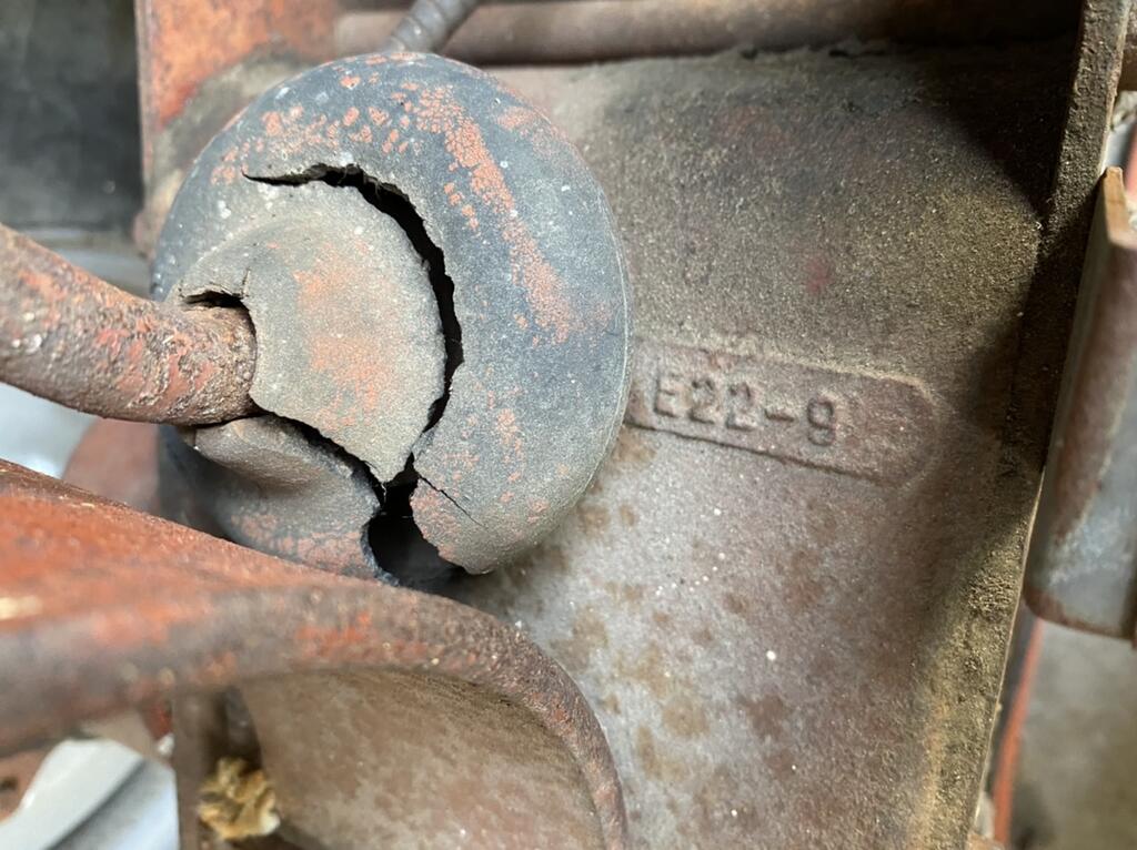

wallfish 17,514 #8 Posted September 3, 2022 (edited) The idler on a RJ does use a flat idler. It rides on the outside of the belt loop and pushes down on the belt. Tractors after that use a V idler on the inside of the loop. It's more like a RJ-59 but they were all tagged as RJ-58. The solid seat pan was late 59 into 1960. The height selector was probably added on by a dealer as those are 1960 There should be cast numbers on the trans next to the shifter. I'm guessing the last number is a 9 which would indicate 1959 Edited September 3, 2022 by wallfish 1 Share this post Link to post Share on other sites

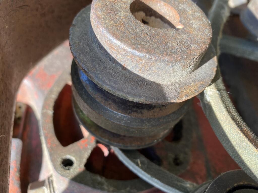

wallfish 17,514 #9 Posted September 3, 2022 (edited) The original pulleys on the engine would've been 2 separate 2 1/2" pulleys with the set screw for them in the groove, no hub on them. VERY difficult to find them now! That's the only way you could get a second pulley on for the deck. It went on after the belt guard because there was just a 1" hole in the guard for the shaft. Rear fenders were an option so you will see those tractors both ways. With or without fenders. Edited September 3, 2022 by wallfish 1 Share this post Link to post Share on other sites
Laplantebd 92 #10 Posted September 3, 2022 8 minutes ago, Handy Don said: That Carter Model N is a nice carb--easy to rebuild and it just works. Good to hear! 1 Share this post Link to post Share on other sites
Laplantebd 92 #11 Posted September 3, 2022 8 minutes ago, wallfish said: The idler on a RJ does use a flat idler. It rides on the outside of the belt loop and pushes down on the belt. Tractors after that use a V idler on the inside of the loop. It's more like a RJ-59 but they were all tagged as RJ-58. The solid seat pan was late 59 into 1960. The height selector was probably added on by a dealer as those are 1960 There should be cast numbers on the trans next to the shifter. I'm guessing the last number is a 9 which would indicate 1959 Very cool! Thank you for your insight. I’ll peek tomorrow for a trans number. Does the pulley on the engine look original? Or possibly original to the engine. Tractor data doesn’t list this engine as correct to the tractor. Being such a late production number is it possible to be original? Thank you again. 1 Share this post Link to post Share on other sites
wallfish 17,514 #12 Posted September 3, 2022 A Kohler K91 or a Clinton B1290 would be the original engines. Something looks funny with the pulleys but the diameter looks correct 2 1/2" , Maybe a better pic? Share this post Link to post Share on other sites
Laplantebd 92 #13 Posted September 3, 2022 Just now, wallfish said: A Kohler K91 or a Clinton B1290 would be the original engines. Something looks funny with the pulleys but the diameter looks correct 2 1/2" , Maybe a better pic? I’ll take a few and measure tomorrow. Thank you. 1 Share this post Link to post Share on other sites

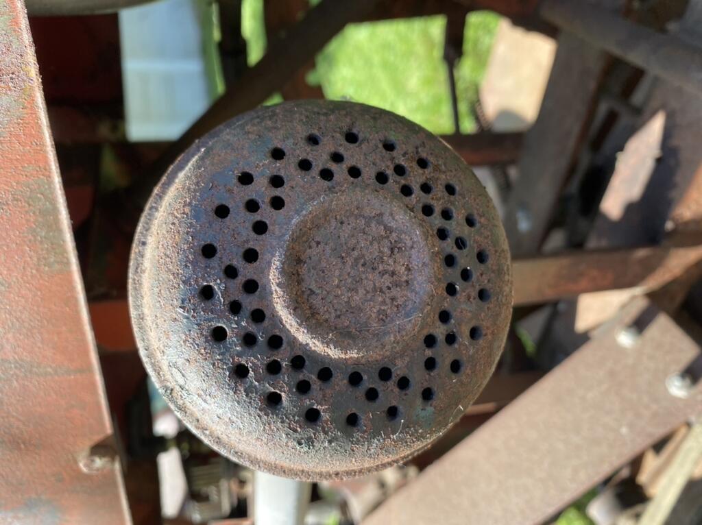

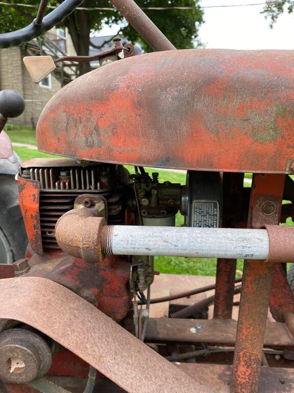

wallfish 17,514 #14 Posted September 3, 2022 (edited) Hopefully that shower head muffler isn't rotted out on the front. Those are an original item and rare The exhaust connection to the engine isn't normally done with a piece like that. The engine would have threads and the pipe just threads right into it. Looks like the gas tank is original too. Another difficult item to find. The outlet on them is opposite the fill neck. You can find more common type with the outlet under the fill neck. Very nice find there. Edited September 3, 2022 by wallfish 2 Share this post Link to post Share on other sites
953 nut 58,005 #15 Posted September 3, 2022 30 minutes ago, Pullstart said: Also, hood on to the muffler, that’s rare! A good shower-head muffler is highly prized by many collectors, take good care of it. 1 1 Share this post Link to post Share on other sites
Laplantebd 92 #16 Posted September 3, 2022 2 hours ago, wallfish said: Hopefully that shower head muffler isn't rotted out on the front. Those are an original item and rare The exhaust connection to the engine isn't normally done with a piece like that. The engine would have threads and the pipe just threads right into it. Looks like the gas tank is original too. Another difficult item to find. The outlet on them is opposite the fill neck. You can find more common type with the outlet under the fill neck. Very nice find there. Thank you. Valuable info! I’ll inspect the muffler. Should I pull it off and throw it on a shelf? 1 Share this post Link to post Share on other sites

wallfish 17,514 #19 Posted September 3, 2022 9 hours ago, Laplantebd said: Thank you. Valuable info! I’ll inspect the muffler. Should I pull it off and throw it on a shelf? Guess it depends on what your plans for the tractor are. Full restore trailer queen, you want it on there. Kids driving it around everyday, you might want to save it. Somewhere in the middle is a decision to be made. If you're not a fanatic factory correct kinda guy you can sell it to someone that is and finance some of the fixing expenses for the rest of the tractor. That person would love to have it so it ends up being in the right place and more appreciated and you get your tractor to a position you want it to be. Win Win Trade it for the parts and stuff you need? 1 1 Share this post Link to post Share on other sites
oliver2-44 10,371 #20 Posted September 3, 2022 Careful trying to remove that muffler, it may be tightly rusted in place. Replacement original belt guards and exhaust shields are getting hard to find, but you might contact A-Z tractor (in the Vendor Section) to see if he has any Repop belt guards and exhaust shields show up on Ebay from time to time. Share this post Link to post Share on other sites

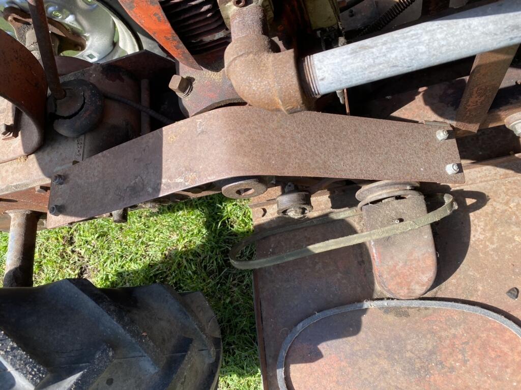

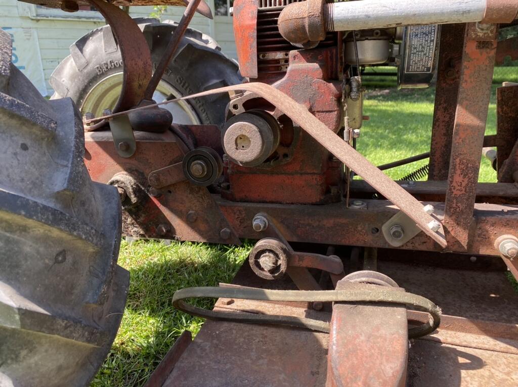

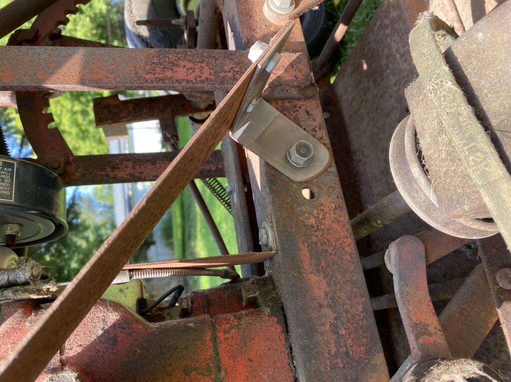

Laplantebd 92 #21 Posted September 4, 2022 A little follow up from yesterday and pictures of the belt cover for Freightliner Guy. Trans numbers end in “9” so it must be a late model production. All the gears appear to function (but rough). I’ll have to figure out the model # for a rebuild. The pulley on the engine is definitely not original if the original is a two separate pulleys. Muffler appears to be in good condition except unknown inside until I get it fired up. I would sell it to someone looking for one. Today I pulled the engine over a few times with rope. (Missing recoil) with a bit of spark. I’ll throw a new plug in and make sure points are set correctly before digging any deeper. Tonight I’ll try to find a service manual for the engine. Condenser must be under the flywheel? Points are really clean. My little girl was helping. 1 1 Share this post Link to post Share on other sites

wallfish 17,514 #24 Posted September 4, 2022 Yup, a 1959 as suspected Yes, the condenser and coil are under the flywheel. You can find a single pole to ground kill switch on ebay for that little hole in the hood below the steering wheel https://www.ebay.com/itm/254377392513?hash=item3b3a12f981:g:7xcAAOSwiWBdlS1V&amdata=enc%3AAQAHAAAA4GN40UW3L1KraA6%2B4k5UdZlPk%2BpMMBIgi66GWyjMnCwVqXRrE%2FvMvlUQ6aFtEZX8cL55QY%2FPqqIKmlfFBBqpDYCcL4cDivzH26ppv6va6wsV%2BieRzTyeZX6JdUvjs7YyrNuzdcZQm3vimQEM7ZVbrSWCwyCxlbZdOAEHOOxndg97ggc%2BXclwx6Pt0QKO3Q1Tp8x6n05tloug3WHwbvEiuaxBg64LbncBhxal45GeAV9vDmjLzFown6l5RGJdJ2MngXZMFSOpmiZ5TNaD4C2qXpyljqK6ccxlwak%2BK7%2B64R0U|tkp%3ABFBMxvuG5uBg Share this post Link to post Share on other sites
