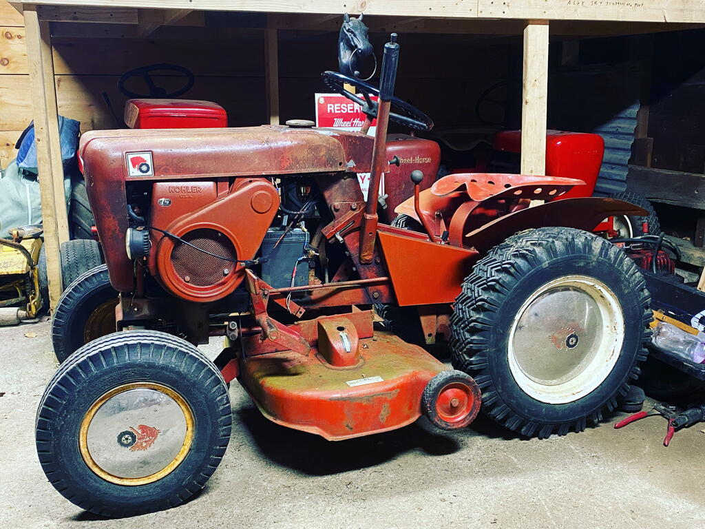

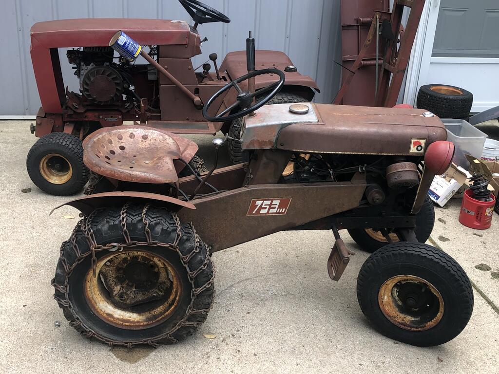

Rob J. 1,942 #1 Posted September 2, 2022 I just picked up this old guy today as part of my Labor Day haul. It’s pretty rough but salvageable. I’m gonna need some parts. I’m also in need of some detailed pics, I’m exactly sure what’s missing, what’s not right. If any of you can help I would most appreciate it. 3 3 Share this post Link to post Share on other sites
ebinmaine 70,815 #2 Posted September 2, 2022 Looks like a good solid rig. @Handy Don has an 854... 1 Share this post Link to post Share on other sites
Rob J. 1,942 #3 Posted September 2, 2022 1 minute ago, ebinmaine said: Looks like a good solid rig. @Handy Don has an 854... well I wouldn’t go that far but for the most part it is. It’s still gonna need some help and as you know me by now I hate cobbled up stuff. I understand the whole concept of just making it work as cheaply as possible but there are limits in my book. 😂 got to get some in depth info and pics to really know what I’m doing here. But that’s part of the whole deal. 2 Share this post Link to post Share on other sites

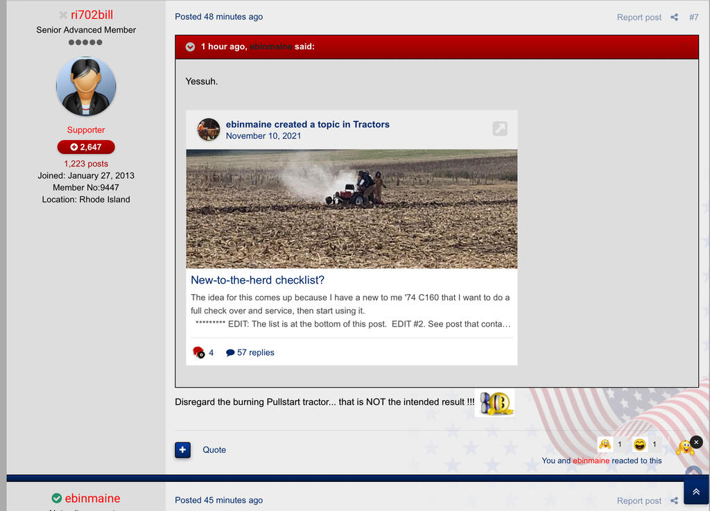

ri702bill 9,000 #5 Posted September 2, 2022 @Rob J. - Eric @ebinmaine did a great thread a while back about a "Checklist" for acquiring a new-to-you tractor to prepare to get it woken up from a nap. Lots of good info there... Bill 2 1 Share this post Link to post Share on other sites
ebinmaine 70,815 #6 Posted September 2, 2022 10 minutes ago, ri702bill said: @Rob J. - Eric @ebinmaine did a great thread a while back about a "Checklist" for acquiring a new-to-you tractor to prepare to get it woken up from a nap. Lots of good info there... Bill Yessuh. 1 1 Share this post Link to post Share on other sites
ri702bill 9,000 #7 Posted September 2, 2022 12 minutes ago, ebinmaine said: Yessuh. Disregard the burning Pullstart tractor... that is NOT the intended result !!! 1 2 Share this post Link to post Share on other sites
ebinmaine 70,815 #8 Posted September 2, 2022 2 minutes ago, ri702bill said: Disregard the burning Pullstart tractor... that is NOT the intended result !!! Prevention is the intention 1 Share this post Link to post Share on other sites

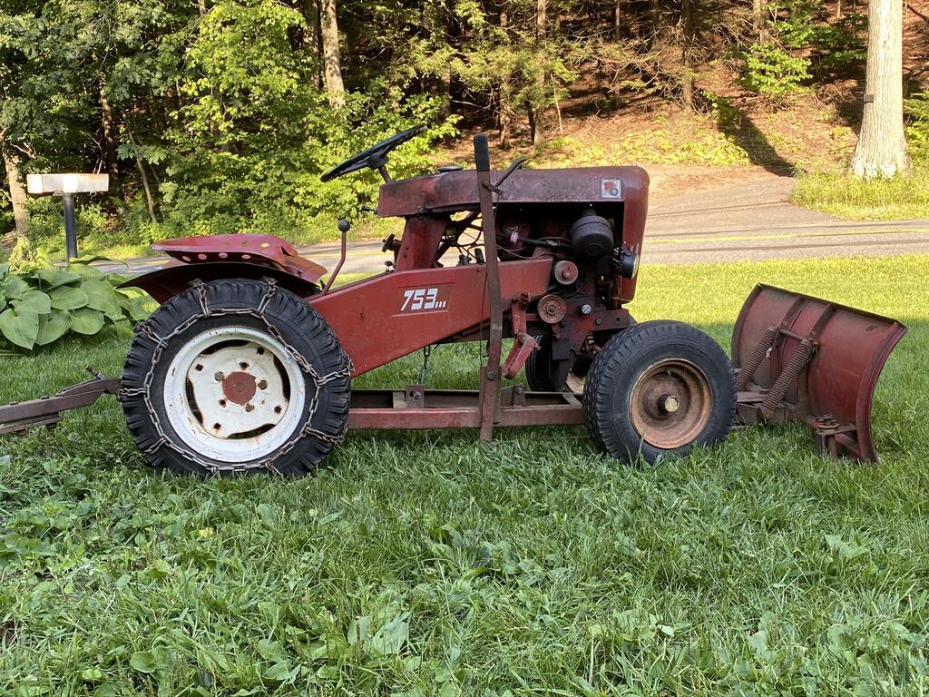

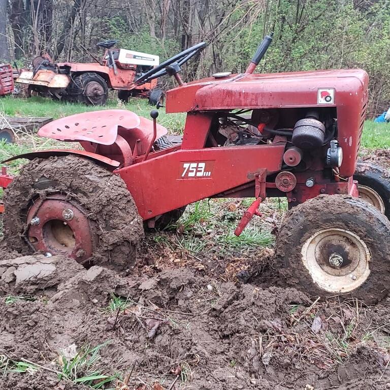

WHGuy413 2,771 #16 Posted September 5, 2022 753’s are great tractors. I have one that is my round hood worker. I mow, plow and use it to tow my heavy firewood trailer. My gas tank does seep out which I know I need to figure out soon. But other than that it’s a great little beast. 6 Share this post Link to post Share on other sites

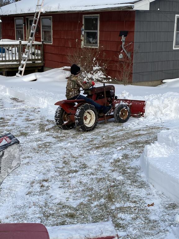

ri702bill 9,000 #19 Posted September 5, 2022 The right throttle setting and the right gear - makes pushin' the fluffy stuff look soooo easy. Course the heavy slurpee wet stuff can take a tank or 2 ... before it freezes.... Bill 1 Share this post Link to post Share on other sites
Handy Don 13,340 #20 Posted September 6, 2022 3 hours ago, WHGuy413 said: 753’s are great tractors. I have one that is my round hood worker. My short list was a 753 or an 854, whichever turned up first. Happened to be the 854. Can you share what kind of transaxle bracket you have for the front blade? A picture would be neat! Thanks. 1 Share this post Link to post Share on other sites
wallfish 17,516 #21 Posted September 6, 2022 53 minutes ago, Handy Don said: Can you share what kind of transaxle bracket you have for the front blade? A picture would be neat! Thanks. The bracket would depend upon which blade frame too The older A frame style would use the type of bracket that attaches front and back The newer style long/short adjustable frames would use the type of bracket that mounts top and bottom on the axle. They will both fit on the trans but the biggest difference is where it positions the lift linkage of the plow frame. It's about a 2 or 3" difference 1 2 Share this post Link to post Share on other sites
Rob J. 1,942 #22 Posted September 6, 2022 10 hours ago, wallfish said: The bracket would depend upon which blade frame too The older A frame style would use the type of bracket that attaches front and back The newer style long/short adjustable frames would use the type of bracket that mounts top and bottom on the axle. They will both fit on the trans but the biggest difference is where it positions the lift linkage of the plow frame. It's about a 2 or 3" difference I’ve taken it off but it was the kind that bolt on the front and back of axle. Share this post Link to post Share on other sites
