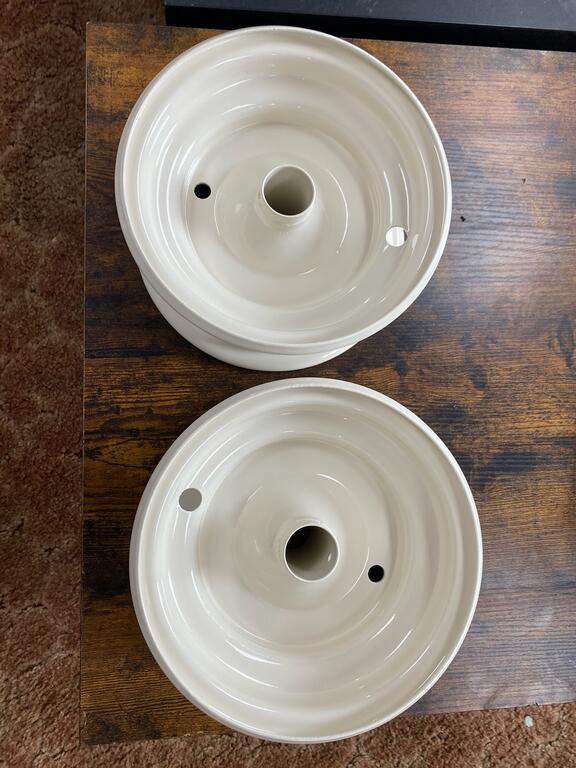

rmaynard 16,690 #27 Posted September 17, 2022 I just got the rims back from my new powder coater last night. This is Oyster White, RAL-1013. $50.00. 9 Share this post Link to post Share on other sites
sjoemie himself 3,106 #28 Posted September 17, 2022 You can not complain about such a finish for that price. Looks smooth as a baby's.. eh.. 'unidrive' 1 Share this post Link to post Share on other sites
rmaynard 16,690 #29 Posted September 20, 2022 (edited) UPDATE: I got the rims back, my new tires arrived, and today I mounted them. What a relief. The color is Oyster White, the tires are Kenda LoadStar. I think that I am finally happy. Edited September 20, 2022 by rmaynard Added picture 3 5 Share this post Link to post Share on other sites

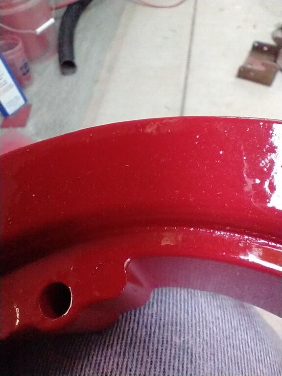

rmaynard 16,690 #33 Posted June 10, 2023 (edited) Moving on from wheel paint to body paint. I'm not going to bore you with all the gory details, but I'll try to make this as short as possible. All sheet metal has either been stripped, sanded, or media blasted. Bare metal has been primed with etching primer. All others have been primed, blocked, sanded, and on and on. So now I attempted to paint using PPG Prime-line, single-stage acrylic urethane. I've painted 6 of my show tractors with the same paint. After applying the first flash coat, I let it sit for 5 to 10 minutes, then applied two more medium wet coats. PROBLEM: solvent pop. It's hard to get a good picture but here is one. My body shop buddy says it's dirt. I say it's not. After final sanding, I washed with mild soap and water. Let dry over night. Then used wax and grease remover. Used new rag until no color came off.Then I tack ragged. Next step was 2K acrylic urethane primer/sealer. That, went on great. Smooth as silk. Then, after a one hour dry time (manufacturers instructions) I again lightly tacked and shot a flash coat of my Single Stage acrylic urethane. Let sit for 5 minutes, came back and it had already begun to pop. I'm totally puzzled. Mixed another batch using a slow activator. Same problem. I'm beginning to wonder if there is something going on with PPG paint. Any help from you paint pros would be appreciated. By the way, outside temp today 75-78. Low humidity. No Canada smoke. Painting in a fine mesh screen room. Edited June 10, 2023 by rmaynard 1 Share this post Link to post Share on other sites

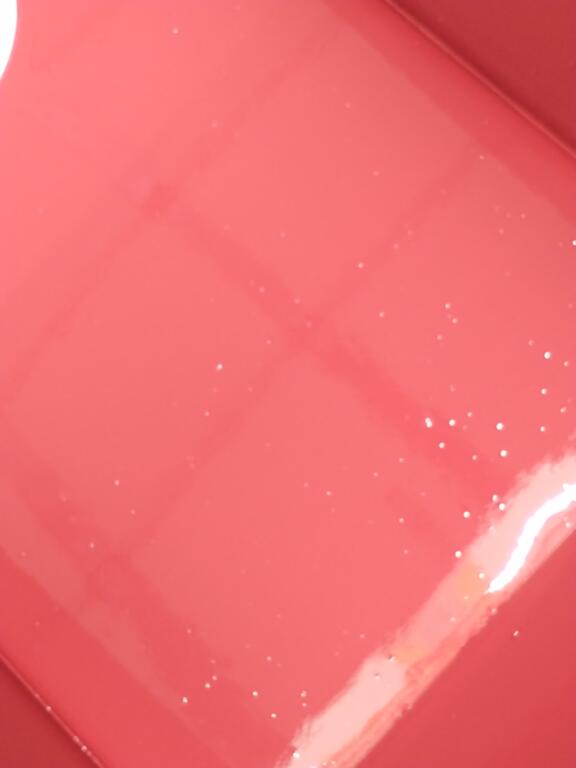

rmaynard 16,690 #35 Posted June 11, 2023 (edited) @squonk Mike, I have read that. It is a confusing mess. Today I took two pieces that had 2 coats of 2K acrylic urethane, fully cured (painted 2 weeks ago) but was the wrong color. I sanded with 400. Then they were washed with soapy water, dried 24 hours, cleaned with wax and grease remover, then tack ragged just prior to painting. I then shot two coats of 2K acrylic urethane primer sealer. Top coated with the new color after 14 hours. That failed (pops). So again I sanded the pops with a progression of 320 to 500, prepped the surface with 800 grit sanding sponge, essentially creating a base coat. Then, after proper cleaning, I shot 2 coats of 2K clear. I got the same pops. However, what I noticed was that the pops were only on horizontal surfaces. Verticals had none. So, I'm back to trying to find why whatever I spray tries to gas out under a drier surface and creates pops. These two pieces will be sanded again tomorrow and I will clear coat them vertically. If that fails, I quit. Edited June 11, 2023 by rmaynard 1 Share this post Link to post Share on other sites
squonk 44,859 #36 Posted June 11, 2023 There wasn't any aerosol can sprayed in the vicinity before you painted was there? That stuff can linger in the air. Even from a neighbor. We had a paint booth at the end of a long shop where I used to work. They were supposed to let us know when they were painting. Well one guy was too important to let anyone know and he started painting when a guy in the prep bay was spraying silicone on a new car weather strip. Fish eyes and bubbles everywhere. Share this post Link to post Share on other sites
rmaynard 16,690 #37 Posted June 11, 2023 40 minutes ago, squonk said: That stuff can linger in the air. I use HVLP which tends to have very little overspray. A single tractor is a lot different than a high volume body shop. Share this post Link to post Share on other sites
