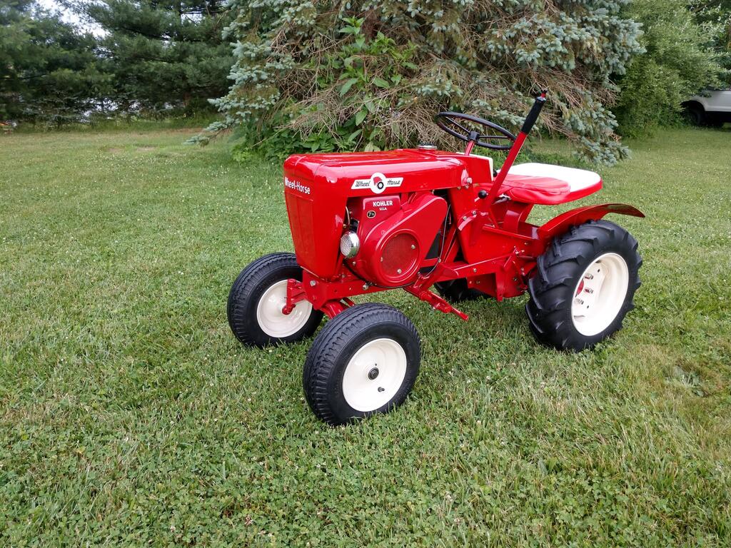

Darrenw85 625 #11 Posted September 3, 2022 Bob, I have all my wheels powder coated, I also have the frame, front axle, footrest and a few other parts powder coated too. The powder coat color for my wheels is porcelain white from prismatic powders. Here is the last one I restored. 7 1 Share this post Link to post Share on other sites
