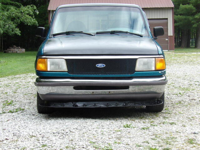

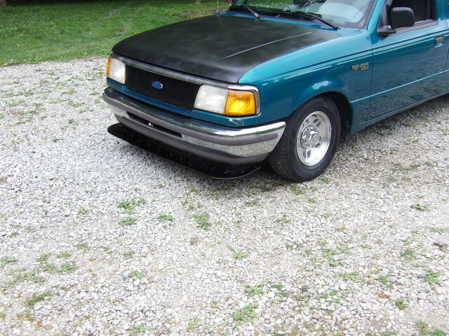

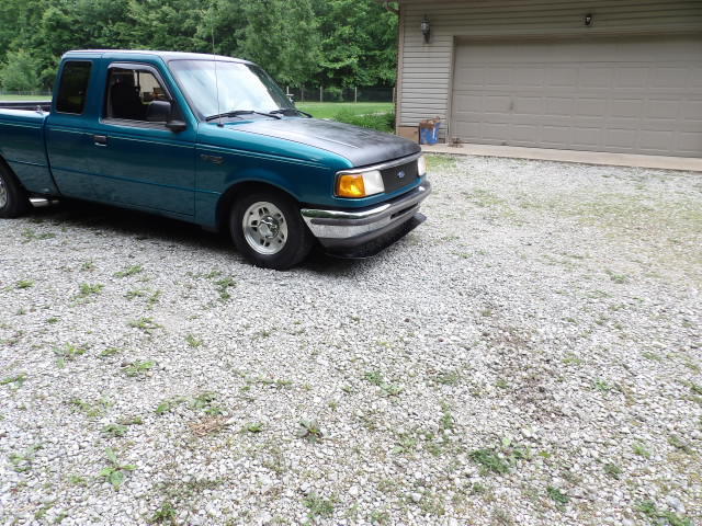

Snoopy11 5,723 #1 Posted September 2, 2022 Hello my good people, I don't know if any of you can help with this... but a few of you know that I lowered my '97 Ford Ranger. Well... obviously after doing the lowering... I have some negative camber... something like -2 I realize that the car will probably handle well on the road with this setup in the front... but I worry about tire wear. Thus... a good while ago... I bought these camber bushings... There is only 1 small problem. I HAVE NO CLUE HOW TO INSTALL THEM!!! They came with instructions... but I am truly lost. I would love to install these in a couple of weeks after I finish up some engine stuff on the Ranger... and fix the golf cart. I have another project machine coming later this month... so I hope to get this camber situation resolved before then. Thanks guys, I'd appreciate anything you've got! Don 1 Share this post Link to post Share on other sites

Jeff-C175 7,207 #13 Posted September 2, 2022 (edited) Your pic shows the 'twin I-beam' suspension. So what I said earlier about the BOTTOM was wrong. I thought you had control arms, etc... I think a proper alignment is probably the best also. Keep in mine that changing the camber will also affect the toe a slight amount. Probably not enough to be noticeable, but it will change. When you move the top of the knuckle OUT to give more positive camber, the tie rod will not be a tiny amount too short. But, since you lowered it, the toe is probably already out anyway! I gather you're not a fan of this: Or, heaven forbid, the "Carolina Squat" ? Edited September 2, 2022 by Jeff-C175 3 Share this post Link to post Share on other sites
