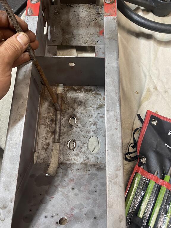

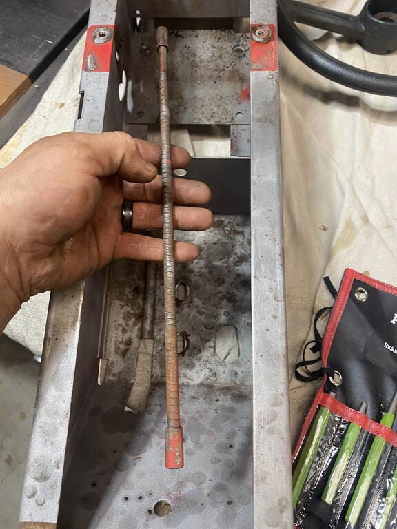

Heatingman 971 #1 Posted August 31, 2022 B80 tractor - sandwiched between the differential and the tins that hold the steering column. Even has a tunnel molded into the tin. So clearly it’s intended to be there. Looks like maybe a way to route a cable, but there is / was no cable in it. 1 Share this post Link to post Share on other sites
ebinmaine 69,239 #2 Posted August 31, 2022 1 minute ago, Heatingman said: maybe a way to route a cable You nailed it. That's the holder for the rear lift cable. 4 Share this post Link to post Share on other sites
daveoman1966 3,762 #3 Posted August 31, 2022 That is the Lift Cable CONDUIT. It mounts under the hoodstand...in that 'tunnel'. The hoodstand is then bolted to the trans, of course, allowing the Lift Cable unobstructed movement when liftin rear implements. It sticks out a bit in the back for you to route the cable. The CONDUIT will also move inside that tunnel...it isn't supposed to be a tight fit...has to move a little. 4 1 Share this post Link to post Share on other sites
ebinmaine 69,239 #4 Posted August 31, 2022 2 hours ago, daveoman1966 said: The CONDUIT will also move inside that tunnel...it isn't supposed to be a tight fit...has to move a little Did not know that Dave. I'll keep the movement in mind. Good info. Thank you. 1 Share this post Link to post Share on other sites

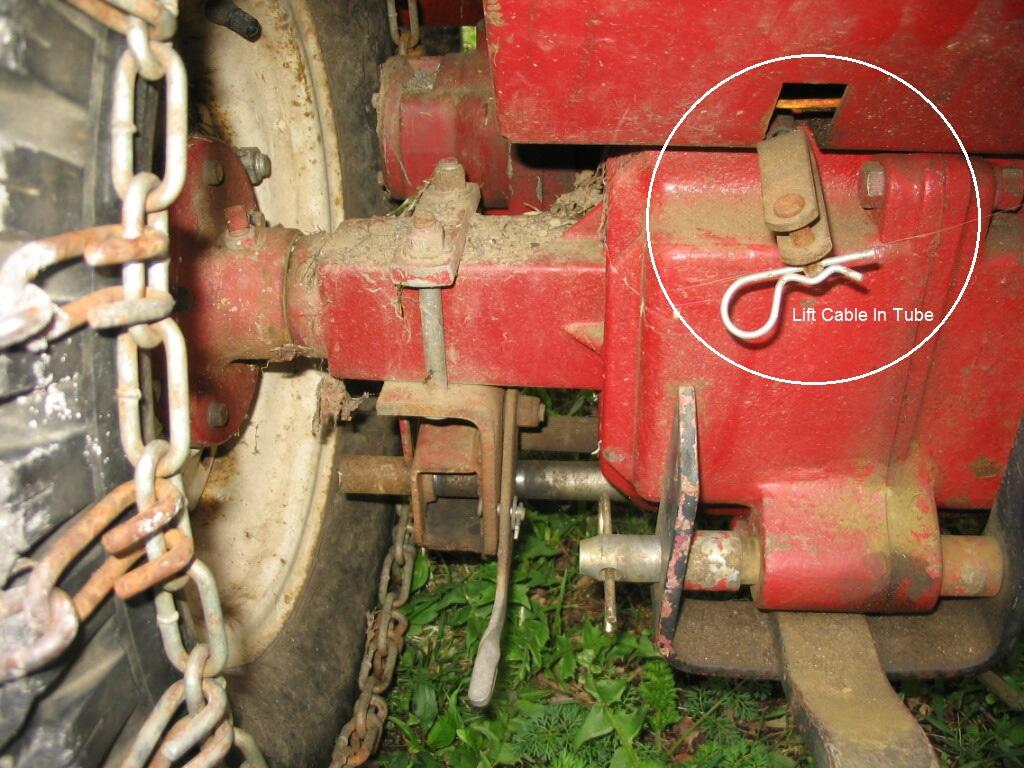

Achto 28,060 #5 Posted August 31, 2022 Here is a pic with the cable attached to the rear slot hitch. 3 1 1 Share this post Link to post Share on other sites
Pullstart 63,287 #6 Posted August 31, 2022 Nailed it! Share this post Link to post Share on other sites

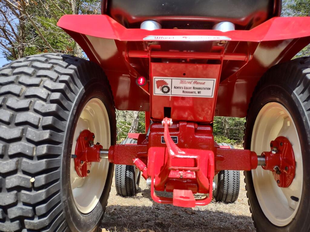

oliver2-44 9,976 #7 Posted August 31, 2022 4 hours ago, Achto said: Here is a pic with the cable attached to the rear slot hitch. @Achto Love the Equine Rehab decal! 1 1 Share this post Link to post Share on other sites

ebinmaine 69,239 #9 Posted August 31, 2022 1 hour ago, oliver2-44 said: @Achto Love the Equine Rehab decal! Nice catch. I hadn't seen that..... 1 Share this post Link to post Share on other sites
TJ5208 1,824 #10 Posted August 31, 2022 11 hours ago, Achto said: Here is a pic with the cable attached to the rear slot hitch. I seen this the day he got it done it's one tractor. 1 1 Share this post Link to post Share on other sites
