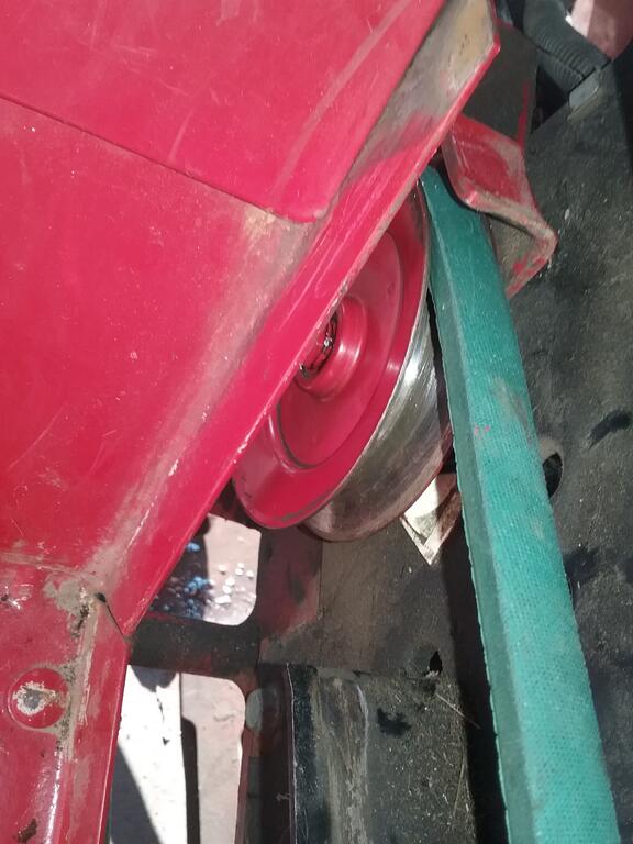

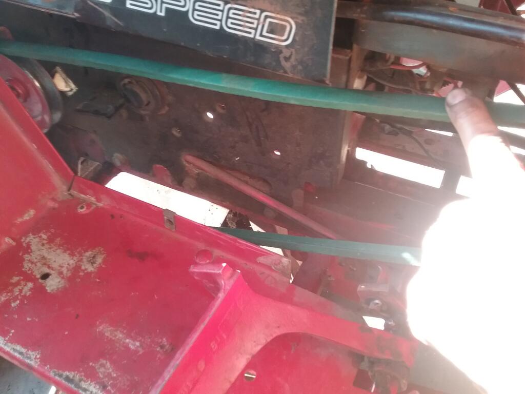

Dans 414-8 2 #1 Posted August 29, 2022 Hi !! new to me both my 414 8 and this site thanks for having this site! I just got a 414-8 when sitting lots of gear lube came out the guy that sold me it told me ahead of time. Easy to see the brake seal was leaking bad so I took it our and ordered a new one However when I test drove my new to me 414 8 the belt to the transmission squealed a lot it did quiet down but I like to ask IF their is a adjustment to tighten it up I took the side cover off but do not see any the belt really looks ok .. I think the gear lube that was leaking when he had it might of gotten on the belt So not sure what to do I like to ask you what you would do to correct this problem also I like to add... their is a snow plow on it and that's the reason I bought it I do not plan on using the grass deck Its missing a blade and bearing assembly anyways but want to use the wheels for the snow plow because I don't have cement or or asphalt in my parking lot just lots of rocks and dips ..thank-you ..daniel aka dans414-8 Share this post Link to post Share on other sites

Dans 414-8 2 #3 Posted August 29, 2022 Thanks I'll send some pictures its really clean no rust , if you grab the belt theirs around 1 1/4 or so of slack maybe be less but, how much slack with foot off pedal should their be? thanks ...daniel aka dans414-8 Share this post Link to post Share on other sites
wallfish 20,510 #4 Posted August 30, 2022 Belt squeal can be caused by a few things. The wrong belt. It should be a cloth covered belt and not all rubber. Wrong size belt Check the idler pulley that tensions the belt. If it's stuck or very hard to turn the belt will squeal passing through it Not enough spring tension. The spring that applies tension for the belt is on the opposite side connected at the linkage near where the brake band is Gear oil on the belt can be a problem. Look for evidence of "belt dust" caused from the belt slipping in a pulley groove. The belt will wear and therefore leave dust in that area. If present, it will help indicate where the belt friction is causing the squeal. 1 1 Share this post Link to post Share on other sites
Dans 414-8 2 #5 Posted August 30, 2022 Hello Again! Thanks for the info.. I want to replace the belt all looks fine grease pulley is free etc. My understanding is the original belt was a 7473 81.9 x 5/8 Napa has a 5L820W belt that is 82.01 x 5/8 then they have next size down 81.x 5x8 not sure of number parts guy told me the length only So do you think the above 5L820W is the one or?? again! thanks for the info....daniel aka dans414-8 Share this post Link to post Share on other sites

Dans 414-8 2 #9 Posted August 31, 2022 Good morning had Napa sent the belt today while I did, I noticed the back idler pully and transmission drive input pully had a lot of burnt build up so I sanded and wire brushed them , then I put on the napa belt what a deference as far as play up and down The guy I bought it told me he had used it to push alot of stone gravel etc It must of heat stretched alot. All that need done now is today the mailman in bringing oil seal behind the brake shaft. then some paint and seat repair... again Thanks guys for the help along the way.. daniel aka dans414-8 Share this post Link to post Share on other sites

Handy Don 17,316 #11 Posted August 31, 2022 (edited) 1 hour ago, Dans 414-8 said: The guy I bought it told me he had used it to push alot of stone gravel etc It must of heat stretched alot. Actually, belts don't stretch (they have the same internal cords as car tires). Really. Over time the sides wear down so they get thinner and drop down deeper into the pulley grooves so they appear to be longer! The fabric on the outside is usually Kevlar (or similar) and it has two jobs: 1) allow the clutch mechanism to deliver a smooth starts (plain rubber sides will grab quickly), and 2) extend the life of the belt by lasting longer than plain rubber sides. Edited August 31, 2022 by Handy Don Share this post Link to post Share on other sites
Dans 414-8 2 #12 Posted August 31, 2022 HI guys thanks for the responses yes I lubed that area with Lucas gun oil found that its the best so far I been using Makes sense that the belt wears and goes in lots most likely why I had a lot of burnt type of material in between the pullys Just got done putting in the brake shaft seal 100441 SO FAR NO leaks Ill keep checking for proper level once the fluid settles going to ask a question in the motor part about fuel filter again thank-you daniel aka dans414-8 1 Share this post Link to post Share on other sites
