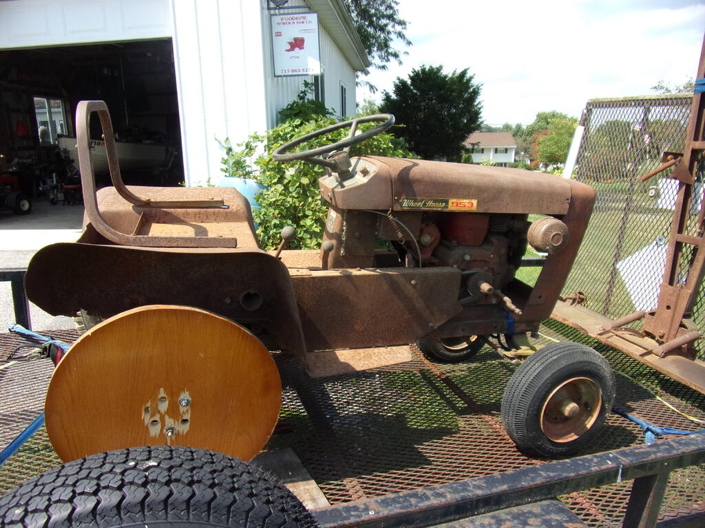

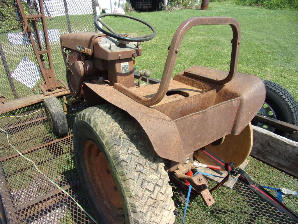

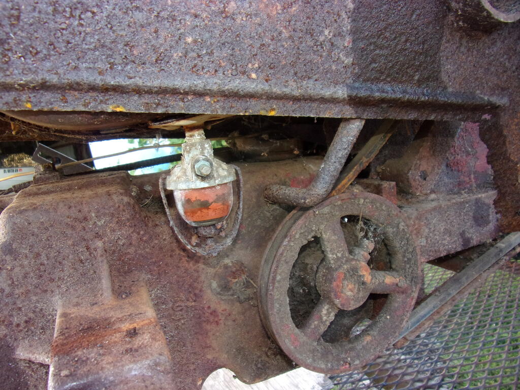

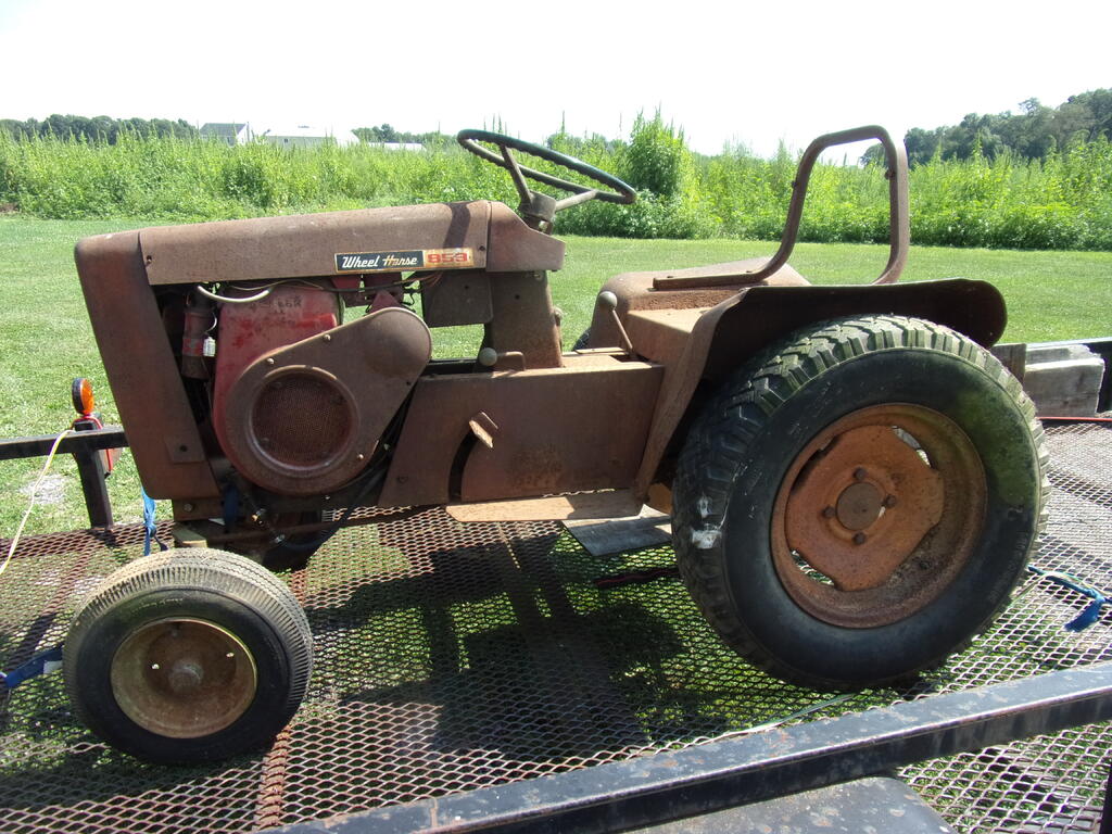

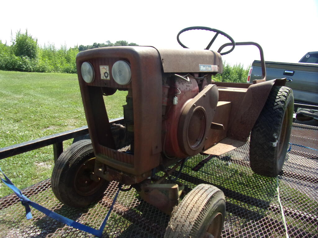

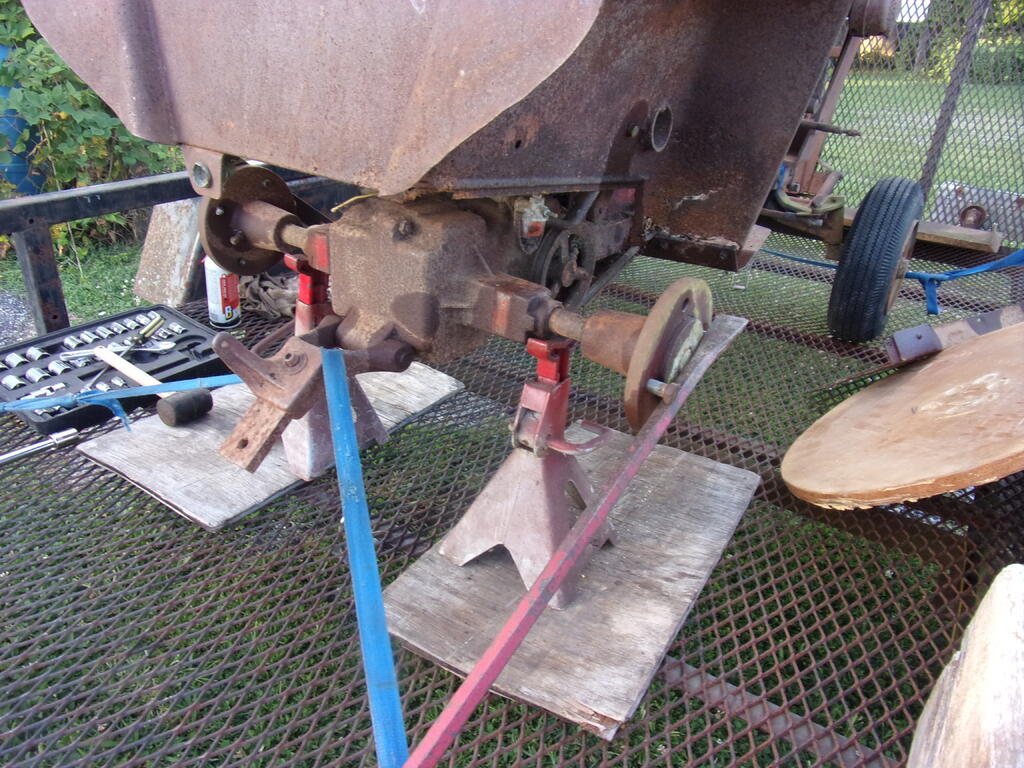

Ed Kennell 40,410 #1 Posted August 27, 2022 I picked up this 953 yesterday. It came with a snow plow but was missing the right rear wheel. The PO states he was plowing his garden about 10 years ago when the wheel rusted through from the calcium and fell apart. I have no reason to doubt him because it was still setting at the end of his garden. So, I found this old table top in my lumber pile, drilled a few holes and made a spare wheel. I was able to drag it on the trailer, but the differential was locked. The good left wheel turned OK, but the wooden wheel was turning the opposite direction and sliding. After I got it home, I pulled both wheels and the belt guards off to check the brake and input pulleys to be sure they were free. They were OK. Checked the fluid in the tranny and found about a 1/2 " of a tar like goo. Just enough to glue the gears together and prevent it from rolling. By locking one axle and with a bar, I was able to break the gears loose and get the wheels to turn properly and check that the shifter and all gears were working properly. So my plan was to pull the seat pan so I could pull a bolt on top and fill the tranny with diesel and get it flushed and freed up to roll it off the trailer. Now comes the question....It appears the fenders, seat pan, side plates and gas tank are all one welded assembly. Does this mean everything must be remover including the clutch and brake assemlys and the hydraulic lift pump just to get the seat pan off? I may have to add this to my list of Wheel Horse engineering goofs along with the rubber mounted engines and mounting fuel tanks below the fuel pumps. Thoughts on cutting a section out of the seat pan to remove the fuel tank, then bolt it back on. Oh, @19richie66 and @ebinmaine have officially dubbed this one "FRED". 2 2 1 Share this post Link to post Share on other sites
squonk 42,456 #2 Posted August 27, 2022 Ya Ed. I know you're "supposed" to remove the transmission to remove the fuel tank. I'm sure someone has done something different. 1 1 Share this post Link to post Share on other sites
953 nut 57,766 #3 Posted August 27, 2022 Nice find, looks better than one 953 you had on that trailer. got to love that wooden wheel, cold be the latest trend in tractor design! You are spot on when it comes to a design goof. The transmission needs to be removed to do anything with it or to remove the gas tank. The pump can stay but the pivot end of the hydraulic lift cylinder makes it a tight squeezer to remove one of the transmission bolts but it is basically four 3/8" bolts, lower belt guide, fuel line and brake rod and you are off to the races. Have to tilt it forward as it is being removed to clear the shift lever. 3 1 Share this post Link to post Share on other sites

Ed Kennell 40,410 #5 Posted August 27, 2022 5 minutes ago, 953 nut said: The transmission needs to be removed 37 minutes ago, squonk said: remove the transmission OK, I didn't even consider that. Guess I bolt the wheels back on, drag it in the shop, and pull the transmission. 10 minutes ago, 953 nut said: better than one 953 you had on that trailer. But that one had 4 wheels Richard. Should I bring this one to the 2023 show for you? 2 1 Share this post Link to post Share on other sites

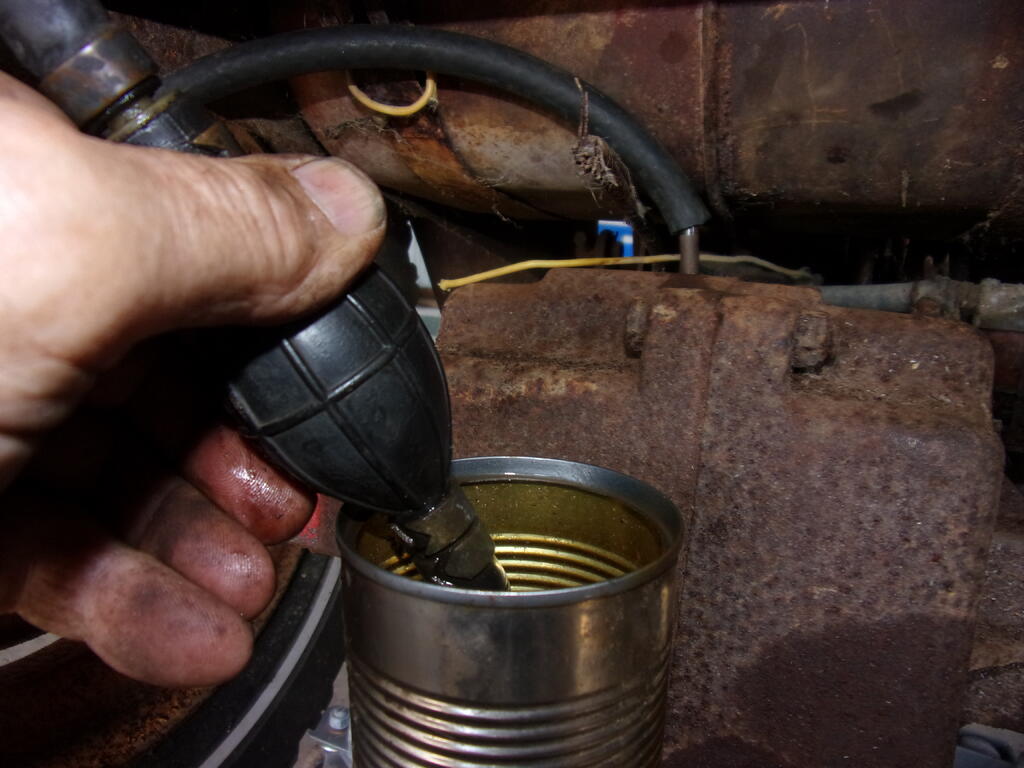

Ed Kennell 40,410 #7 Posted August 27, 2022 I put the wheels back. With the transmission freed up, she rolled of the trailer with ease. After raising her up I could get the bolt out that clamped the rear lift cable. I was able to pump the tranny full of diesel thru that hole. No need to remove the tranny or seat pan. The right axle seal and the input pully seals are leaking. Looks like the dreaded hub removal is next. 4 Share this post Link to post Share on other sites

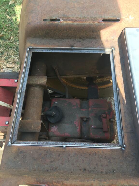

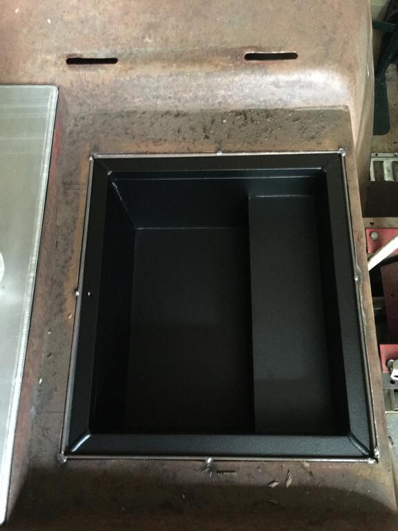

19richie66 17,560 #8 Posted August 28, 2022 Mine already had a hole cut below the seat so I just finished it off and made a package tray. I moved my tank to the tool pocket. Of course Jay(JPWH) has it now. You can see in the first picture how the frame is welded across the front of the fender pan. Not the easiest thing to service when stock 5 Share this post Link to post Share on other sites

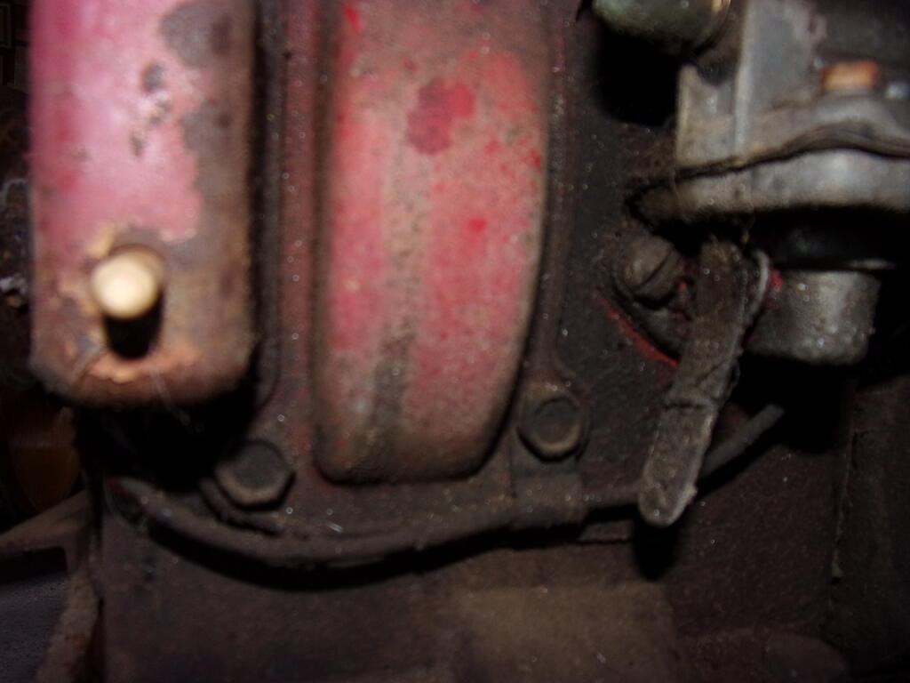

Ed Kennell 40,410 #9 Posted September 1, 2022 Nuther 953 question. I understand the primer lever on the fuel pump, but what is the purpose of the plastic plunger on the points? Why would you need to hold the points open? Share this post Link to post Share on other sites
Handy Don 13,338 #10 Posted September 1, 2022 The plastic bugger shorts out the points. If the points don't open, no collapse of the magnetic field and so no spark. Engine stops. 1 Share this post Link to post Share on other sites
Ed Kennell 40,410 #11 Posted September 1, 2022 27 minutes ago, Handy Don said: Engine stops So it's just an emergency kill switch? 1 Share this post Link to post Share on other sites
Handy Don 13,338 #12 Posted September 1, 2022 23 minutes ago, Ed Kennell said: So it's just an emergency kill switch? Exactly! Share this post Link to post Share on other sites
Ed Kennell 40,410 #13 Posted September 1, 2022 4 minutes ago, Handy Don said: Exactly! Seems like a poor location for a kill switch, but.... 1 Share this post Link to post Share on other sites
Handy Don 13,338 #14 Posted September 1, 2022 3 minutes ago, Ed Kennell said: Seems like a poor location for a kill switch, but.... Simple and direct. Works for all points engines (battery or magneto). And yeah, we have a runaway tractor so lets stick our hand in past the PTO pulley and shut 'er off. Right! 2 1 Share this post Link to post Share on other sites
