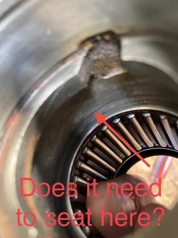

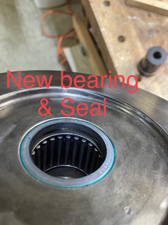

I’m replacing bearings and seal on the PTO bell housing. Up until this point, before taking ANYTHING apart, I’ve been taking numerous pictures so I can use for reference. Well, I took some of bearing placement before removal, but not enough. It may be ok. The picture of old needle bearing and seal looks like there’s a small gap between bearing and seal (I should’ve measured, I measured the other bearing depth before removal). Well, after getting new bearing in, I installed seal. The gap looks the same as prior to removing old one. But, after flipping over to install other bearing, I noticed a “lip” inside that I’m wondering if I should’ve “drove” bearing into. But, the gap between needle bearing and seal would be greater than before. If the old bearing was in correct, it wasn’t seated on the lip, I don’t think. Can someone verify if this bearing is on correctly or if it needs to “seated” on this lip? I should’ve taken my time before removing!! Thanks!

Last one I did I seated it against the land, but I don't think it will be a problem.
I hope you pressed that in and not drove it in?
Agree with Jeff....you should be ok.....Also see the post for Grease. I have seen them on the land and everywhere in between. Never beat a bearing in.....you did press it right?

Yes, I pressed it in.
Which post are you referring to about the grease?

I would think you would want it seated as well, it just threw me off by not being seated when it came off. I don’t recall my dad ever changing those bearings, but may have. I’d give $1 million just to be able to ask him!!

And don't use 'too much' grease in that housing.  You don't want it oozing out past the bearing on the outside, or the seal on the inside.

I used a big C-Clamp and a thick piece of copper to press mine in.Was a tight fit for sure.
Yours looks good

I’ve got a really strong wood vise that usually does the trick.
