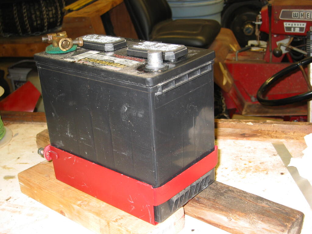

peter lena 9,092 #13 Posted August 24, 2022 @Alex175 last photo , showing battery tender plug in and additional ground cable to engine frame area , pto lever start washers , pete 1 Share this post Link to post Share on other sites
