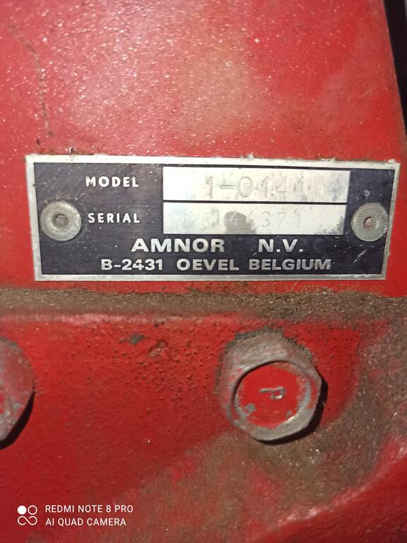

953 nut 57,998 #7 Posted August 23, 2022 The model numbers for decks made in Belgium are not the same as the ones in the USA. If your deck is a 36 inch rear discharge then the drive belt would be 1/2" by 90" long. If it is a 36 inch side discharge mower the drive belt is 1/2" by 86" The belt for the spindles on the deck is 1/2" by 77" for both decks. Les numéros de modèle des decks fabriqués en Belgique ne sont pas les mêmes que ceux des États-Unis. Si votre plate-forme est une décharge arrière de 36 pouces, la courroie d'entraînement mesurerait 1/2 "sur 90" de long. S'il s'agit d'une tondeuse à éjection latérale de 36 pouces, la courroie d'entraînement mesure 1/2" sur 86". La courroie pour les broches sur le plateau est de 1/2" sur 77" pour les deux plateaux. 1 Share this post Link to post Share on other sites
gwest_ca-(File Mod) 11,252 #8 Posted August 23, 2022 2 pages of search results that may apply https://www.wheelhorseforum.com/search/?q=1-0141&quick=1&type=downloads_file Share this post Link to post Share on other sites

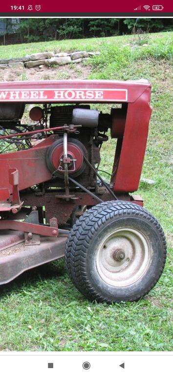

loic 6 #9 Posted August 23, 2022 C est cette courroie la qui a cassée ou puis je l acheter ? 3 Share this post Link to post Share on other sites
The Freightliner Guy 1,335 #10 Posted August 23, 2022 Translation. It is this belt that broke where can I buy it Share this post Link to post Share on other sites
The Freightliner Guy 1,335 #11 Posted August 23, 2022 (edited) Avez vous verifie eBay / have you checked eBay Edited August 23, 2022 by The Freightliner Guy Share this post Link to post Share on other sites

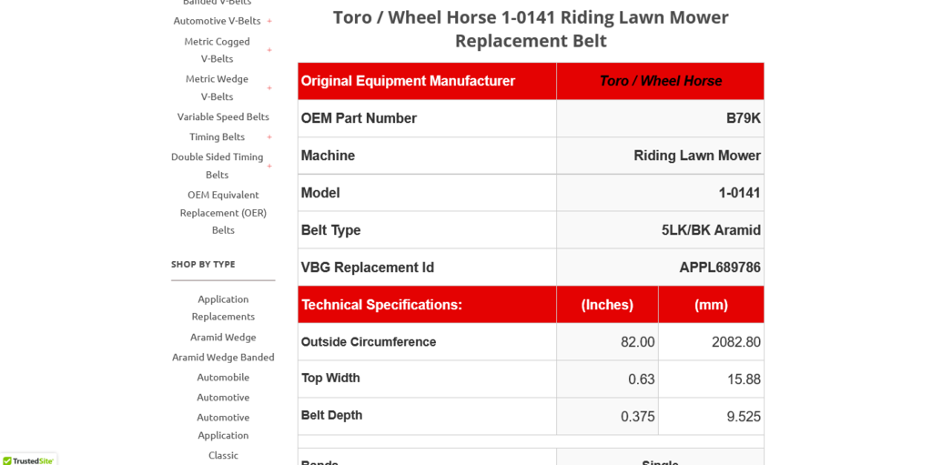

gwest_ca-(File Mod) 11,252 #13 Posted August 23, 2022 These may not be the exact model of deck you have but the belts should be the same. Rear discharge 36" deck Drive belt 102607 (1/2" x 89.12") when used on medium frame 43-1/2" wheelbase tractors 1975 B-80 4-Speed model 1-0141 Side discharge 36" deck Drive belt 102607 (1/2" x 89.12") when used on medium frame 43-1/2" wheelbase tractors 1975 B-80 4-Speed model 1-0141 Share this post Link to post Share on other sites
