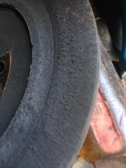

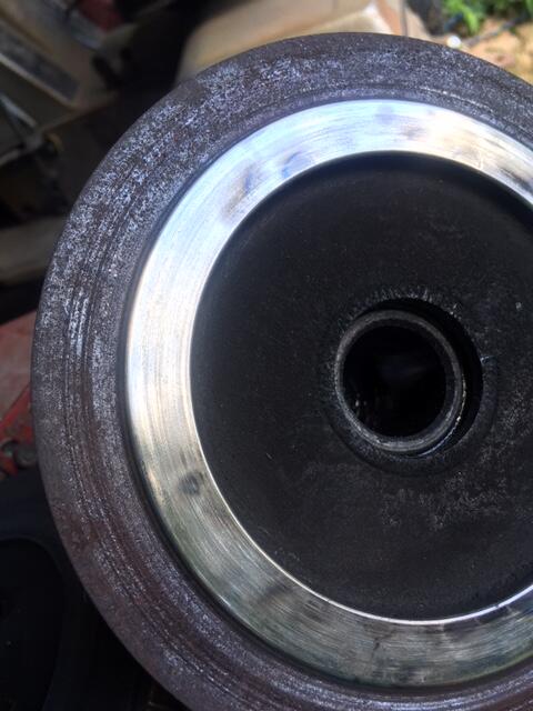

Bill Winn 157 #1 Posted August 22, 2022 Adding this here as I may have posted in the wrong place earlier (What Have You Done... ) So... I got the new tiller mounted and running. The issue is that when I engage the PTO and drop it into the soil it stops turning but the old K-series Kohler keeps running strong. I adjusted the PTO lever a bit tighter and when that did not solve the issue I removed the clutch assembly. Lookie what I found. I have ordered the clutch disc but I am guessing I need a clutch plate/ pully? Bill Share this post Link to post Share on other sites
ri702bill 8,991 #2 Posted August 22, 2022 Bill - maybe not. Probably easier to change it, but you may be able to have it refaced, like they do with automotive flywheels?? 1 Share this post Link to post Share on other sites
peter lena 9,092 #3 Posted August 22, 2022 @Bill Winn is that a needle bearing in there? looks like a total functional look see on that set up is needed . probably been failing for quite a while . verify every piece and how it functions . never had a clutch go , pete 1 1 Share this post Link to post Share on other sites
peter lena 9,092 #4 Posted August 22, 2022 @Bill Winn those needle bearings live in a very hot place , and often forgotten , lucas xtra hd chassis grease , green / white tube , 560 deg rated anti sling , polyurea rated , recommended , just enough grease to cover bearing , or it can sling to clutch face area , pete 1 1 Share this post Link to post Share on other sites
