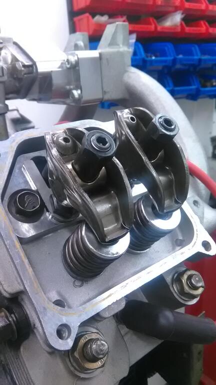

Tomato 32 #26 Posted January 28 Stock heads that have been ported and polished. Need to save my pennies and get some aftermarket heads. The cam is a Zack Kerber roller cam 1 Share this post Link to post Share on other sites
Tomato 32 #27 Posted January 28 2 hours ago, ebinmaine said: That is just awesome. Sounds like that was a great package and put together right. What do you use for cylinder heads? Special porting and polishing? Obviously that thing breathes exceedingly well. Stock heads that have been ported and polished. Need to save up for some aftermarket heads, gotta save my pennies. The cam is a Zack Kerber roller cam. 1 Share this post Link to post Share on other sites
Tomato 32 #28 Posted January 28 (edited) Really need to add the stock rocker stud pedestal has been milled off and heads now have 3/8 rocker studs. Also has roller rockers and good valve springs. Engine also has a Midwest Super Cub intake and a 1.2 gas carb. This has been an 8 year project increasing hp a little every year. The rockers in the pic was before the roller rockers were installed. Edited January 28 by Tomato Rocker arms have been changed 1 Share this post Link to post Share on other sites
