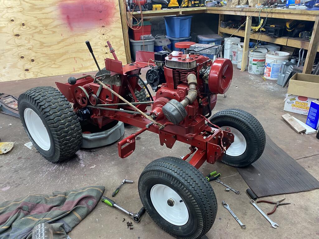

squonk 41,739 #2 Posted August 21, 2022 Does the tractor have the original engine? Pics would be helpful. 1 Share this post Link to post Share on other sites
wallfish 17,141 #3 Posted August 21, 2022 (edited) Since a 70" belt is the correct belt length for those tractors, the engine change to an 8hp Kohler changed something. Just add a longer belt if that's what it needs and will work with clutching Edited August 21, 2022 by wallfish Share this post Link to post Share on other sites
squonk 41,739 #4 Posted August 21, 2022 Why didn't I realize the 181 isn't original? 2 Share this post Link to post Share on other sites

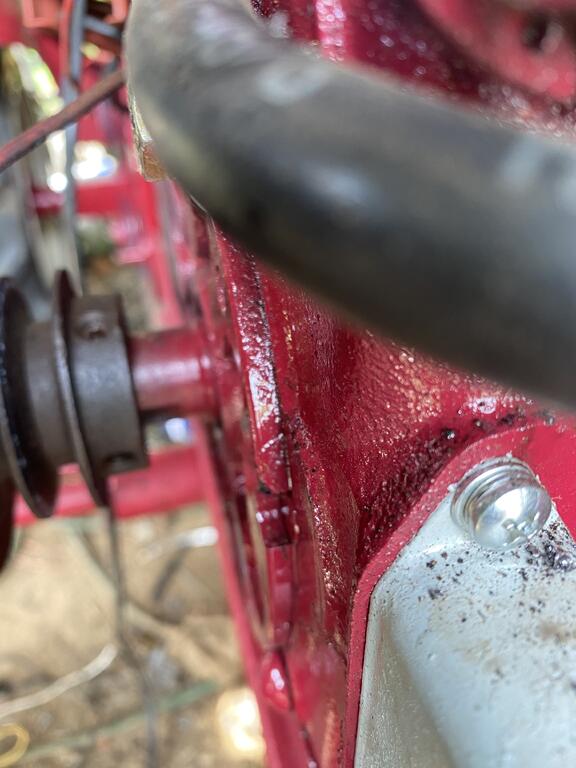

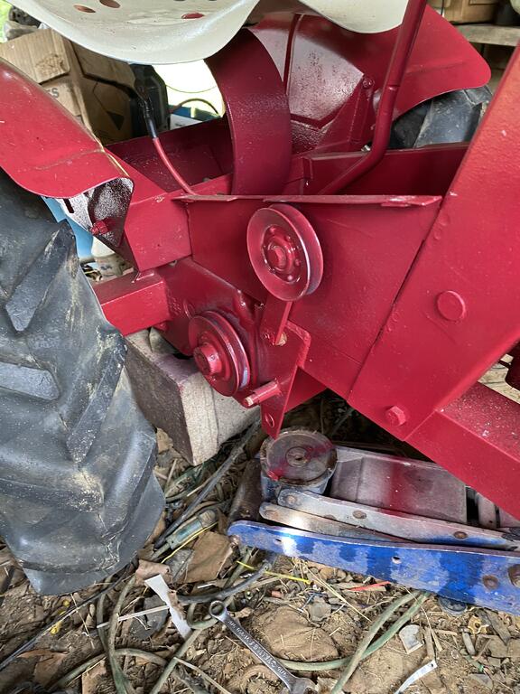

wallfish 17,141 #9 Posted August 21, 2022 You should turn that engine pulley around so the groove is tighter to the block and it will line up better with the others. That should give ya a little more. The frame F plate looks tight to the trans but make sure there aren't any repairs that space it out or that it's not cracked which is a common occurance Try loosening the engine bolts and slide it back as much as possible then tighten IDK if all of that is enough but something is a miss. The original Techumseh would've had an engine plate under it to raise the crank PTO shaft so the 8 hp Kohler bolted directly to the frame should put it exactly where that one was. 3 Share this post Link to post Share on other sites
DouglasParker 14 #10 Posted August 22, 2022 Just slapped engine pulley on for show in the picture I’m gonna get a longer belt tomorrow the 70” the pedal is all the way like it’s pushed in so my dilemma is do just 1” longer or jump to 2” longer that way the pedal will have alot of play, just not sure if 1” gives a lot, I don’t like the guessing game my 1276 all belts fit like they should my c120 and 520 all no problems just this thing smh and on a side note noticed the head gasket was leaking I thought no problem I have a extra gasket, head bolt by exhaust snaps off spent few hours dealing with that and then my gasket is for a k30 I give up for the week mess with it more next weekend. Share this post Link to post Share on other sites

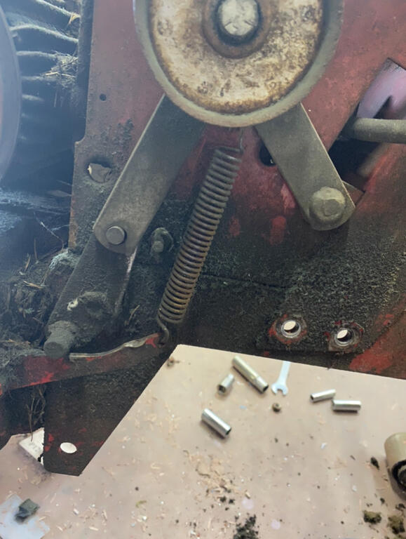

Thompson1276 256 #17 Posted August 23, 2022 18 hours ago, wallfish said: WH did not use 3/8" drive belts so yours should be a 1/2" wide belt for 1276. Maybe that's the problem you're having with it. Any damage to the pulleys can cause erratic shaking so that may be why it doesn't feel right to you. Hydros like yours don't use clutching or a pedal like the manual trans on this 502 does so technically you shouldn't feel much of anything. The tension idler or mechanism holes for the fasteners can get worn and allow for some shaking but going through it thoroughly to " tighten things up" and make any necessary repairs should take care of most of that. They do tend to vibrate the tensioner a little Mine used the parking brake spring tension as the tensioner to tension the belt as gown but yeah that’s the old belt the new one was about a good 4 -6 inches higher Share this post Link to post Share on other sites
953 nut 56,368 #18 Posted August 23, 2022 7 hours ago, Thompson1276 said: parking brake spring tension You have an automatic transmission, the one in question is a gear drive transmission, Wheel Horse didn't offer an automatic in 1962. Share this post Link to post Share on other sites
Thompson1276 256 #19 Posted August 23, 2022 1 hour ago, 953 nut said: You have an automatic transmission, the one in question is a gear drive transmission, Wheel Horse didn't offer an automatic in 1962. Hooks the same as my Sears that is a 6 Speed Split accept the tensioner is. Near the engine not transmission and upsidedown spring tension wise it tensions upwards Share this post Link to post Share on other sites
