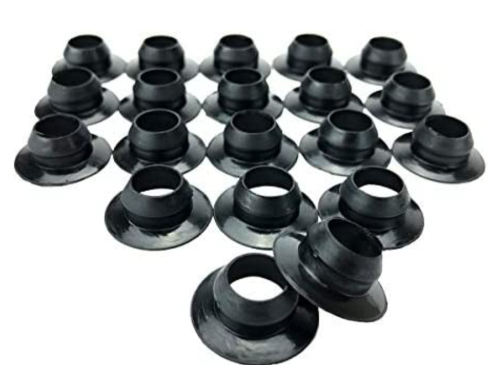

rmaynard 15,927 #8 Posted August 17, 2022 (edited) I have adapters to make the .410 fit in the .625 holes. I can send you a couple, but..... I'm on vacation in Florida and won't be home until Friday. These allow the smaller stems on tubes to fit larger holes in rims. They are not for tubeless tires. Edited August 18, 2022 by rmaynard 3 Share this post Link to post Share on other sites

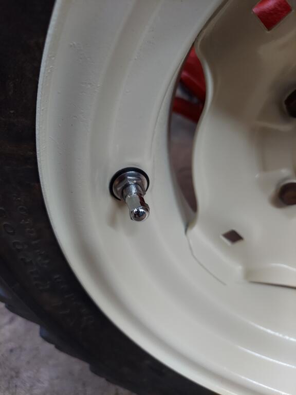

josephbruce11212@gmail.co 262 #15 Posted August 17, 2022 54 minutes ago, Snoopy11 said: P.S. @josephbruce11212@gmail.co... those valve stems that I posted above fit .453" and .625" rim holes... AND... to top it off... they look KILLER!!! Don Those are the ones I ordered....not holding air...hmmm Share this post Link to post Share on other sites

Ed Kennell 40,502 #17 Posted August 17, 2022 1 hour ago, josephbruce11212@gmail.co said: Those are the ones I ordered....not holding air...hmmm Should the rubber washer be on the inside? 3 1 1 Share this post Link to post Share on other sites
josephbruce11212@gmail.co 262 #18 Posted August 17, 2022 37 minutes ago, Ed Kennell said: Should the rubber washer be on the inside? It came with 2 different rubber washer dependent on hole size. I installed with the first washer correctly. It leaked, so I was hoping if I added the other sized washer under the nut washer it would aid and seal.....it did not. 1 Share this post Link to post Share on other sites
josephbruce11212@gmail.co 262 #19 Posted August 17, 2022 I'm pretty sure its the bead leaking and not the valve stem.... 1 Share this post Link to post Share on other sites
Snoopy11 5,717 #20 Posted August 17, 2022 40 minutes ago, josephbruce11212@gmail.co said: I'm pretty sure its the bead leaking and not the valve stem.... Yeah, I have used those things to death without issue... Don Share this post Link to post Share on other sites
Handy Don 13,340 #21 Posted August 17, 2022 (edited) 1 hour ago, Ed Kennell said: Should the rubber washer be on the inside? Should be steel and rubber washers on each side for that style, right? Spray some soapy water on the bead to see where it's coming out (or just throw the wheel and tire into the swimming pool). Edited August 17, 2022 by Handy Don 1 Share this post Link to post Share on other sites
Jeff-C175 7,203 #22 Posted August 17, 2022 1 hour ago, josephbruce11212@gmail.co said: I'm pretty sure its the bead leaking and not the valve stem.... You can always use soapy water to spot leaks! 3 Share this post Link to post Share on other sites
lynnmor 7,573 #23 Posted August 17, 2022 4 hours ago, josephbruce11212@gmail.co said: Those are the ones I ordered....not holding air...hmmm I use those on my travel trailer. They can easily be under or over tightened, it appears that you may have squashed the rubber too much. A bit of tire mounting lube on the rubbers allows them to better conform to the wheel. 1 Share this post Link to post Share on other sites
953 nut 57,980 #24 Posted August 17, 2022 2 hours ago, josephbruce11212@gmail.co said: I'm pretty sure its the bead leaking and not the valve stem.... 4 Share this post Link to post Share on other sites
josephbruce11212@gmail.co 262 #25 Posted August 17, 2022 4 minutes ago, 953 nut said: It should be possible to push the tires off the bead, clean with wire brush, bead sealer and fill, right? I'm not at all looking forward to having to remove the tires... if that is needed. Share this post Link to post Share on other sites
