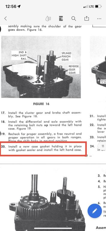

DeepH2O 66 #1 Posted August 15, 2022 Just got done rebuilding my 8 speed trans thanks to @stevasaurus Now, I’m ready to go back together with the case. The repair manual states “ Install a new case gasket holding it in place with gasket sealer…..”. Now, if I’ve cleaned the sealing surface really good, do I still need sealer? If so, what do y’all recommend? Also, what about sealer on the Kohler M12s cylinder head metal gasket? Share this post Link to post Share on other sites
stevasaurus 23,072 #2 Posted August 15, 2022 No sealer on the trans gasket and no sealer on the head gasket. 1 3 Share this post Link to post Share on other sites
rmaynard 15,927 #3 Posted August 15, 2022 53 minutes ago, stevasaurus said: No sealer on the trans gasket and no sealer on the head gasket. I agree. 1 Share this post Link to post Share on other sites
