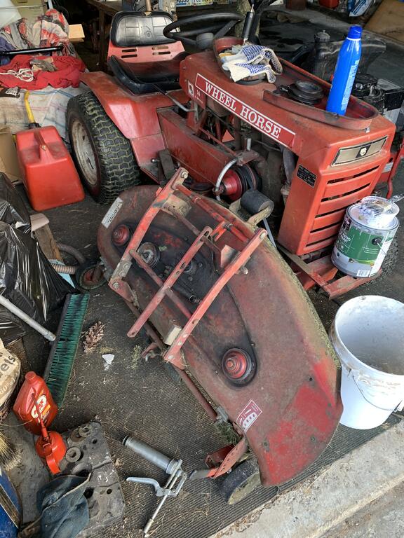

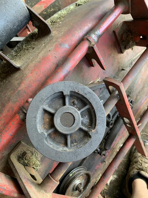

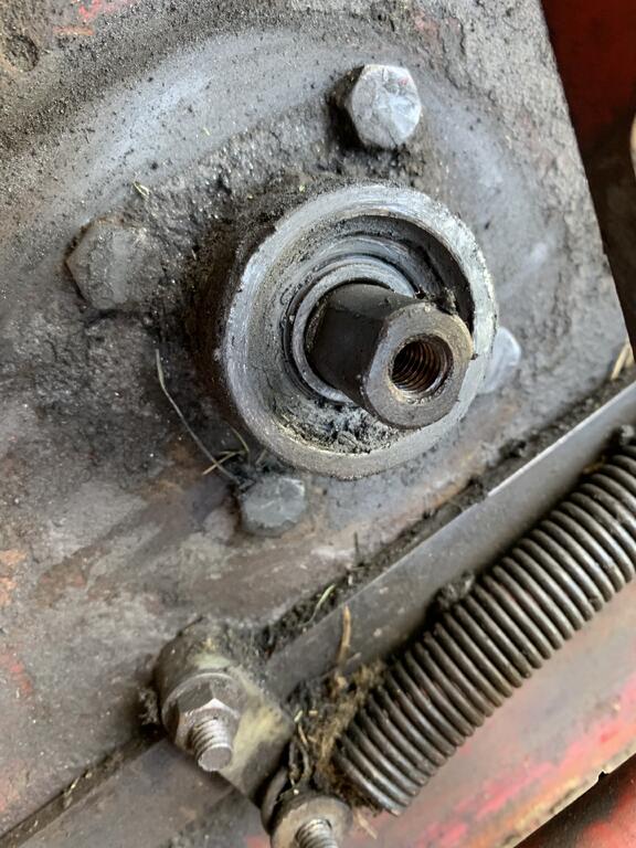

russellmc301 600 #1 Posted August 15, 2022 I have a wheel horse no name 14 that has a 42 inch deck. The center pulley seems to be missing something as the pulley is smooth and the shaft has square sides. Can someone please tell me what seems to be wrong? Share this post Link to post Share on other sites
gwest_ca-(File Mod) 11,158 #3 Posted August 15, 2022 Flat sided shaft known as 5/8" x 3/4" double-D Pulley should match 1 1 Share this post Link to post Share on other sites

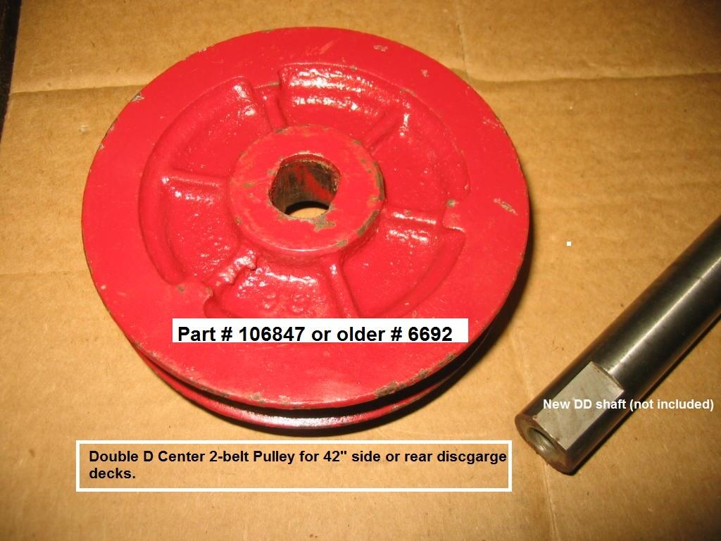

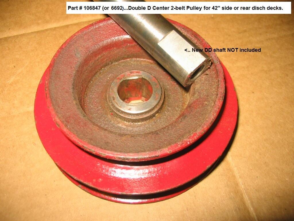

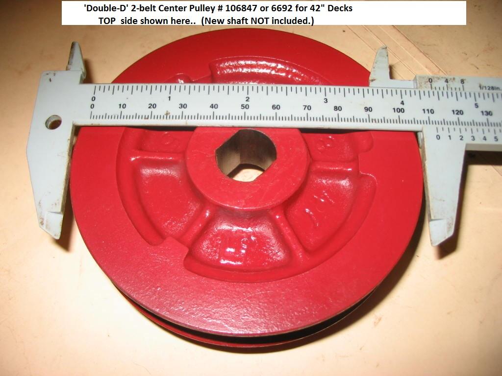

daveoman1966 3,762 #4 Posted August 15, 2022 You center pulley is partr # 106847. It should look like this...your is cimoletely wallowed out. 2 Share this post Link to post Share on other sites
