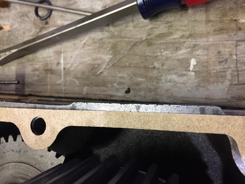

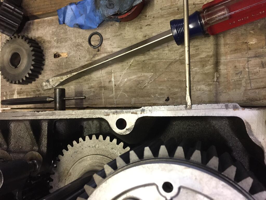

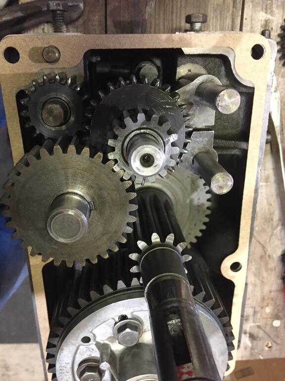

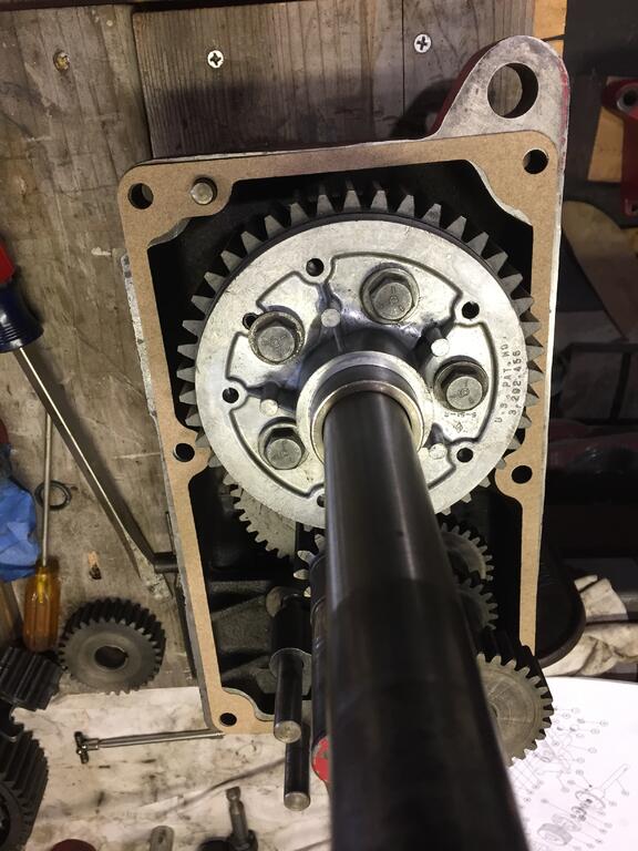

JimSraj 560 #57 Posted February 25, 2023 At long last I’m back on the 5060 trans work. Got the new bearings and seals in and all the gears back together. As I trial fit the case gasket I noticed what I think is a pretty poor cut on the one side. Check the attached photos. I’m thinking of trying to get gasket material at the local NAPA and cut my own. Anyone know what the material is and what thickness it should be. I bought 2 and they both fit about the same. The last picture shows a screwdriver pointing to a line I drew on the case. Gasket only covers about half of the mating surfaces. 1 Share this post Link to post Share on other sites
WHX?? 53,346 #58 Posted February 26, 2023 Last gasket i used was like that too. You can try soaking it in a pan of water it will expand abit. I used a little Permatex gasket maker. Share this post Link to post Share on other sites
stevasaurus 23,516 #59 Posted February 26, 2023 Those gaskets are fine as long as your surfaces are clean. If you want to cut your own...Autozone has the Kero-Pak. I think it is 1/32 thick by 1' X 3'.??? I could get 3 gaskets out of one package. Share this post Link to post Share on other sites
JimSraj 560 #60 Posted February 27, 2023 Thanks all. I just didn’t feel comfortable with the fit of the bought ones so I did cut my own with the Kero-pac. The bought gasket is 1/64” thick and the Kero-pac is 1/32” thick. I doubt(hope) it will matter. Anyway, it’s all back together and ready to go back to the tractor. That’s outside work so may not happen for a while. 2 1 Share this post Link to post Share on other sites
