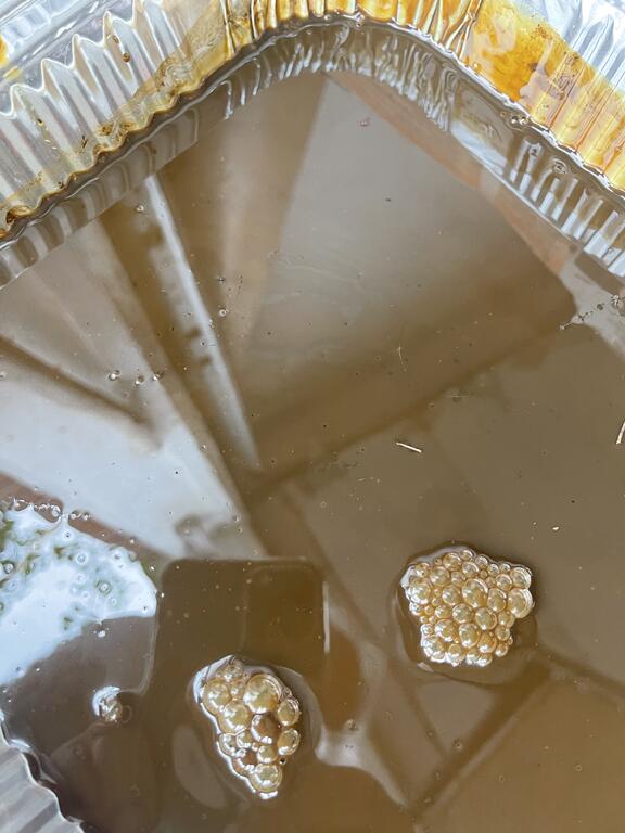

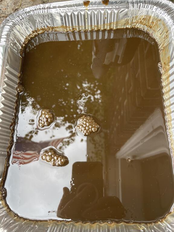

Willie 14 #1 Posted August 14, 2022 (edited) Wheel Horse restore manual transmission warning— If you’re like me, you are the original one owner of an old manual transmission horse and want to get it running again and stop when your allowance is all used up. Mine is a 1975 C120 8-Speed, I have an about new (1994) 42” mower deck and a 36” tiller I love and I’m going to use the both again. Among a hundred other things I let the transmission drain good tilting the tractor to get as much old fluid as possible. This is a picture of what came out. Top it off with new 85-140 gear oil and check transmission off, right? NO, WRONG, I WASN’T FINISHED. I took a plastic drink straw and poked around as best I could through the small check level hole to see if I could determine if everything was feeling good. IT WASN’T. There was about one to one and a half inches of heavy gunk in the transmission floor. I never changed the fluid while using the tractor per wheel horse recommendation, it has been parked in a garage for 20 years. Action I took. I put about 5 gallons of diesel fuel through the transmission exercising the gear box on each fill up until the diesel drained about clear. I did the straw test after each time I drained it, about 15. The gunk was completely undetectable when I finished. I’m also doing this diesel flush on my tiller gear box too. Refilling them with the prescribed gear lube. This problem would have eventually hurt my horse transition. WillieChaffin Edited August 14, 2022 by Willie 5 Share this post Link to post Share on other sites

Willie 14 #3 Posted August 14, 2022 The gunk would stick to the straw and required some pulling to get it out. The diesel finally cut it away. I put the tractor up on blocks and ran it in gear to slosh the diesel around. I was amazed at what kept coming out. Thanks. I’m just hoping this save someone transmission problems that can’t easily be fixed. 1 Share this post Link to post Share on other sites
