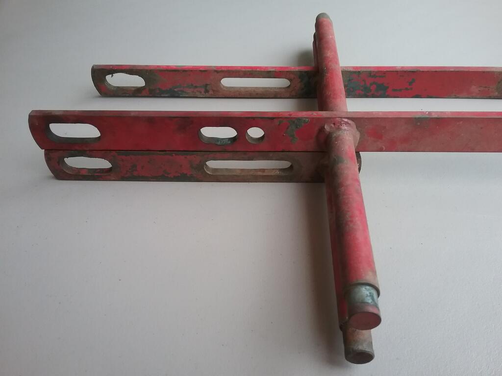

A quick look at the 48" lift bar revealed a nice long lifting slot.  Back to the Wheel Horse interchangeable parts theory.  The bar on the top of the stack is from the 42" deck, the bottom bar is from the 48" deck:
Looks like the solution!  But wait a minute!  The 'tail' on the lift bar that connects to the leveling linkage from the gage wheel shaft is not in the same place on the two decks.  OK, the famous Wheel Horse parts interchangeability does not apply to lift bars from these two decks.

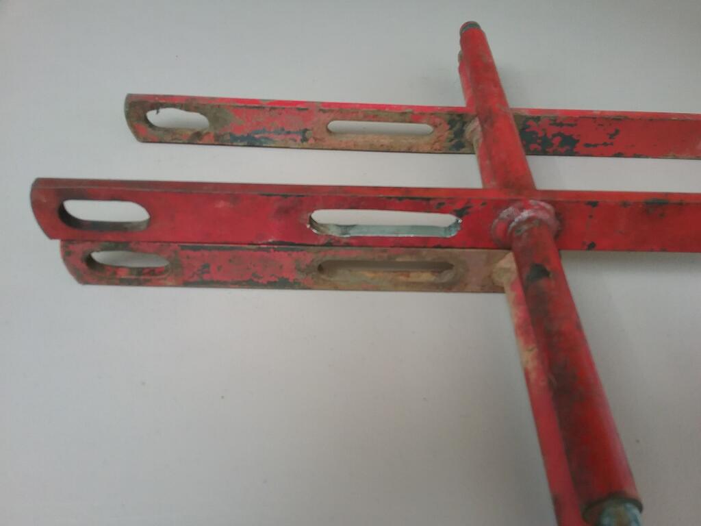

Time to go medieval on the lift bar from the 42" deck.  A bit of time spent with a tape measure, center punch, 1/2" drill, SawsAll, and a couple of hand files resulted in this:

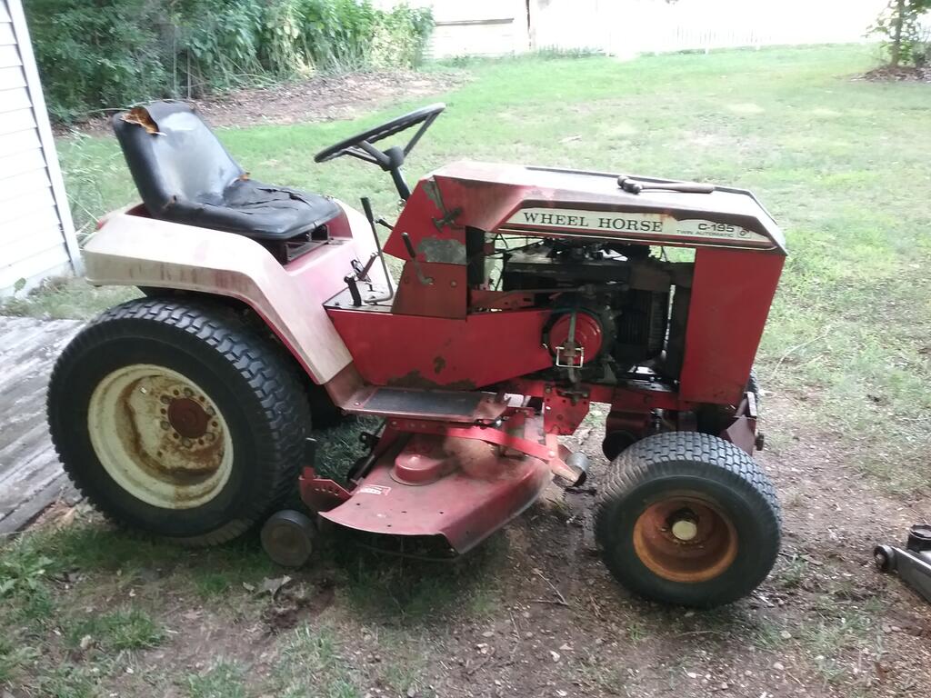

Again 42" lift bar on top, 48" lift bar on the bottom.  Reassemble the lift bar back on the deck, then a trial fit on the C-195:
Success!  A 99" by 1/2" belt works fine.  The only other minor item is that the gage wheels contact the rear tires and prevent the deck from getting to fully raised transport position.  I think that can be solved with the addition of 1" spacers behind the gage wheels.  I need to dig through my stash of miscellaneous materials to see if I have something suitable.  I'll add pictures when I figure something out here.
