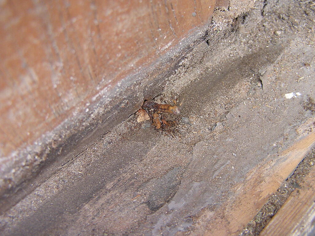

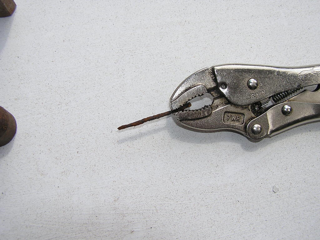

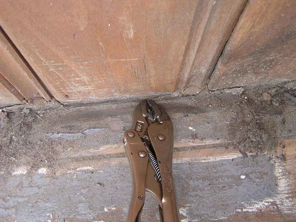

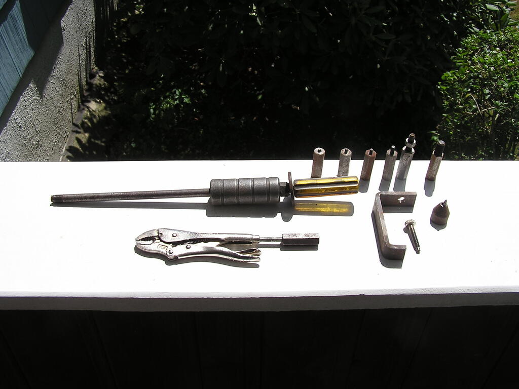

ri702bill 8,990 #1 Posted August 13, 2022 (edited) All: A while back, @peter lena posted an item about a small Slide Hammer. I replied, without pictures, that about 40 years ago, we used auto body dent puller slide hammers that we adapted to extract hollow pull dowels, a C shaped auto body tool, and a favorite - the marriage of a pair of locking pliers (aka Vise Grips) threaded onto the end of the slide hammer - VERY useful to extract woodruff and straight machine keys, and useful around the house to pull nails where the heads had rusted off and twisting them would break them off. Removed a 3/4 round molding on the porch I am refinishing - not all the nails played fair. Most of us probably have the 2 store bought items in our tool collections - just need to whip up the hex stock adapters.... Bill Edited August 13, 2022 by ri702bill 6 5 Share this post Link to post Share on other sites
formariz 11,994 #2 Posted August 14, 2022 That is a real great idea. Many times having to remove a large rusty nail in a restoration is a problem . Particularly so if it is an antique cut nail as most are. Cut nails really stick to wood new and when rusted they are nearly impossible to remove. The usual methods using leverage always wind up either damaging piece or breaking nail, may times both. This will knock it straight out leaving only the original hole and no other damage. Thank you for sharing it. 1 Share this post Link to post Share on other sites
ri702bill 8,990 #3 Posted August 14, 2022 2 hours ago, formariz said: That is a real great idea. Many times having to remove a large rusty nail in a restoration is a problem . Particularly so if it is an antique cut nail as most are. Cas - thanks for the comment - yup, also had a couple of OLD square cut nails that the heads were sticking up a tad in a joint - latched onto them and they popped right out. Funny, not too often our machinist and body tools get to work with something that had growth rings. We always tend to "steer" away and around them with the Horses....and other lawn equipment. Bill 1 Share this post Link to post Share on other sites
wallfish 17,498 #4 Posted August 14, 2022 That vice grip idea is a good one! 1 Share this post Link to post Share on other sites
ri702bill 8,990 #5 Posted August 14, 2022 7 minutes ago, wallfish said: That vice grip idea is a good one! It is, but I cannot take credit for the originality. As I said, WE all made these up to aid in threaded pull dowel and key removal. The idea came from a rather crusty, for lack of a better word, guy I worked with. He would gladly let you borrow it ONCE, if you asked a second time, he told you that since we BOTH need one, it's time for you to make your own... 1 1 2 Share this post Link to post Share on other sites
