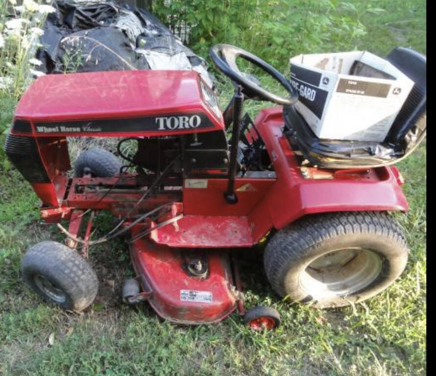

Evguy 556 #1 Posted August 13, 2022 I have a chance to pick up a 314-8 minus engine. Being newer to wheelhorse/ toro built tractors I was wondering if it’s worth the trouble. Input welcome 🙏 1 Share this post Link to post Share on other sites
Handy Don 13,340 #2 Posted August 13, 2022 A 314 roller in good condition and at the right price is a strong candidate for a re-power. This assumes you are interested in doing the work and want to have it running! Finding a 12-14hp engine should not be too difficult in your neck of the woods, if you decide to go ahead. Put an add in the site Classified/Wanted 1 Share this post Link to post Share on other sites

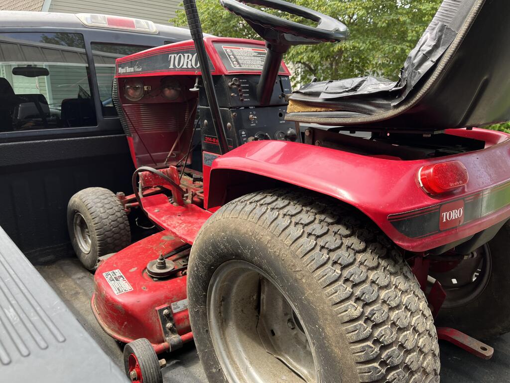

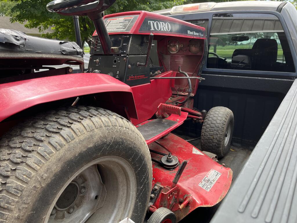

Evguy 556 #3 Posted August 13, 2022 It looks ok, going to need a seat and obviously an engine. I didn’t know if things got chintzy after toro acquired wheel horse. 1 Share this post Link to post Share on other sites
Handy Don 13,340 #4 Posted August 13, 2022 (edited) There were definitely changes, but Toro stuck with the original designs and quality pretty well. Running gear and transmission are the same as before. This one looks like it was well used (heavily worn front tires; crunched seat) but stored in shelter (little rust)--that's good. i suspect you might find more than the engine missing but it looks pretty complete. This model should have an hours meter which is mostly relevant for the engine but also indicates the amount of use overall. I'd want to know why the engine is gone. Also take a close look at the deck (top and bottom) for rust through or other damage like bent or chipped blades or a bent pulley and spin the blades to check the condition of the spindle bearings (assuming mowing is a use you are planning). Also check the deck lift operation. Edited August 13, 2022 by Handy Don 3 Share this post Link to post Share on other sites
Evguy 556 #5 Posted August 13, 2022 Seller states engine robbed to power something else. Also that all operated ok beforehand. I have a number in mind, I will see how motivated he is to sell. I have several mowers, but like the classic machines. All others are hydro. 1 1 Share this post Link to post Share on other sites

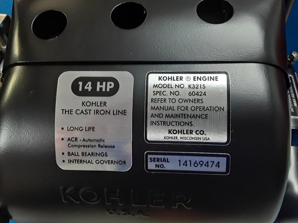

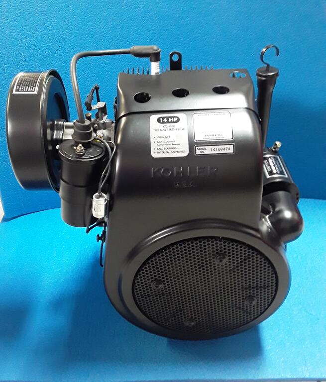

Handy Don 13,340 #10 Posted August 13, 2022 Supporting vendor posted this: 3 Share this post Link to post Share on other sites

76c12091520h 3,786 #18 Posted August 14, 2022 10 hours ago, Handy Don said: Supporting vendor posted this: This would fill in that empty space nicely..... 3 Share this post Link to post Share on other sites
Snoopy11 5,717 #19 Posted August 14, 2022 (edited) 14 hours ago, 76c12091520h said: This would fill in that empty space nicely..... Yeah, only problem is... we are in Indiana... and you are in PA... that's kinda stretching @Evguy's "range" (pun intended) Don Edited August 14, 2022 by Snoopy11 Share this post Link to post Share on other sites

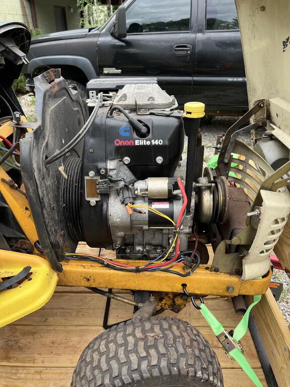

Evguy 556 #24 Posted August 15, 2022 I found a donor for the 314, it came with a cub cadet stuck to it. I’ll see how it works out and post in repower thread. 1 Share this post Link to post Share on other sites
953 nut 57,979 #25 Posted August 15, 2022 Looks like a good hefty candidate to get the job done. Not a direct bolt up but overcoming obstacles is half the fun of a project. 1 Share this post Link to post Share on other sites
