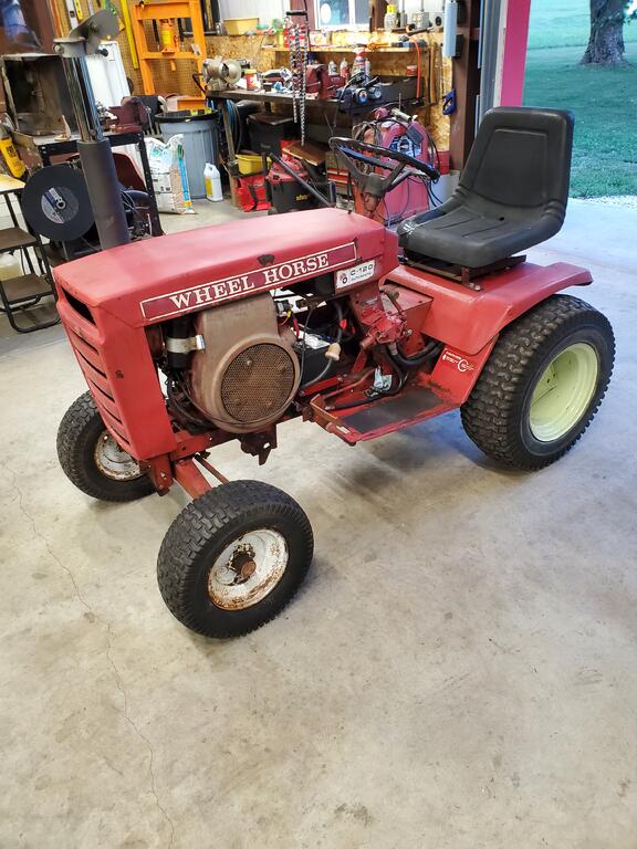

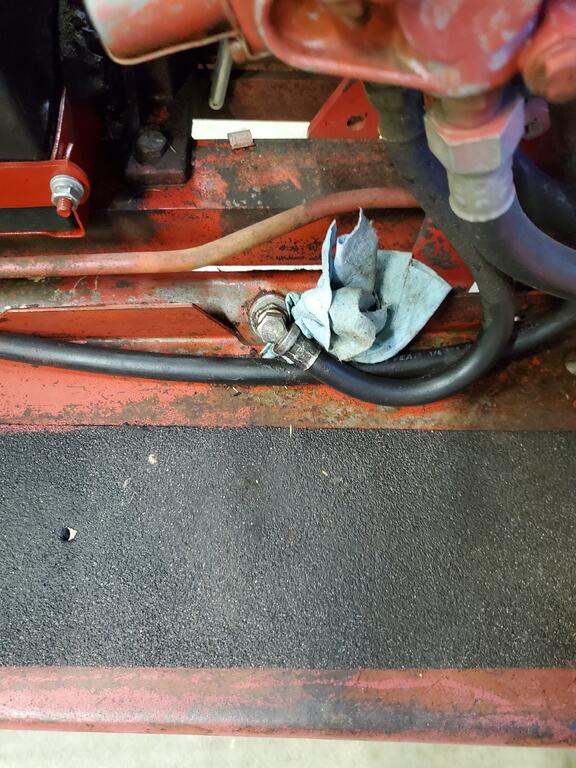

Moparfanforever 874 #1 Posted August 9, 2022 I picked up this neglected C120 and got it running really well and I got the hydro linkage working right, run it around and got it warmed up and put it front first on a pole, pushed it forward and to my surprise both back tires spun at the same time. Is this normal for this style of tractor?? The hydro seems to work good, but I haven't used it that much. I think the hydro filter was original. And this fitting by the blue rag is leaking, I think where it screws into the cylinder. Is there an oring in the fitting/cylinder to seal it?? Something special or just a simple oring ?? Thanks!!! 1 Share this post Link to post Share on other sites
ebinmaine 70,789 #2 Posted August 9, 2022 I don't think a hydro had Limited Slip from the factory after around 1971 or so... It's a fairly easy conversion to do so it's entirely possible somebody changed it over or had it done. Is it possible that when you did that test the friction between both tires was equally enough that they both spun...? On that leaking fitting, Lowell at Wheel Horse Parts and More could probably answer that and have the parts to help you out. 2 Share this post Link to post Share on other sites
Moparfanforever 874 #3 Posted August 9, 2022 Not sure about the friction being the same. I tried it twice in two different spots and both tires did the same thing. 3 Share this post Link to post Share on other sites
pfrederi 18,334 #4 Posted August 9, 2022 It should be an ORB SAE #5 fitting. Uses a Dash #905 o ring 2 Share this post Link to post Share on other sites
Achto 28,796 #5 Posted August 9, 2022 I had a Bronco 14 apart and it had a limited slip differential. 4 1 Share this post Link to post Share on other sites
ebinmaine 70,789 #6 Posted August 9, 2022 23 minutes ago, Achto said: I had a Bronco 14 apart and it had a limited slip differential. So that had to be a 1972 or older. I know the 8-speeds from 1974 up did not have LSD but I don't know about the Automatics. I can tell you my 1975 C160 Automatic does NOT have it. 1 Share this post Link to post Share on other sites
Moparfanforever 874 #7 Posted August 9, 2022 I put the tractor up against the pole three more times and it spun both tires two times and one tire once. I was asking about it because I am turning this into a snow fighter because of the hydro lift. LSD or not , I am going to put a blade on it. Put a new o ring in the fitting and that stopped the leak , but now it is leaking out of the little rubber dohicky at the end of the cylinder where the shaft goes thru. Time to order from Lowell. Thanks for the info pfrederi !! 2 Share this post Link to post Share on other sites
