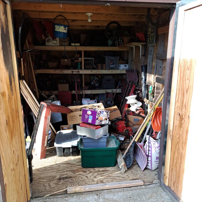

WHX?? 50,619 #28 Posted August 11, 2022 I don't think you thought wrong. Lemme go look on my parts shed Jim @Jiminoh I may have one. I parted out two 1055s once and only used one on a resto..... If I can find it.... @Achto hasn't gotten around to clean out the parts shed yet.. 2 Share this post Link to post Share on other sites

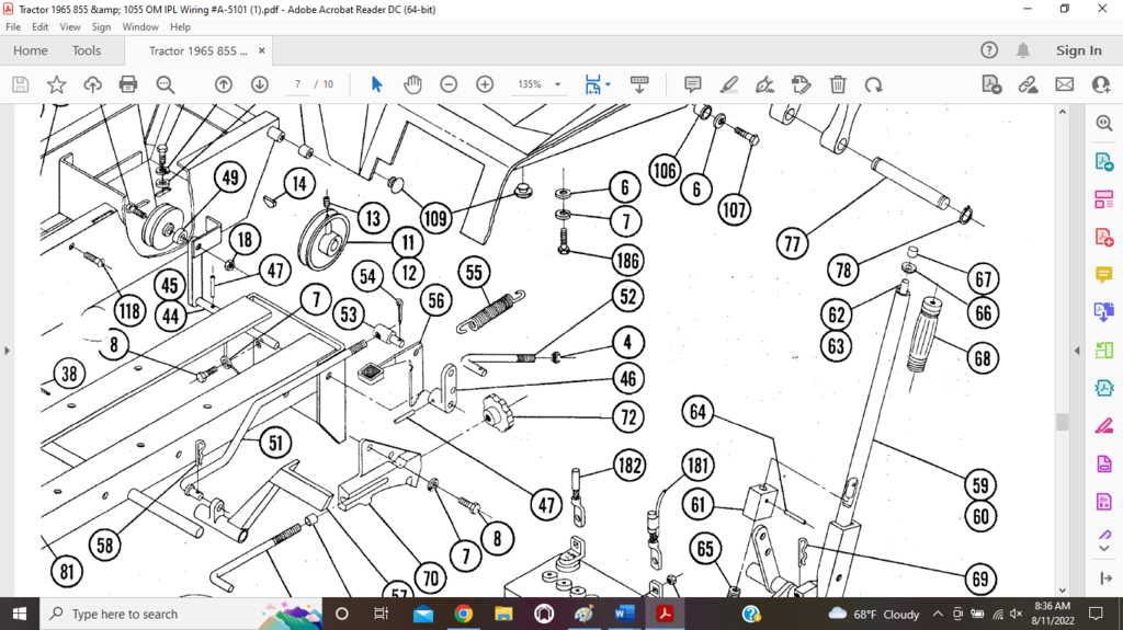

953 nut 57,754 #31 Posted August 11, 2022 Just for clarification please look at the attached drawing and think outside the box for a moment. If there is no way you can get the roll pin #47 out of arm #46 then you may want to consider buying the cross shaft #44 with arm #45 attached as well as arm #46. That way you can cut shaft #44, remove both halves and insert the replacement parts. Share this post Link to post Share on other sites
WHX?? 50,619 #32 Posted August 11, 2022 I'm goin in ...if I ain't out in an hour somebody notify my next of kin..... 1 1 6 Share this post Link to post Share on other sites

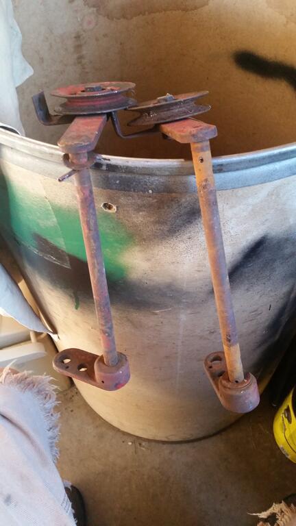

WHX?? 50,619 #33 Posted August 11, 2022 Ok made it out unscathed .... these have a PN of 4899 does that sound right? if so we hit the mother lode..... 1 2 Share this post Link to post Share on other sites

WHX?? 50,619 #35 Posted August 11, 2022 6 hours ago, 953 nut said: cut shaft #44, Wack away I got the whole nine yards.... 3 2 Share this post Link to post Share on other sites
Snoopy11 5,717 #36 Posted August 11, 2022 1 minute ago, WHX?? said: Wack away I got the whole nine yards.... Sorry Jim, I posted my "ebay" idea before I flipped to the next page and saw that you were risking your life and limb... Don Share this post Link to post Share on other sites

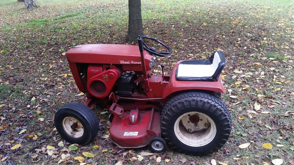

WHX?? 50,619 #37 Posted August 11, 2022 (edited) I PMed you Jim. I'll send the arm, shaft, pulley everything. Your choice of color.... patinaed or patinaed.... Be advised tho I may have to hold it ransome for of your project. We do like our 855s here. Picked this one up from @cschannuth last year. All original unmolested and runs like the day it was new. Then again what vintage model do we not like around here.... 1045 helping roast some corn. 🌽. Edited August 11, 2022 by WHX?? 3 3 Share this post Link to post Share on other sites

WHX?? 50,619 #41 Posted August 12, 2022 In the mail Jimbo.... let's not forget about dem der ! 4 2 1 Share this post Link to post Share on other sites

WHX?? 50,619 #43 Posted August 16, 2022 Looks good Mail man says your clutch parts should be there on Wednesday. 1 1 Share this post Link to post Share on other sites

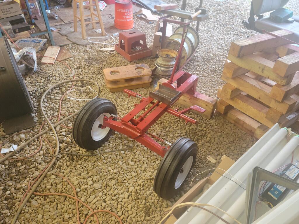

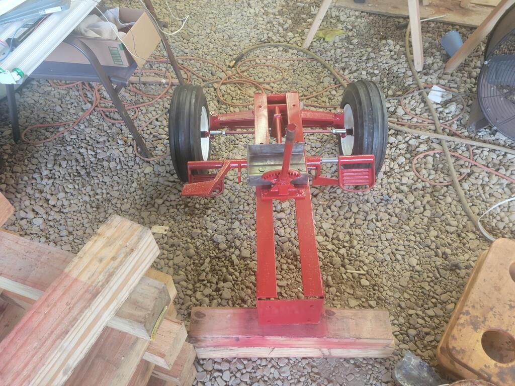

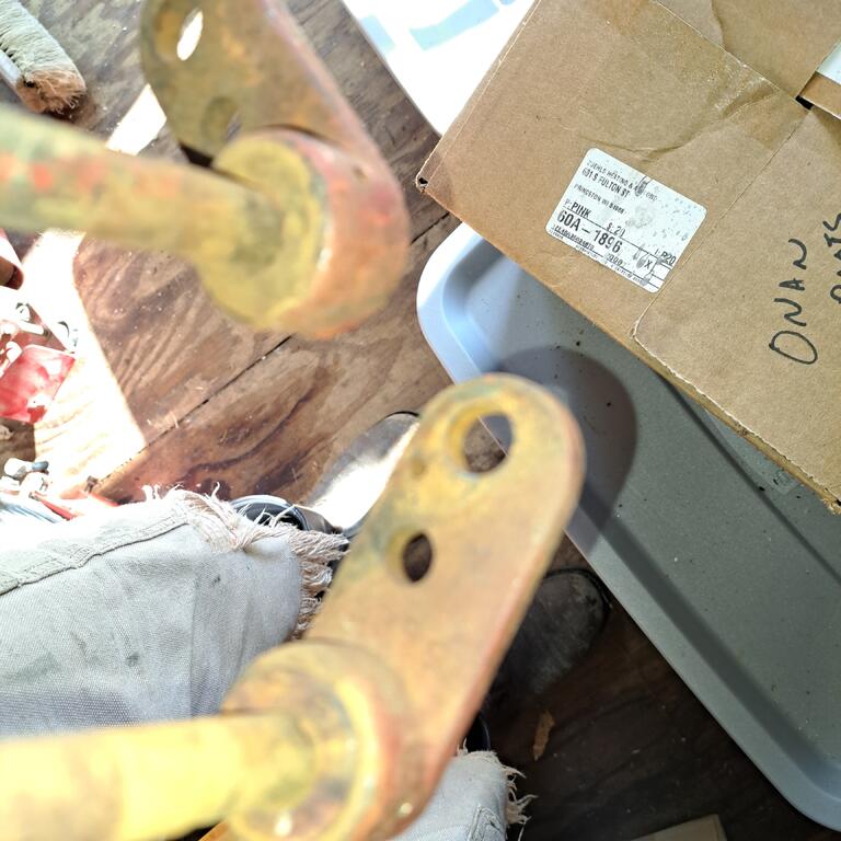

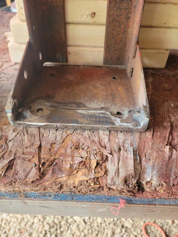

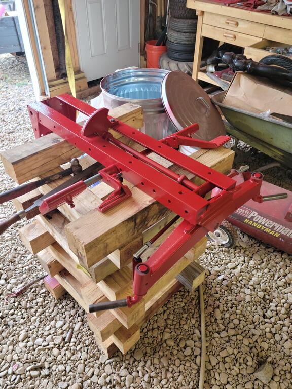

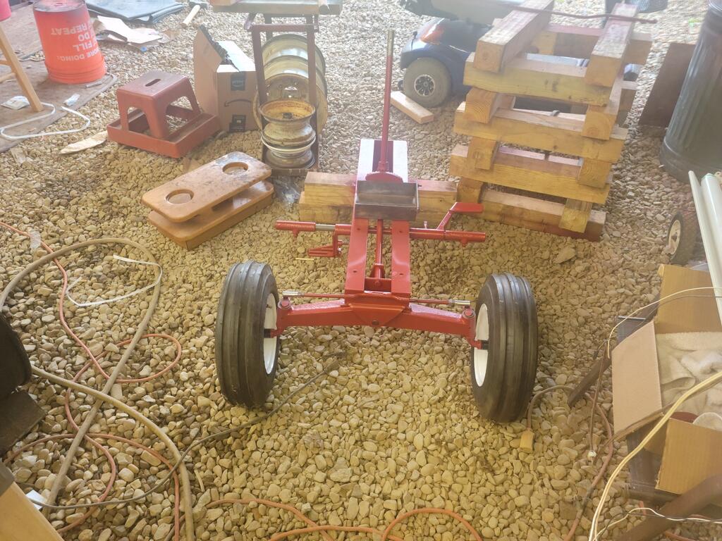

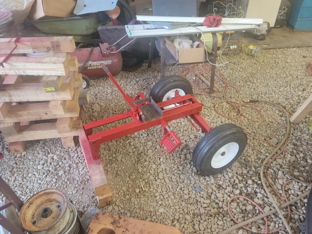

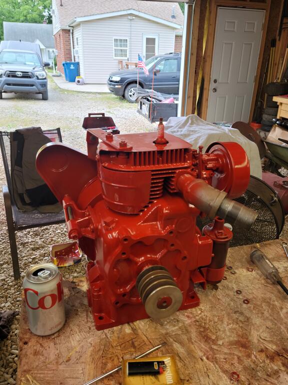

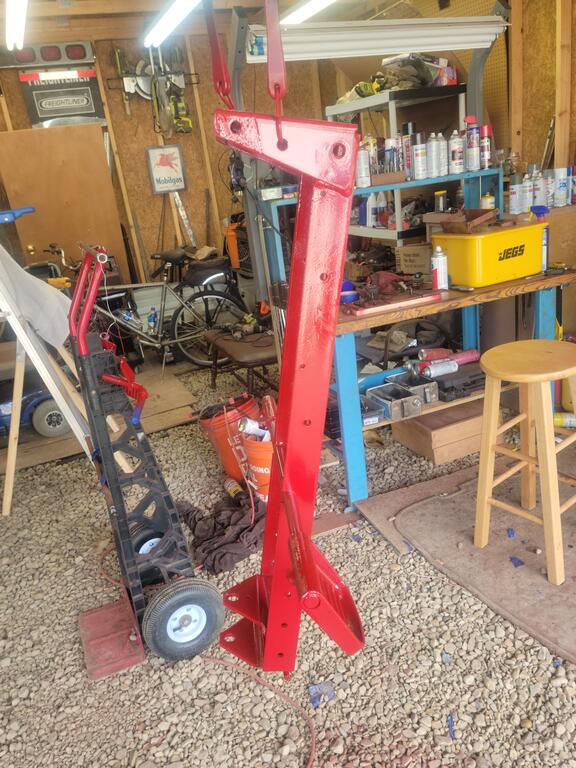

Jiminoh 27 #50 Posted September 1, 2022 I have some more pics of my 855 restoration 2 5 Share this post Link to post Share on other sites
