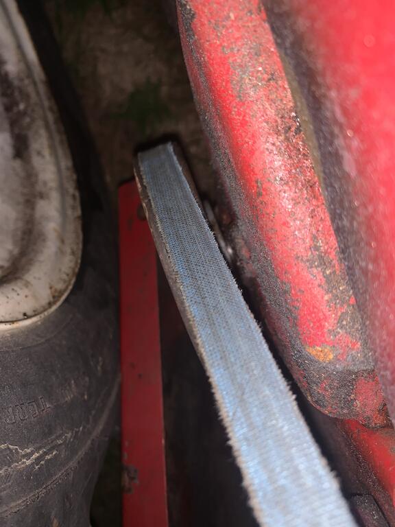

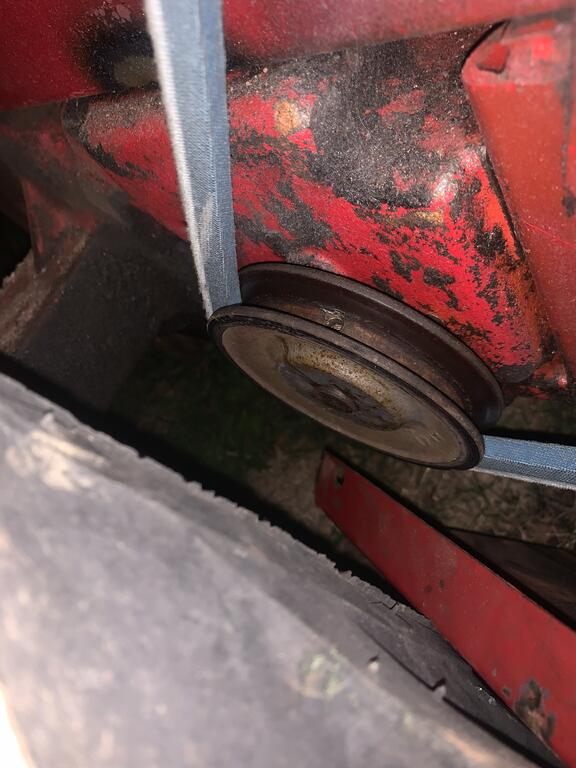

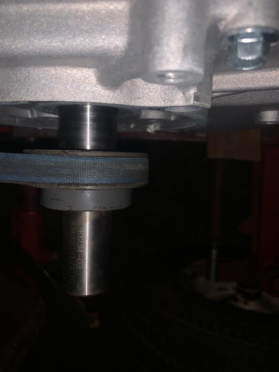

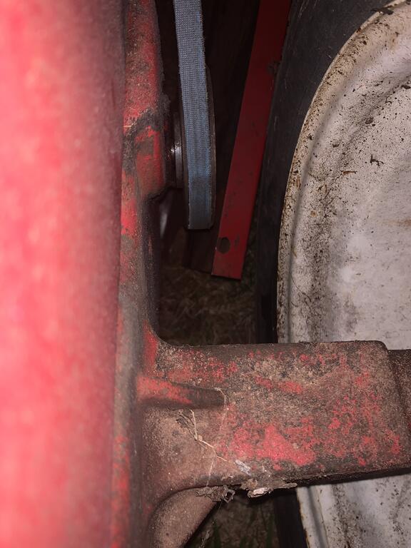

squonk 42,573 #9 Posted August 9, 2022 Let's have a close up of both pulleys with the belt on 2 Share this post Link to post Share on other sites
857lover 291 #10 Posted August 9, 2022 4 minutes ago, squonk said: Let's have a close up of both pulleys with the belt on Share this post Link to post Share on other sites
Pullstart 64,592 #11 Posted August 9, 2022 And both pulleys have keyways installed? 1 Share this post Link to post Share on other sites
Monstrosity 1,146 #12 Posted August 9, 2022 (edited) Slack in the idlers? Maybe not routed correctly does the cover have the belt tabs on it? Clutch adjustment needs more tension? (I don't have a geared tractor I have hydrostatic atm) Edited August 9, 2022 by Monstrosity Share this post Link to post Share on other sites
squonk 42,573 #13 Posted August 9, 2022 Non stock engine and engine pulley. Belt sitting deep in that pulley and bottoming out. Not enough oomph ( mechanical advantage ) from the engine end to move the tractor up hills. Case closed . 2 Share this post Link to post Share on other sites

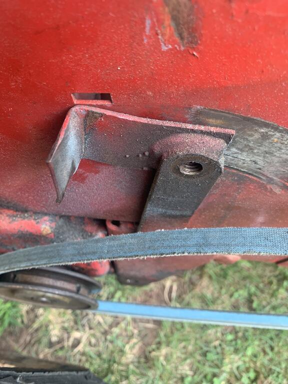

953 nut 57,979 #14 Posted August 9, 2022 11 hours ago, 857lover said: i took the belt shroud off and it works perfectly fine with it off Could be the arm on the idler pulley is catching in the belt guard not allowing it to make its full swing. 1 Share this post Link to post Share on other sites
squonk 42,573 #15 Posted August 9, 2022 (edited) 7 minutes ago, 953 nut said: Could be the arm on the idler pulley is catching in the belt guard not allowing it to make its full swing. Probably the way the guard is mounted on the non-stock engine. It's amazing how a story evolves from an 857 with an issue to one where it had modifications. Never get the whole story right off the get go. Belt has line up issues as well. Edited August 9, 2022 by squonk 3 Share this post Link to post Share on other sites

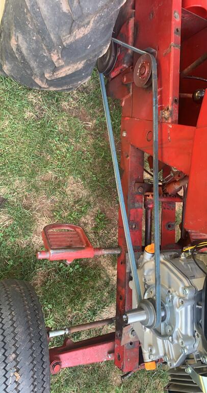

squonk 42,573 #17 Posted August 9, 2022 These are the pics you provided. Pulley wasn't stock. 1 Share this post Link to post Share on other sites
857lover 291 #18 Posted August 9, 2022 1 hour ago, squonk said: Probably the way the guard is mounted on the non-stock engine. It's amazing how a story evolves from an 857 with an issue to one where it had modifications. Never get the whole story right off the get go. Belt has line up issues as well. Share this post Link to post Share on other sites

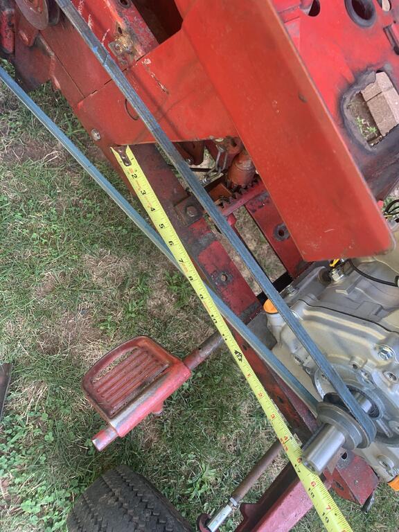

Pullstart 64,592 #19 Posted August 9, 2022 Try rotating the tab on your clutch idler forward so it grabs the belt when pressed but clears when it’s back. It looks to me like the engine is too far back too, so the belt guard isn’t as effective as a clutch. What is the measurement from the frame vertical to the engine crankshaft? 2 Share this post Link to post Share on other sites
857lover 291 #20 Posted August 9, 2022 7 minutes ago, Pullstart said: Try rotating the tab on your clutch idler forward so it grabs the belt when pressed but clears when it’s back. It looks to me like the engine is too far back too, so the belt guard isn’t as effective as a clutch. What is the measurement from the frame vertical to the engine crankshaft? if i’m measuring from the spot i think your referring too 17 inches Share this post Link to post Share on other sites
857lover 291 #21 Posted August 9, 2022 9 minutes ago, Pullstart said: Try rotating the tab on your clutch idler forward so it grabs the belt when pressed but clears when it’s back. It looks to me like the engine is too far back too, so the belt guard isn’t as effective as a clutch. What is the measurement from the frame vertical to the engine crankshaft? the tab is welded on Share this post Link to post Share on other sites

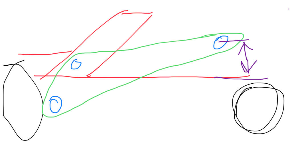

Pullstart 64,592 #22 Posted August 9, 2022 2 minutes ago, 857lover said: if i’m measuring from the spot i think your referring too 17 inches ok. Measure this way (purple). When mounting the new engine, for everything to work the best, the replacement crank needs to be in the same position height wise and length wise… then find a belt to fit. It looks like your belt is too long, allowing the idler to stop before it creates tension. Share this post Link to post Share on other sites
857lover 291 #23 Posted August 9, 2022 3 minutes ago, Pullstart said: ok. Measure this way (purple). When mounting the new engine, for everything to work the best, the replacement crank needs to be in the same position height wise and length wise… then find a belt to fit. It looks like your belt is too long, allowing the idler to stop before it creates tension. it’s 6 inches Share this post Link to post Share on other sites

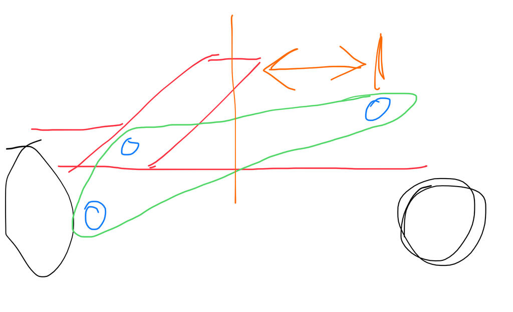

Pullstart 64,592 #24 Posted August 9, 2022 Also, using a square, measure from a known location (hole in the frame, mounting point of the sheet metal, etc.) to the crank in a horizontal direction. These two measurements should be exact as possible to the original engine. Share this post Link to post Share on other sites
Pullstart 64,592 #25 Posted August 9, 2022 Take a picture of where you measure from on the orange measurement and I’ll compare to a stock 857. 1 Share this post Link to post Share on other sites
