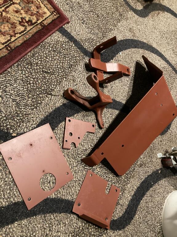

ineedanother 1,370 #34 Posted August 30, 2022 2 minutes ago, Andy N. said: How long did you have the wheel in the tank? And at what Volts and Amps? Overnight. 12v trickle charger, max 8A if I run it on boost which is a 15 minute cycle and then it backs off to 3A and stays cool so I'm comfortable leaving it unattended. I've run this tank pretty much around the clock for the past two weeks. I've changed the water twice and occasionally I'll unplug it and scrub the anodes with a long handled brush and let the rust settle to the bottom and then plug it back in. I'm just priming parts with oxide primer until I get the paint booth set up but here are a few of what I have with the primer curing. They are really manageable with brushing and lightly wet sanding, highly recommend doing this if you have rusted components. It's not a solvent but paint generally lifts right off, especially if it is on an older part: 2 1 Share this post Link to post Share on other sites
