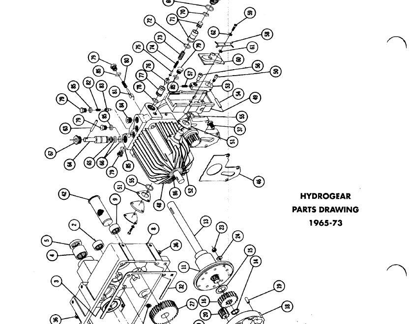

I’m looking but haven’t been able to ID the back up spring On the parts diagram.Page missing on description or I’m missing something here?
pfrederi
#73 and # 74  Are you sure about the hydro model #  90-2019   what tractor is it on...

I think that is not the original hydro.  Looks like 1973 12 Autos came in 2 versions. 1-0460 which had a hydro gear model 90-2046 and 1-0465 (yours) which had a piston to piston hydro model 90-1136.  Looking through all years WH I don't see WH ever used a model 90-2019.

The reverse acceleration valve is the one at the front of the transmission      :confusion-shrug:   The forward on is at the rear, go figure.
