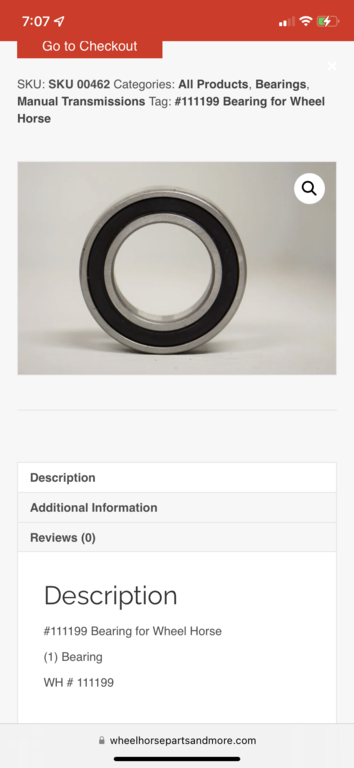

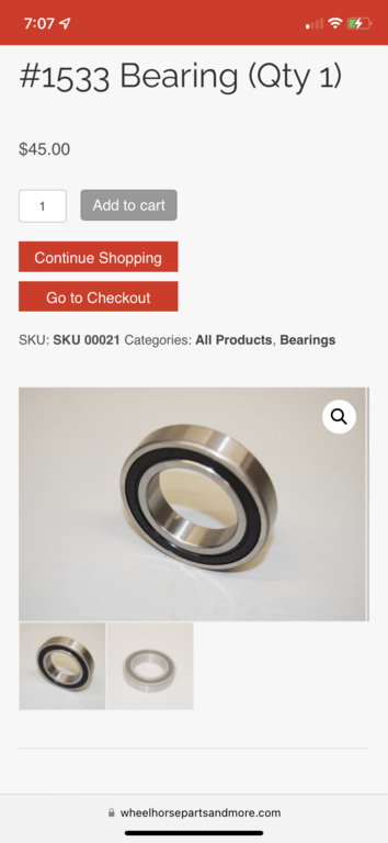

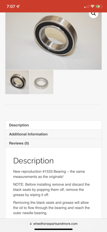

DeepH2O 66 #1 Posted August 1, 2022 So, after some investigation, I found that I needed the 111199 bearings instead of the 1533. I noticed on Lowell’s website, under description of the 1533 it says to take the black cover off them. Under description of 111199, it doesn’t say to remove it. I’m guessing that you’d want cover off for same reason as he explains under 1533: “NOTE: Before installing remove and discard the black seals by popping them off, remove the grease by wiping it off. Removing the black seals and grease will allow the oil to flow through the bearing and reach the outer needle bearing.” Does anyone see a reason not to remove the cover? Share this post Link to post Share on other sites

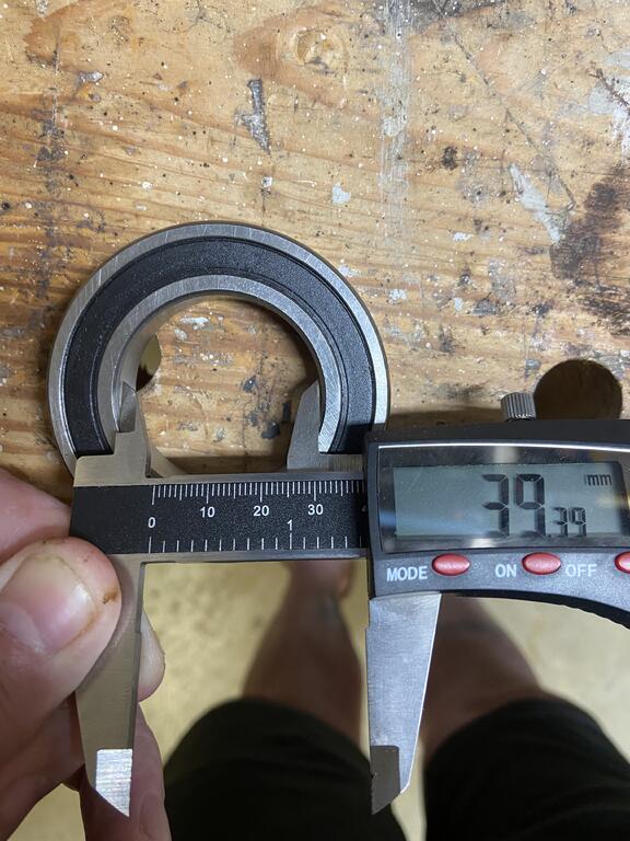

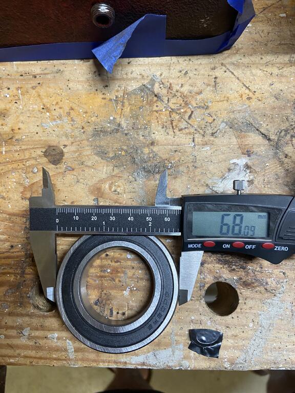

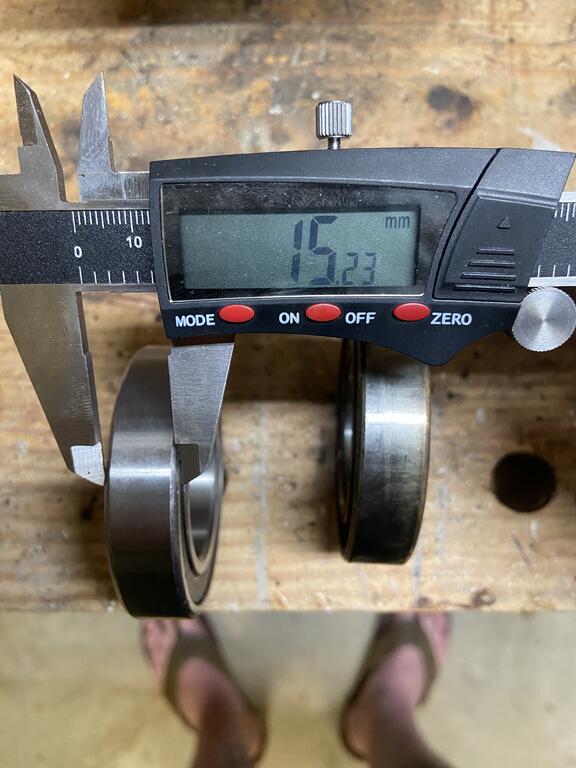

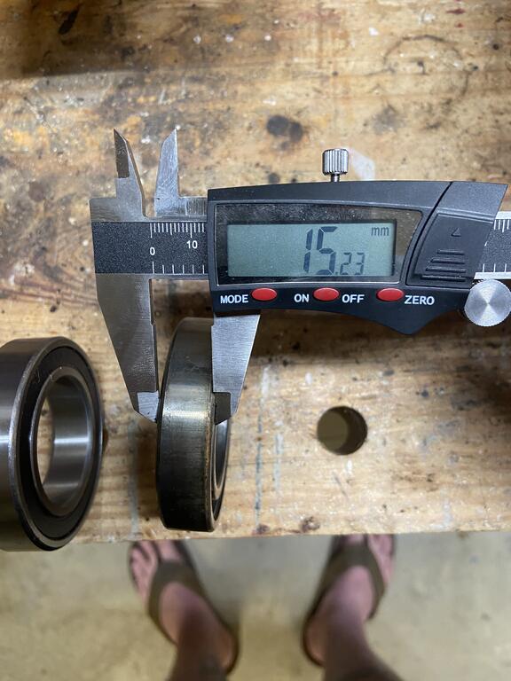

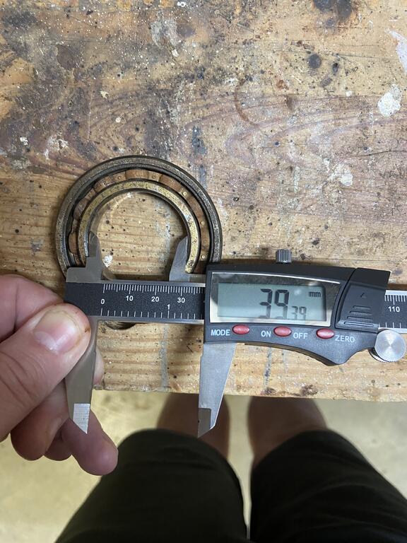

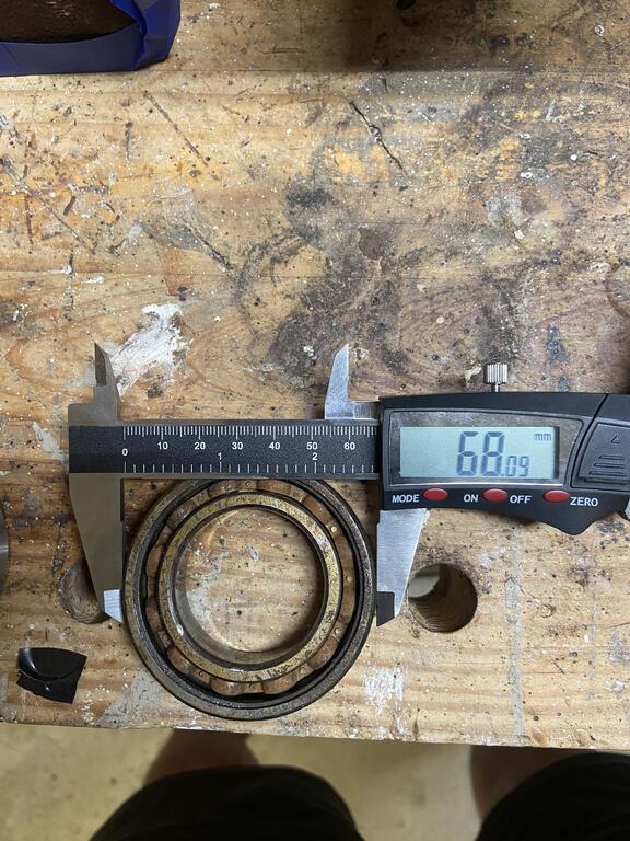

DeepH2O 66 #4 Posted August 1, 2022 They are correct. Here’s the side by side measurements from my old bearings and the 111199 1 1 Share this post Link to post Share on other sites
WHX?? 47,854 #5 Posted August 1, 2022 This has always been a long standing dilemma. Logic would dictate to take the seals out to get oil to the outside however many of the trannies I have been in have what they call shielded bearings. A metal seal rather than a rubber or plastic. Just guessing a shielded bearing weeps some oil thru and WH used them to protect the bearings from transmission gear wear metal. Again just a theory. All of the bearings I get from Lowell get both seals removed. 3 Share this post Link to post Share on other sites
DeepH2O 66 #6 Posted August 1, 2022 1 hour ago, WHX?? said: This has always been a long standing dilemma. Logic would dictate to take the seals out to get oil to the outside however many of the trannies I have been in have what they call shielded bearings. A metal seal rather than a rubber or plastic. Just guessing a shielded bearing weeps some oil thru and WH used them to protect the bearings from transmission gear wear metal. Again just a theory. All of the bearings I get from Lowell get both seals removed. I see your point! I will remove the seals. 1 Share this post Link to post Share on other sites
