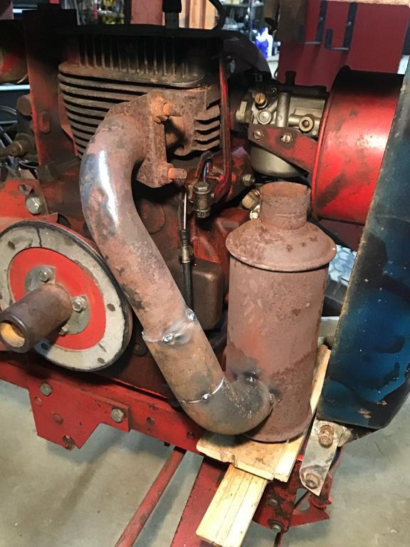

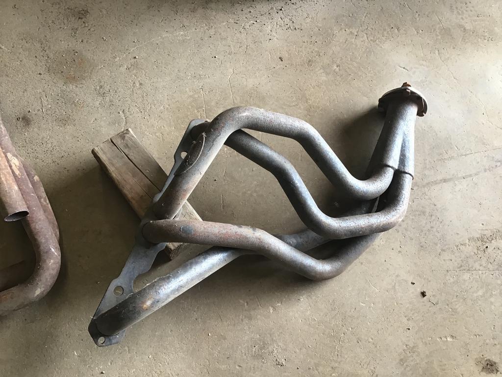

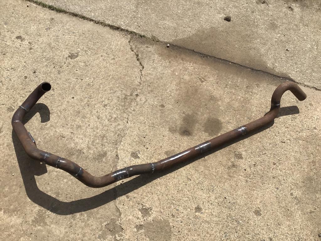

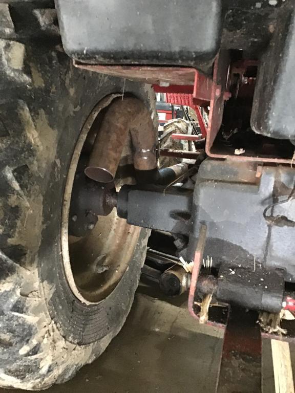

Pullstart 64,442 #2 Posted July 29, 2022 Are they proclaiming a power gain using their stuff? If not, I’ve built plenty of GT exhaust with old truck headers. They are 1-1/2” or 1-5/8” typically and have all kinds of fun random radius bends to choose from. 2 3 Share this post Link to post Share on other sites

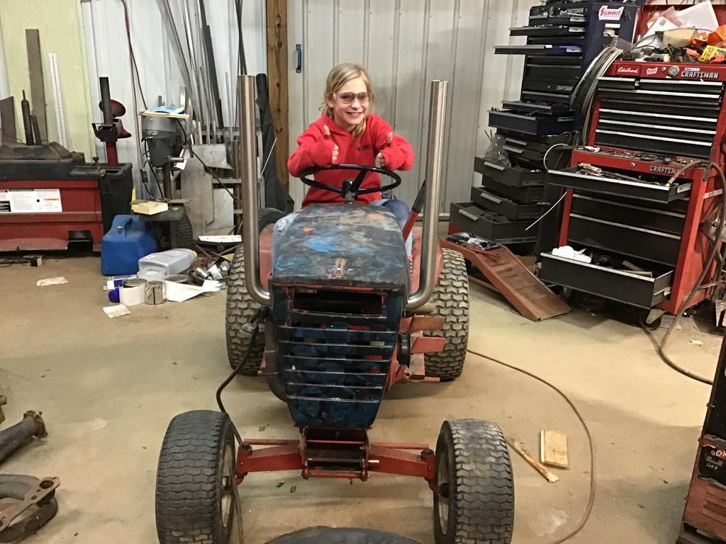

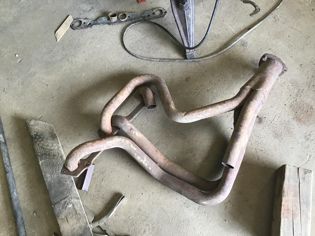

Pullstart 64,442 #3 Posted July 29, 2022 Some more examples… 2 2 3 Share this post Link to post Share on other sites
ri702bill 8,941 #4 Posted July 29, 2022 (edited) Great repurpose on the old exhaust parts. The last picture says it all - twin open stacks, two thumbs up, eye protection & a big grin. Good thing it was not a Yt video... might disturb the Video Po-Po....!! Edited July 29, 2022 by ri702bill 1 2 Share this post Link to post Share on other sites
Pullstart 64,442 #5 Posted July 29, 2022 6 minutes ago, ri702bill said: Good thing it was not a Yt video... might disturb the Video Po-Po....!! It was…. But I’ve taken it down. 1 2 Share this post Link to post Share on other sites
TonyToro 1,101 #6 Posted July 31, 2022 On 7/29/2022 at 10:54 AM, Pullstart said: Some more examples… This is so awesome!! Quality time that just can’t be replaced and she is learning so much! I really love the thoughts in repurposeing things! I just bought a trailer and it needed inner fenders really bad. I just replaced my washing machine and had the vision of cutting inner fenders out of it. A few minutes with a tape measure and cut off wheel and I had inner fenders. I think they are thinker gage then the originals. 1 Share this post Link to post Share on other sites

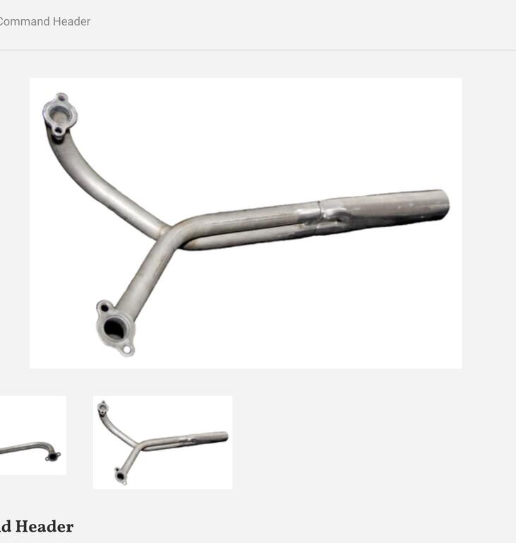

TonyToro 1,101 #8 Posted July 31, 2022 (edited) This is the pipe most guys run and add sections to it when they are on the dyno. 6382A32C-839F-4559-A621-12E58B67D4DC.webp Edited July 31, 2022 by TonyToro Share this post Link to post Share on other sites
Pullstart 64,442 #9 Posted July 31, 2022 Honestly that doesn’t look that hard to build if you have a welder and a hammer.. 1 Share this post Link to post Share on other sites
TonyToro 1,101 #10 Posted August 1, 2022 3 hours ago, Pullstart said: Honestly that doesn’t look that hard to build if you have a welder and a hammer.. I agree , it doesn’t look all that difficult to make. I would think a tig weld would be best. I have a Lincoln mig welder and I’m pretty decent at sticking metal together. The thing I’d be concerned about is getting everything matted up so there isn’t any restrictions on the inside. In this sport every small detail in horsepower gain is important. Share this post Link to post Share on other sites
sjoemie himself 3,072 #11 Posted August 1, 2022 Here I would like to quote the great T. Fixes All "it's not the space shuttle, it's a lawn mower" If you have a MIG welder and you're pretty decent at sticking metal together you'll be fine using it instead of TIG. If you set up your machine just right you'll get good penetration without creating stalagtites on the inside. If you start at the engine and work your way out to the header and place langer pipes OVER the smaller previous one, looking from the header 'out' so to speak, you will have no restrictions or bottlenecks. Greetings from the Netherlands, Mark 3 Share this post Link to post Share on other sites

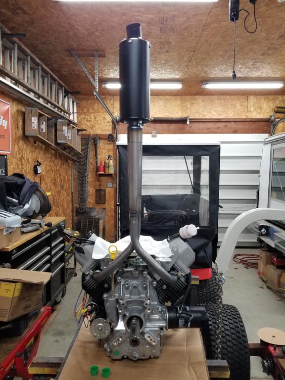

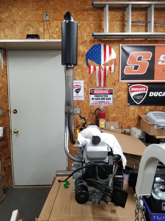

Wild Bill 633 866 #12 Posted August 1, 2022 (edited) Kohler Command CH740/CH25 w/ MWSC 1-1/8" Header and Joes' Racing Products 10" muffler w/ 2" adapter. Picture taken prior to Jet-Hot ceramic coating the header and muffler adapter. Edited August 1, 2022 by Bill633 2 2 Share this post Link to post Share on other sites
TonyToro 1,101 #13 Posted August 1, 2022 8 hours ago, sjoemie himself said: Here I would like to quote the great T. Fixes All "it's not the space shuttle, it's a lawn mower" If you have a MIG welder and you're pretty decent at sticking metal together you'll be fine using it instead of TIG. If you set up your machine just right you'll get good penetration without creating stalagtites on the inside. If you start at the engine and work your way out to the header and place langer pipes OVER the smaller previous one, looking from the header 'out' so to speak, you will have no restrictions or bottlenecks. Greetings from the Netherlands, Mark Taryl is the BEST!! My son got me into watching him. 1 Share this post Link to post Share on other sites
TonyToro 1,101 #14 Posted August 1, 2022 4 hours ago, Bill633 said: Kohler Command CH740/CH25 w/ MWSC 1-1/8" Header and Joes' Racing Products 10" muffler w/ 2" adapter. Picture taken prior to Jet-Hot ceramic coating the header and muffler adapter. Very nice!! That’s the one we are looking at. Did you order right off the shelf or have them custom make it? we usually wrap our exhaust but I was thinking the same as you’ve done with the ceramic powder coating. Share this post Link to post Share on other sites

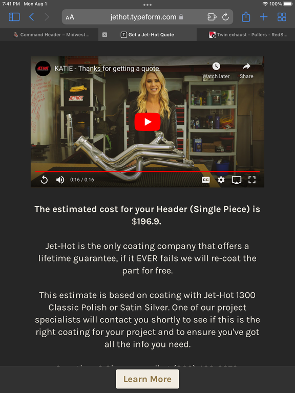

Wild Bill 633 866 #15 Posted August 1, 2022 4 hours ago, TonyToro said: Did you order right off the shelf or have them custom make it? The 1-1/8" exhaust header is Midwest Super Cub P/N 51440. They also have a 1-1/4" header, P/N 51444. The racing muffler is Joe's P/N 22801. Make sure you are sitting down when you get the quote from Jet-Hot. 1 2 Share this post Link to post Share on other sites
TonyToro 1,101 #16 Posted August 1, 2022 1 hour ago, Bill633 said: The 1-1/8" exhaust header is Midwest Super Cub P/N 51440. They also have a 1-1/4" header, P/N 51444. The racing muffler is Joe's P/N 22801. Make sure you are sitting down when you get the quote from Jet-Hot. When I came home from work my son was waiting ready to buy all the items in his MWSC shopping cart. We ended up ordering the 1 1/8” exhaust and a few hundred dollars of other “necessary” parts. 😂👍 1 Share this post Link to post Share on other sites
TonyToro 1,101 #17 Posted August 1, 2022 1 hour ago, Bill633 said: The 1-1/8" exhaust header is Midwest Super Cub P/N 51440. They also have a 1-1/4" header, P/N 51444. The racing muffler is Joe's P/N 22801. Make sure you are sitting down when you get the quote from Jet-Hot. Katie just sent me a quote! 👍 1 Share this post Link to post Share on other sites
