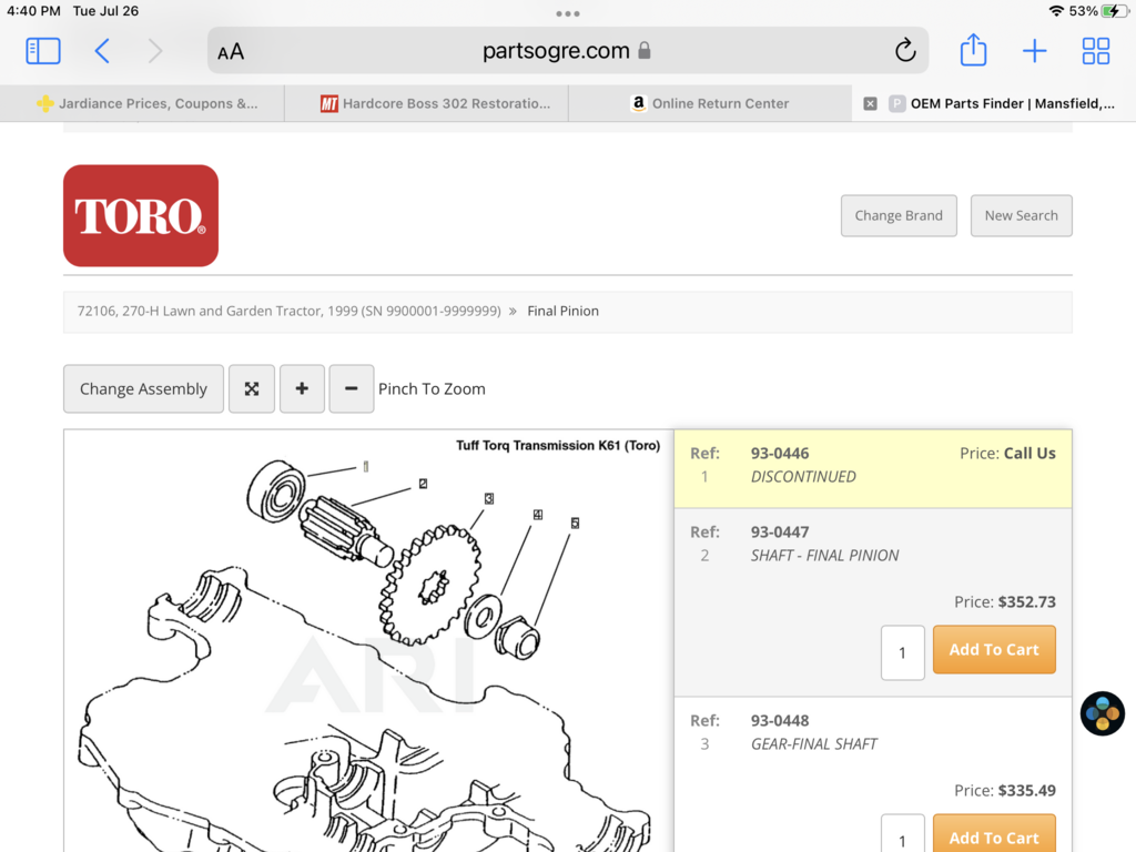

I recently posted about issues with my transmission and have now identified the issue.   I removed the transmission cover and found that the final pinion bearing had failed.   Bearings and race in bottom of cover.   Now need to find replacement bearing and also a new filter.   Bearing part number from Toro is 93-0446 and is stamped with “Japan Nachi 6203”.  The gasket is Toro # 93-0478.   Any help verifying these part numbers for a TORO 270H model 72106 and also locating replacement parts or equivalents would be greatly appreciated.  My transmission serial number is 049132.  Thank you!

The 6203 bearing is easy - likely the same in the mower deck spindles.

thanks for the information.  This bearing is not sealed and is submerged in the transmission hydraulic fluid.   I was told by a friend to use a synthetic fluid when I rebuild it which I will likely do.   I’m now looking for the filter for my K61A transmission.   There are a few online from various vendors but not positive they will fit.   Do you have any recommendations?
