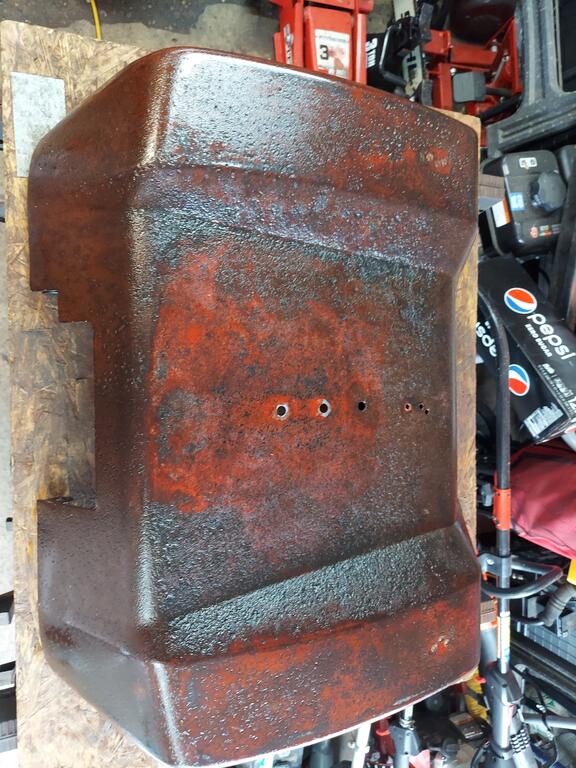

josephbruce11212@gmail.co 262 #94 Posted July 28, 2022 rainy days... 2 Share this post Link to post Share on other sites

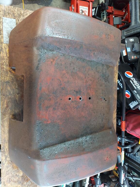

josephbruce11212@gmail.co 262 #95 Posted July 28, 2022 2 Share this post Link to post Share on other sites
josephbruce11212@gmail.co 262 #96 Posted July 28, 2022 Didn't turn out to bad, too bad the under wasn't the top!! (Linseed oiled rags are soaking in water bucket) 3 4 Share this post Link to post Share on other sites
The Freightliner Guy 1,335 #97 Posted July 28, 2022 Looking great 1 Share this post Link to post Share on other sites
ebinmaine 70,269 #98 Posted July 28, 2022 1 hour ago, josephbruce11212@gmail.co said: Didn't turn out to bad, too bad the under wasn't the top!! (Linseed oiled rags are soaking in water bucket) If you get bored, stop up to my place. I've ONLY got three tractors that could use this type of attention. 2 Share this post Link to post Share on other sites

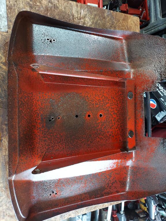

josephbruce11212@gmail.co 262 #99 Posted July 28, 2022 Removed all this junk! 2 Share this post Link to post Share on other sites
Handy Don 13,232 #100 Posted July 28, 2022 Course now that it's all oiled up, you can't drive around wearing your "Sunday go to meetin' clothes" any more 'til you get a real seat. 2 Share this post Link to post Share on other sites
