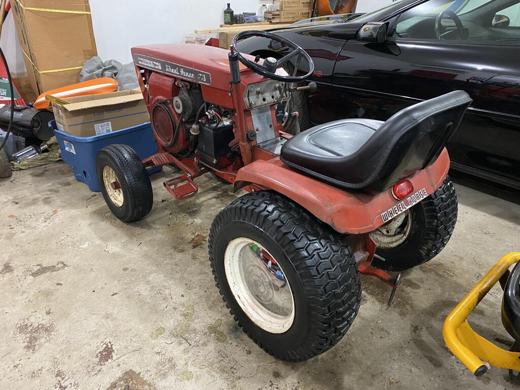

Thompson1276 257 #1 Posted July 20, 2022 I have a 1966 wheel horse 1276 im restoring and going to teardown and it needs the oil and filter replaced I have the filter on the way but the oil in it now is like automatic transmission fluid already it’s half full since I had it I’d had had automatic transmission fluid in it probably since 1990 since it sat for a good 20 years , but the web says to use …Engine Oil? In a Transmission should I use the engine oil and change the damn oil every season I barely drive it but it’s my main tractor I got engine oil for a year in it , because I don’t feel like spending 50 or more on oil and finding a oem filter to get that changed every season or does that not matter and if not will just regular automatic transmission fluid like what’s in it good for it still I never had a problem with it but it’s going to be 60 years old in a few year not many and only 800 models was made and was made for one year I really don’t wanna blow the transmission out of it Share this post Link to post Share on other sites
