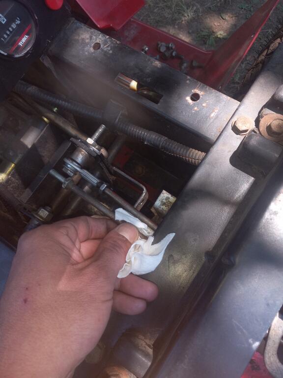

I have a factory replica foot control from @drjarvisphd121and I have tried and failed to adjust the neutral creep...
Today I finally figured out WHY!
Notice in the picture where the little motion rod (part #108904) is over an inch longer?
I had picked up a replacement rod and bearing ends at the Show from AZ tractor cuz mine were a little worn...
Sometimes I can't leave well enough alone!
I didn't know that there were different lengths.  I figured the controls on all Eaton 1100s were the same. I guess I'm wrong.
No wonder I was so confused lol!
Yep, those "look the same but are subtly different" parts can really bite you! :lol: Been there and done it. Glad you found it!
