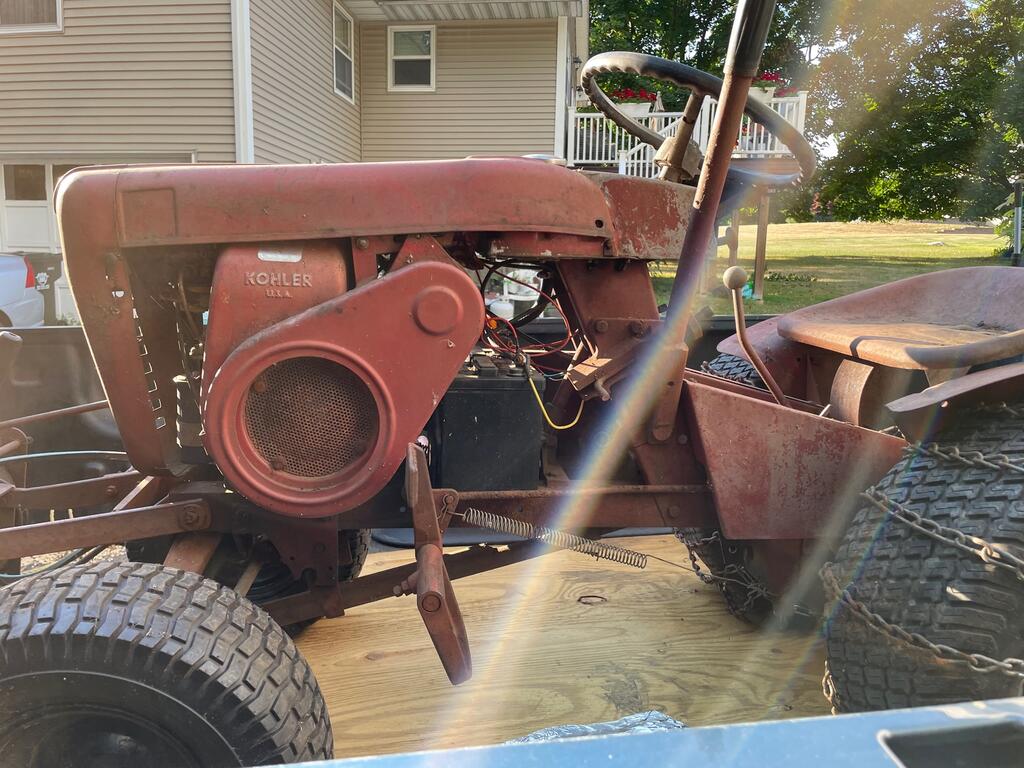

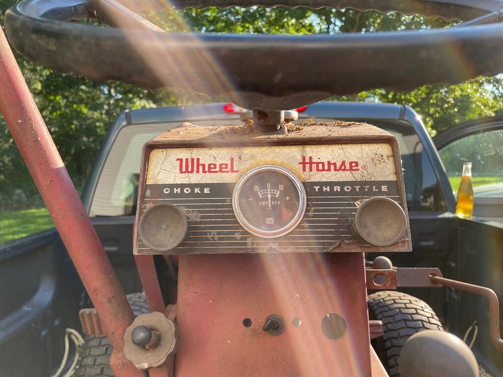

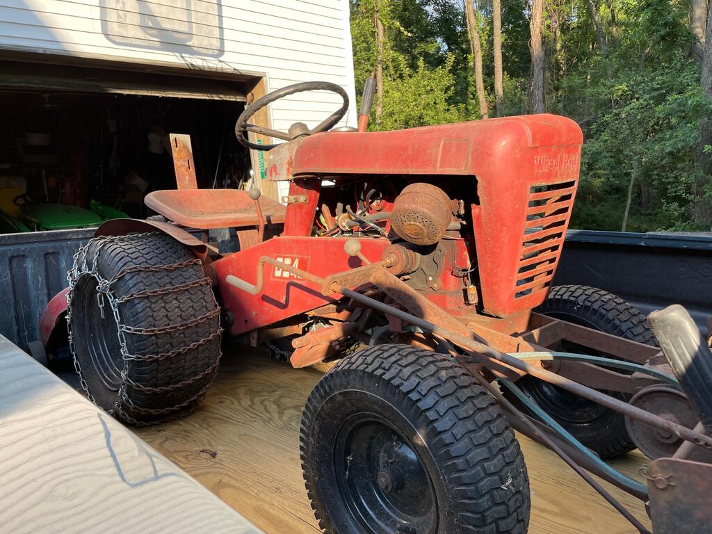

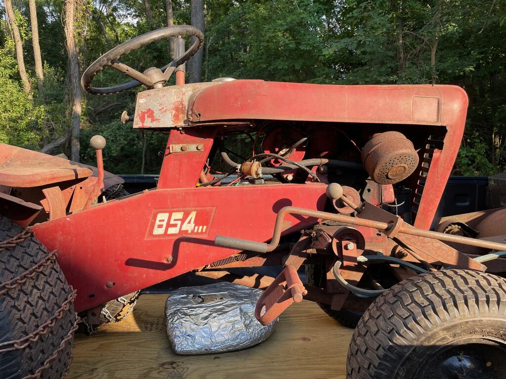

Ro-Go 76 #1 Posted July 14, 2022 I finally got my unicorn. Came with a snowblower and mower deck. Initial pics are below. I will have some questions as I get to making it a runner (I'm not fully restoring/painting). First, what method and products do you use to clean the machine? I have CLR and a Zep degreaser currently. Should I use a Scotch Brite pad or just towels? When it's fully cleaned, I'll give it a bath in Gibb's Oil. So excited for this little monster to be added to the stable. 2 3 Share this post Link to post Share on other sites
stevebo-(Moderator) 8,379 #2 Posted July 14, 2022 Don’t use a heavy cutting degreaser on the hood etc. you will be surprised how it eats away patina paint. Share this post Link to post Share on other sites
peter lena 8,970 #3 Posted July 14, 2022 @Ro-Go what an opportunity ! you want to save that patina ? , or wash it away ? personally , I would aerosol lubrication soak that entire painted surface down to soak in the paint feed and save the paint . that oil soak can be working on your paint , while you are wondering what to do . let it soak a day, rub it down with a clean cloth , NO sandpaper / scratch pad , till dry . do that again . you have just saved that look , a linseed oil rub down will finish it . this is not a greasy mess , its neglect / patina . easy to save , think a satin oil finish on that would be the deal , linseed oil for last rub down . save it , pete 1 Share this post Link to post Share on other sites
Ro-Go 76 #4 Posted July 14, 2022 Pete, that sounds like the ticket. I definitely want to save what is left. Gibbs soak followed by BLO it shall be. 1 Share this post Link to post Share on other sites
ri702bill 8,745 #5 Posted July 14, 2022 (edited) Off to a good start!! Too bad the hood has been cut, but it is repairable. 854's came with the 2 piece gas tank that are prone to leaking at the perimeter gasket - new ethanol friendly gaskets are now available. Glad to see the original style gas cap in place - there was a real butcher "fix" approved by WH in the 1960's to address the leak by cutting out the bottom plate of the tank and installing a 1 quart lawnmower tank inside the original - hack!!! You may wish to rewire it, as the wiring looks a tad sketchy. I added a solenoid to my 854 when I rewired mine and added a main fuse. Changed mine to a C81 8 speed Unidrive, as the original 4 speed was locked up, full of water. Bill 854_8_speed_with_323_Blower.mp4 Edited July 14, 2022 by ri702bill Share this post Link to post Share on other sites
D_Mac 8,943 #6 Posted July 14, 2022 I use Dawn dish soap and a soft brush. Tooth brush in the smaller areas. When all cleaned and dried I rub it all down with boiled linseed oil. Let it bake in the sun then apply some more. It will come out beautiful. Nice machine you got there. Share this post Link to post Share on other sites
Ro-Go 76 #7 Posted July 14, 2022 Ok, excellent. Another question -- I'm going to put on original tires. The front wheels should work for Carlisle sawtooth 4.80 x 4.00s. The rear wheels look wide for the 6 x 12 original turf tires. What size wheel is original to this model? Share this post Link to post Share on other sites
Ro-Go 76 #8 Posted July 14, 2022 38 minutes ago, ri702bill said: Off to a good start!! Too bad the hood has been cut, but it is repairable. 854's came with the 2 piece gas tank that are prone to leaking at the perimeter gasket - new ethanol friendly gaskets are now available. Glad to see the original style gas cap in place - there was a real butcher "fix" approved by WH in the 1960's to address the leak by cutting out the bottom plate of the tank and installing a 1 quart lawnmower tank inside the original - hack!!! You may wish to rewire it, as the wiring looks a tad sketchy. I added a solenoid to my 854 when I rewired mine and added a main fuse. Changed mine to a C81 8 speed Unidrive, as the original 4 speed was locked up, full of water. Bill 854_8_speed_with_323_Blower.mp4 8.42 MB · 0 downloads Bill -- part number to tank gasket? I will be rewiring, probably keep it stock, grabbed a cole - hersee 70 amp switch already. Guy I bought it from said he used the snowblower two winters ago and it worked great. Share this post Link to post Share on other sites

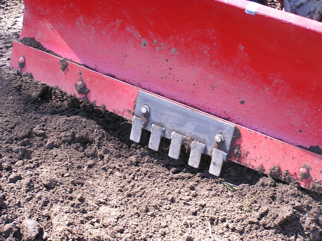

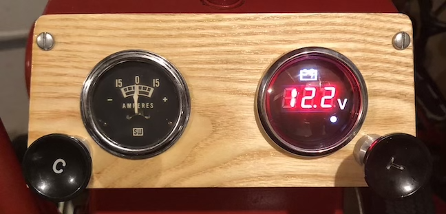

ri702bill 8,745 #10 Posted July 14, 2022 (edited) Gasket is a non WH part, available on Fleabay, about 20 bucks - search 654 tank gasket. Going to a solenoid does away with the heavy current load going thru the switch. I did several upgrades to my 1963 30 snowblower, bought it NOS, unused, never mounted to a tractor. I can get into that once I take pictures. Solenoid is mounted to a plate I made with standoffs on the back of the S/G. Pictures from an earlier post about the ripping edge I made up for the plow... Bill Edited July 14, 2022 by ri702bill 2 1 Share this post Link to post Share on other sites
D_Mac 8,943 #11 Posted July 14, 2022 I just put a solenoid on my 856 project. I didn't want to spend money on a new switch. I already had the solenoid laying around. Not original but works just fine. 1 Share this post Link to post Share on other sites

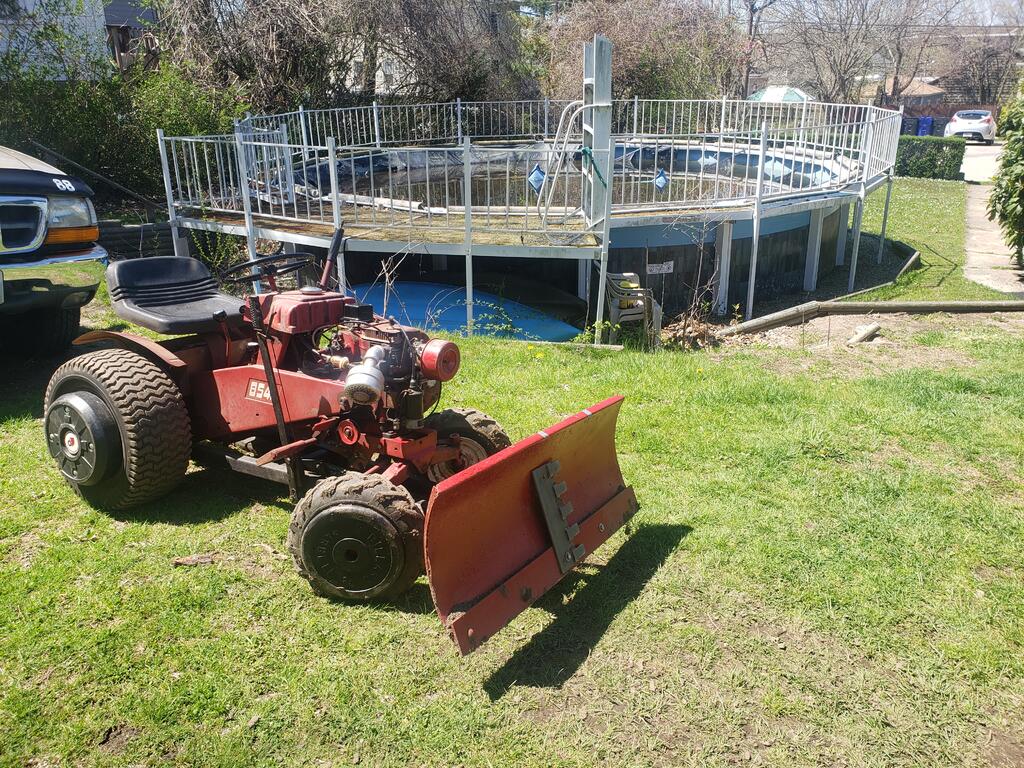

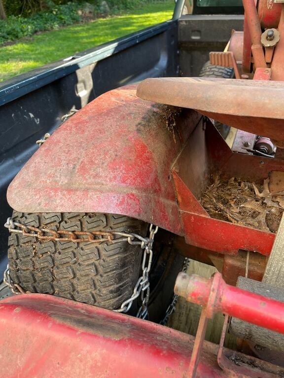

ri702bill 8,745 #12 Posted July 14, 2022 (edited) 1 hour ago, Ro-Go said: he rear wheels look wide for the 6 x 12 original turf tires. What size wheel is original to this model? The 854 came with 6.00-12 tires, either AG style or sawtooth turf style on narrow rims - you rear rims are not original - I run 23 x 10.50 x 12 turf tires in the summer - more stable on hills.- shown above. I run weighted 23 x 850 x 12 turf tires with chains in the winter - the weighted small AG's in front stay on all year... Edited July 14, 2022 by ri702bill 1 Share this post Link to post Share on other sites

Wild Bill in VA 1,455 #18 Posted July 14, 2022 Congrats on getting a Wheel Horse model 854! It has been a favorite mine and I believe it is the best looking of the round hood models. The hood is unique being it is 1 inch longer than any of the other round hood models, the air filter housing is larger on the Kohler 8hp and thus needed a longer hood was used. Wild Bill in Richmond VA 2 Share this post Link to post Share on other sites
Handy Don 13,085 #19 Posted July 15, 2022 (edited) 14 hours ago, Wild Bill in VA said: Congrats on getting a Wheel Horse model 854! It has been a favorite mine and I believe it is the best looking of the round hood models. The hood is unique being it is 1 inch longer than any of the other round hood models, the air filter housing is larger on the Kohler 8hp and thus needed a longer hood was used. Wild Bill in Richmond VA And I have just noticed that, uniquely it seems, there is a reinforcing metal bead folded over the lower part of the hood's horizontal edges--maybe to strengthen or stop vibration? Edited July 15, 2022 by Handy Don 1 Share this post Link to post Share on other sites
