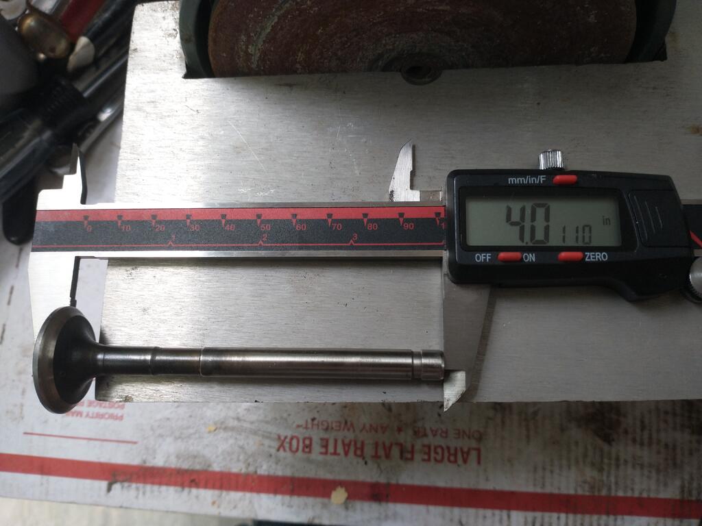

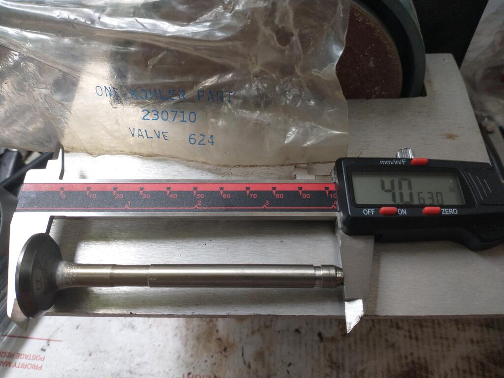

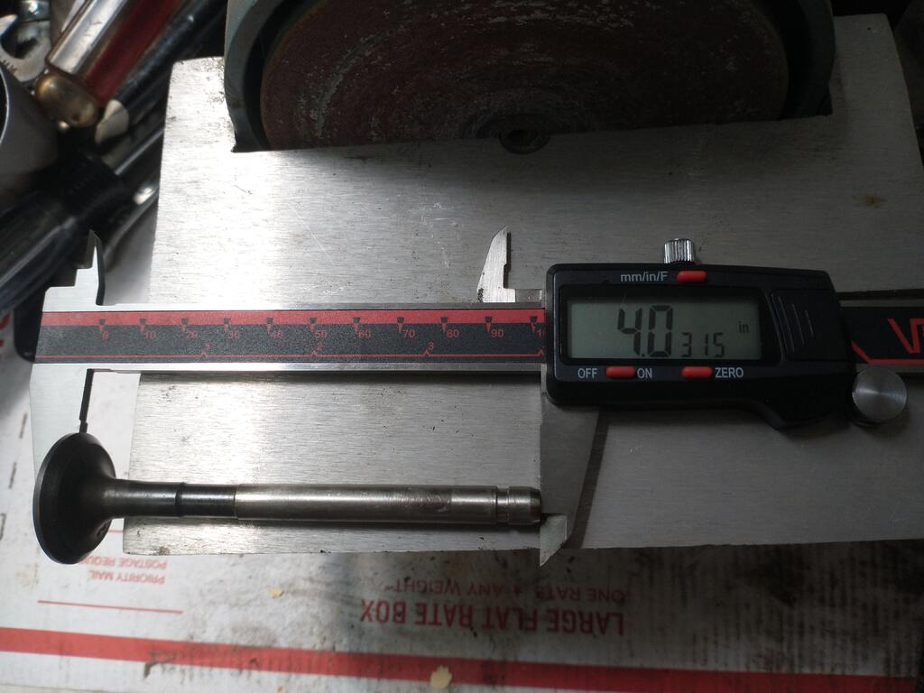

rmaynard 15,801 #23 Posted July 28, 2022 (edited) I have reassembled the K161 using the ACR cam. I had to use a short (1.96) tappet for both the exhaust and the intake. I have yet to figure out why my K181 doner had a 2.03 tappet for the intake. Here's the thing. A new exhaust valve (230710) is 4.063 long. The exhaust valve from the K181 is 4.0315. The exhaust valve from the K161 is 4.0110 The 2.03 tappet would be much to long, even for the shortest of the valves, whether exhaust or intake, requiring excessive grinding of the stems for proper clearance. With the shorter tappets installed, and the exhaust valve stem ground to 4.011, I have a clearance of 0.017. Edited July 28, 2022 by rmaynard 2 Share this post Link to post Share on other sites

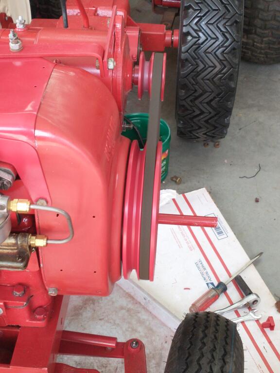

rmaynard 15,801 #25 Posted April 5, 2023 (edited) Well, today was the day see what all my engine changes did for me. First of all, I wanted to see how the engine turned over with just one belt. The belt us just tight enough to turn the engine without slipping. After this picture, I move the belt to the inner pulley thinking it would put less strain on the starter bearing. I hooked up a temporary fuel tank, primed the carburetor, and applied power to the starter. The engine turned over without effort (as I expected it to), and ran like a top. So, I don't know what if anything I accomplished by installing the ACR cam other than proving that it's easy, allows you to do static timing, and saves one V-belt. Edited April 6, 2023 by rmaynard 3 Share this post Link to post Share on other sites
