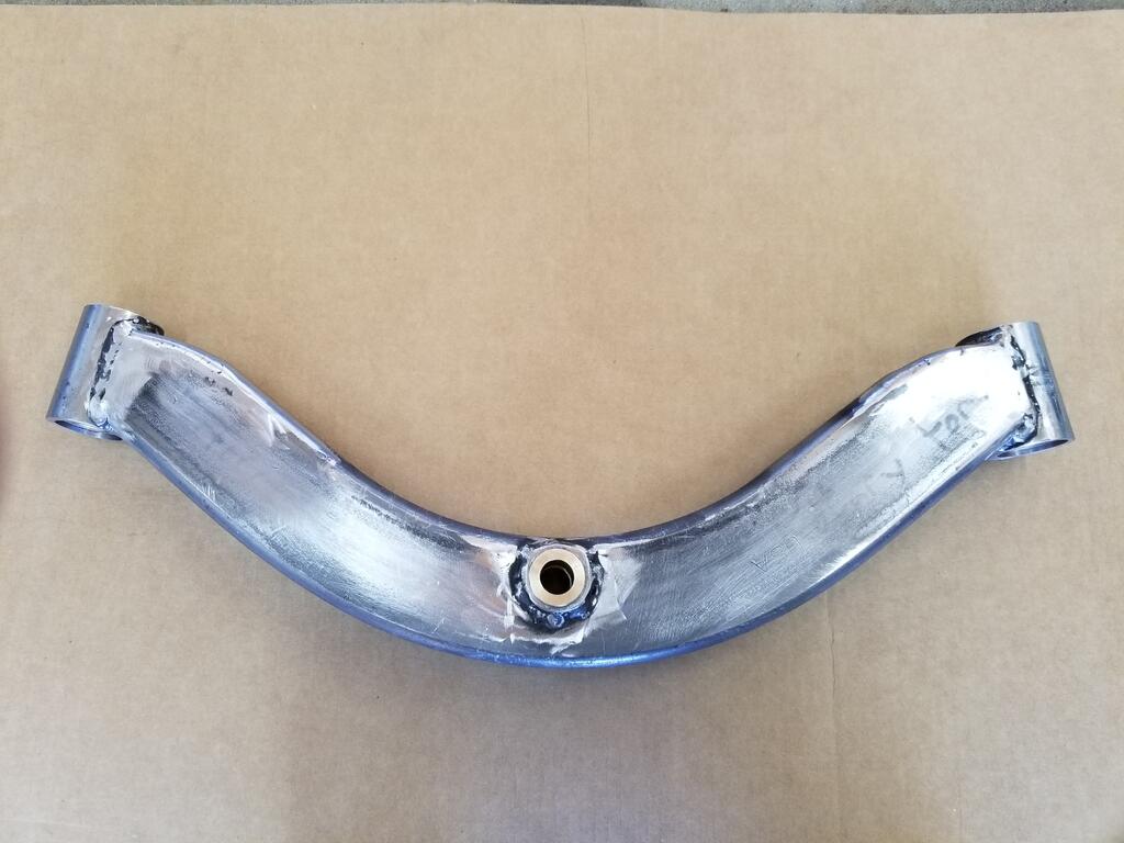

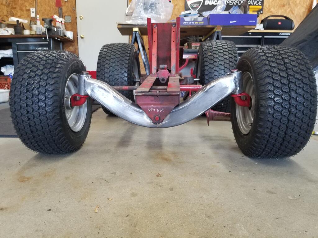

Excellent work!! Not too much teeter-totter room from the pivot, but some. Did you line the bores with bushings??
Bill
So cool!  Is that bent rectangle tubing or fabricated and smoothed?
Wild Bill 633
The axle started as a bent 2"X3" rectangular tube. It was bent with minimum bend radius and the center pivot is as high as it can go. The new fabricated frame will have notched angle iron side rails so the axle can pivot the same as OEM. Both the center pivot and the spindle tubes have greaseable bronze bushings.

@Bill633 excellent fabrication! Looking forward to the rest of the build.
