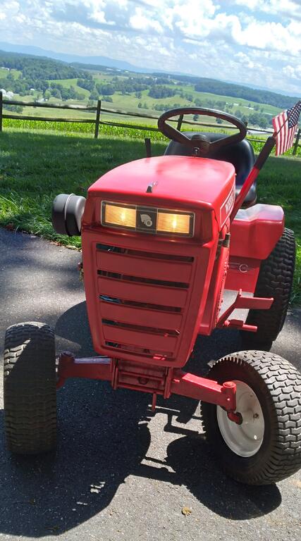

My new to me 520 came without headlights, well ones that worked anyway. All too often when one picks up a new to tractor one ends up having little things that need fixing or un-cobbling or just general maintenance. I guess these little things are the most enjoyable, for me anyway, mountains to conquer. Its not like when you get her home and discover the hydro has no go or the engine smokes like a chimney or the deck needs all three spindles. Its these little things they are most easy and least $$ to fix.
Since neither light worked I went right to the source first and checked the fuses and switch. Quickly discovered that wiggling the spade connectors at the switch at least one head light and one taillight would work. Cleaned the spade connectors and terminals on the switch resolved the intermittent problem but now only one tail light would work. More on the tail end later. A quick ohm & voltage check of both original 4411 sealed beam lamps revealed no one was home, both shot. A quick check of auto parts stores & TSC found that they are quite common anywhere with prices being anywhere between 11 and 18 bucks. In the interest of energy efficiency and better lighting the search was on for led replacements. I found there was no direct led replacement but these PAR36 bulbs were very similar. They are primarily used in low voltage outdoor accent lighting and can be had in many colors, wattages and light output.
I settled on these from the jungle site, about 16 clams a piece, but found them on flea bay and LED light retail places as well. Note the 36 watt equivalent spec. Most if not all 4411 replacements are 35 watts.
I half expected them to be encased in plastic but a nice surprise to find them all glass sealed beam with good quality.
Installation truly plug & play. Fit as perfect as originals.
Best off is this .311 amp draw per light or .625 per set! .
Leaves plenty of room on the 20 amp charge system for more lights, heated steering wheel, heated seat & vest!
More pics when it warms up abit out and I can get some decent night shots.
