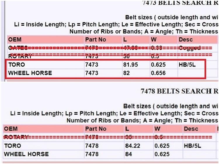

Jrain 276 #1 Posted July 5, 2022 So I am trying to finish up loose ends on a 16 automatic , after going through all the drive belt topics here on what belt to use I decided to buy the belt local just in case I ended up with fitment issues , So ended up at my local Napa rip off store ,I did go to my local tractor supply first but no luck they did not have 5/8'' x 82'' in stock , So got a 5L820w at my local rip off Napa , Now I have to ask should you have to use a crow bar to turn the belt on to the pully ? to install the belt ,I do not think so but maybe I am wrong ,Please tell me what should the appropriate amount of force is needed to Install a drive belt on a Hydro wheel horse. Something aint right , I measured both engine and pump pully's on all 3 hydros I have . c120, and both auto 16 s , and all 3 WHs have the same diameter pully's both engine and pump . 1 Share this post Link to post Share on other sites

Jrain 276 #11 Posted July 5, 2022 10 minutes ago, davem1111 said: Does the tractor have an original engine on it? I ran into a belt problem with my GT-1848 which was supposed to use an 83" belt, but it was re-powered with a Honda engine at some point, and I had to switch to an 82" belt to get enough tension on it. Sounds like you might need an 83", but it's hard to tell. I put this belt on recently and recall that it was difficult to get it on the pulleys. Yep tractor has original Kohler big block 16 , Like I said I even tried this new belt on my c120 witch comes up as same wheel horse part number 7473 , and does not fit either tractor , can not seem to find size for WH belt 7473 in all the old threads here about belts just everyone gives Napa or tractor supply number maybe they are 83 ,but evn 83 might be tight , ,Just trying to see if anyone can give me a correct number ,or maybe it needs a 1/2 width with 82 length in stead of 5/8 width , but I can see the old belts were 5/8 because the c 120 belt is 1/16 shy of 5/8 and the one I am replacing is 1/16 over 1/2 inch width the ends on that one are tattered that why I am replacing that belt. 10 minutes ago, davem1111 said: Does the tractor have an original engine on it? I ran into a belt problem with my GT-1848 which was supposed to use an 83" belt, but it was re-powered with a Honda engine at some point, and I had to switch to an 82" belt to get enough tension on it. Sounds like you might need an 83", but it's hard to tell. I put this belt on recently and recall that it was difficult to get it on the pulleys. 1 Share this post Link to post Share on other sites
ebinmaine 70,792 #12 Posted July 5, 2022 3 hours ago, Jrain said: 16 automatic There's yer kicker right there. 17 minutes ago, Jrain said: WH belt 7473 The Automatics take a 7478. 2 2 1 Share this post Link to post Share on other sites
squonk 42,579 #13 Posted July 5, 2022 Hydro's use a bigger engine pulley tan 8 spds. 7478 is a 5L840W. Now you can go back to your rip off store, get your money back and maybe have some money left for a coffee! 2 1 Share this post Link to post Share on other sites
Jrain 276 #14 Posted July 5, 2022 10 minutes ago, squonk said: Hydro's use a bigger engine pulley tan 8 spds. 7478 is a 5L840W. Now you can go back to your rip off store, get your money back and maybe have some money left for a coffee! LOL , Ok so 5 L 5/8 84 inches in Length , And I know tractor supply had about 6 5/8 84 inch belts in stock So , I will go back to My privately owned RIp off Napa store get my $58.64 back and go directly to tractor supply and spend $25.99 , and then go have a nice 25 dollar lunch with coffee of course , Thank you very much sir for your help and time in this matter . 2 1 Share this post Link to post Share on other sites

daveoman1966 3,809 #18 Posted July 6, 2022 (edited) The OEM belt for Wheelhorse Autos is #7478. The OEM belt for 8-speed trans is #7473. On these older tractors, you'll find the OEM belts are much better and last for decades over any after-market. These two OEM belts get to near $50 bux, but worth it in the long haul... Edited July 6, 2022 by daveoman1966 3 Share this post Link to post Share on other sites
