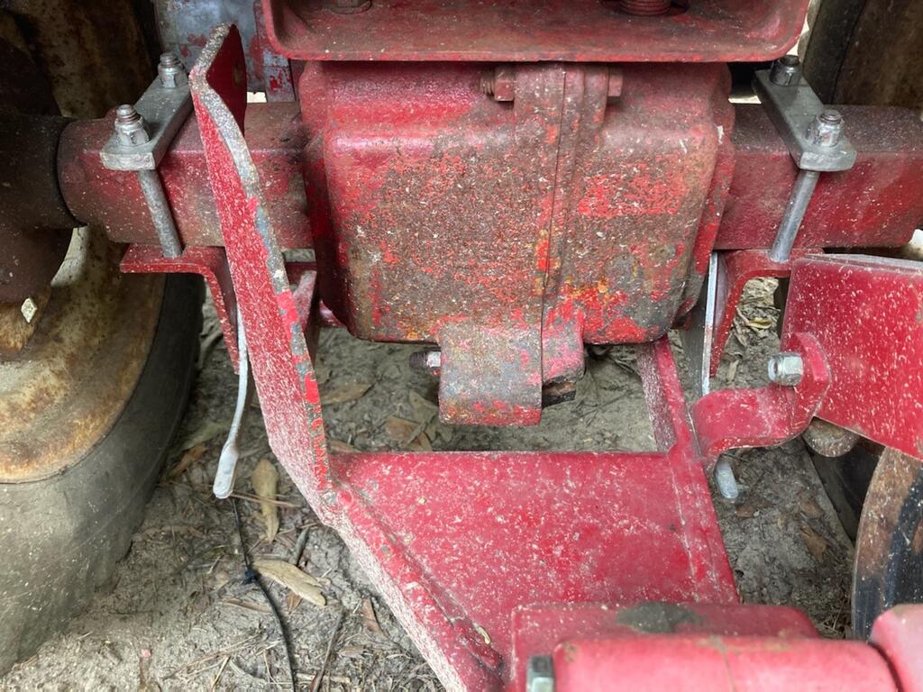

The rear case is broken (90-1140, pic attached) but it holds fluid which is clean. My major concern right now is that when I block the front tires I can spin the right rear but the left (with the damaged hub) does nothing. I really want the hydro lift for this heavy a$$ tiller but have an 8-speed on the donor unit but it only has 1" axles. I suspect there will be no way to really know without separating the case but does this sound like I should write off the transmission and look for a replacement or is the dead axle not a terminal sign?

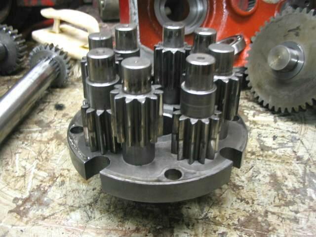

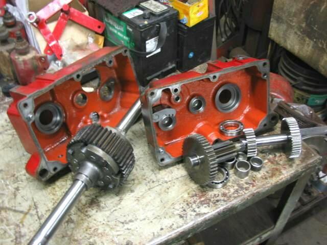

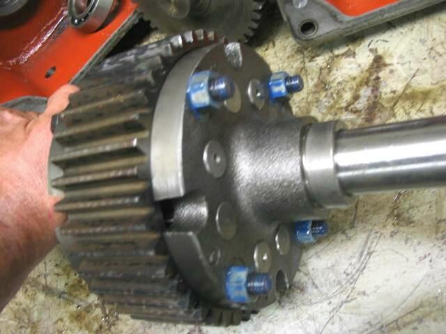

This is the GEARBOX of the C-160 Auto trans.
Not complicated at all.

ineedanother
That looks manageable and I do have a pretty decent machine shop nearby if needed. I might try to run it a bit to see if anything else rears its ugly head before I dive in though.
