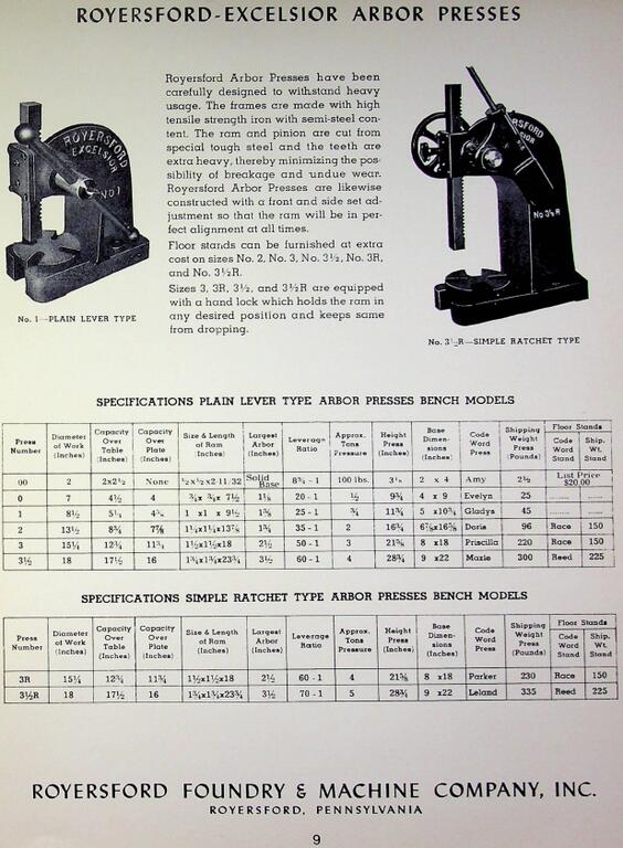

gwest_ca-(File Mod) 11,251 #9 Posted July 1, 2022 Found this in catalog 75B http://vintagemachinery.org/mfgindex/detail.aspx?id=710&tab=3 1 Share this post Link to post Share on other sites

ri702bill 8,993 #11 Posted July 1, 2022 (edited) 6 hours ago, gwest_ca said: Found this in catalog 75B The simple ratchet allows you to set the height of the ram with the handwheel and the lever handle stays stationary. Note the the handle is both smaller in diameter and somewhat shorter than the standard model that has the thumbscrew to allow you to adjust the lever length. This is to protect the ratchet mechanism - do not use a cheater bar or pipe to extend the handle. I see that the handle is bent where it goes into the casting - a little late for my advise... Bill Edited July 1, 2022 by ri702bill 1 Share this post Link to post Share on other sites
