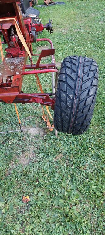

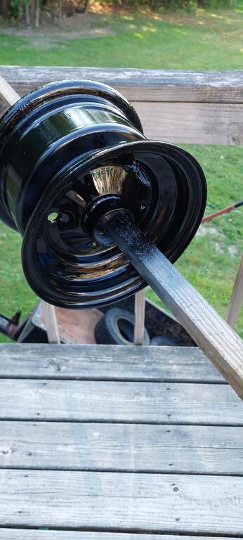

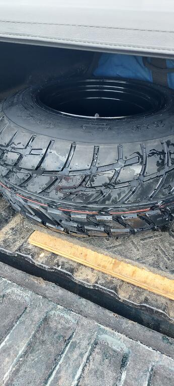

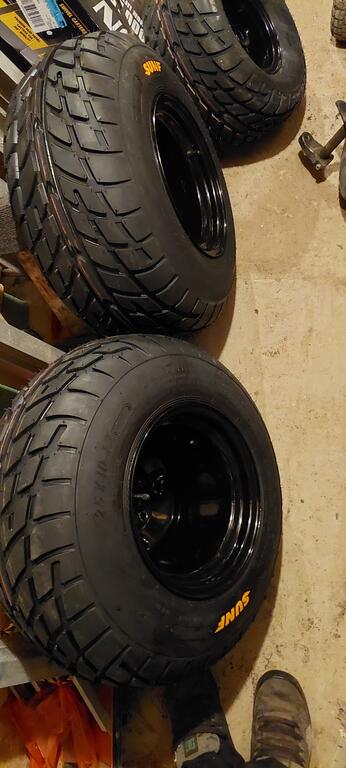

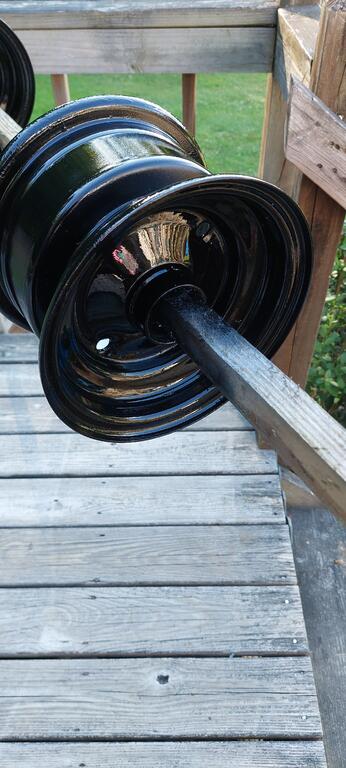

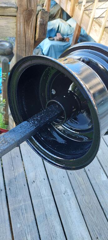

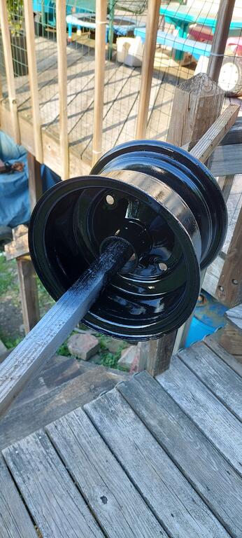

fast88pu 3,372 #51 Posted July 23, 2022 Well it finally cooled down some out today that I could dismount the tires and remove bearings and paint wheels. 8 2 Share this post Link to post Share on other sites

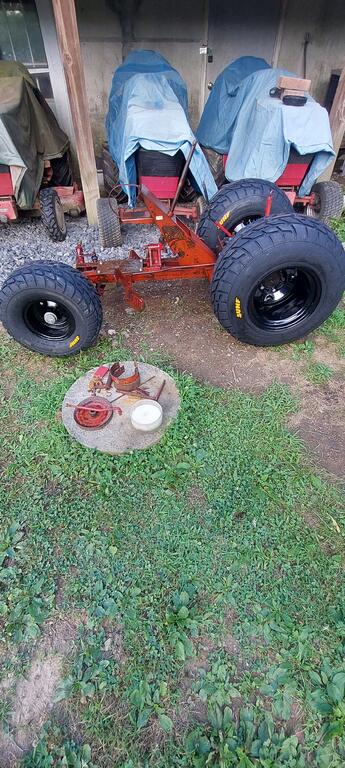

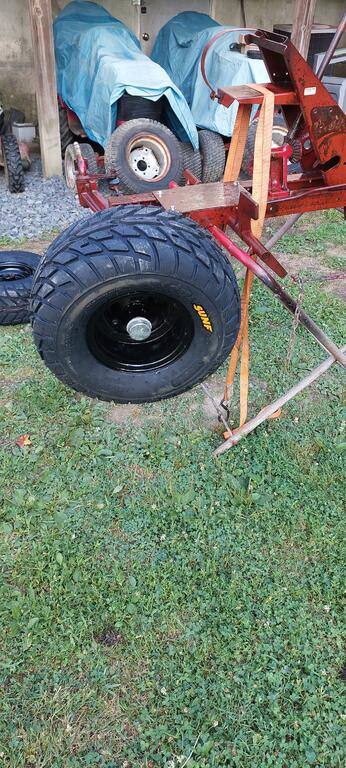

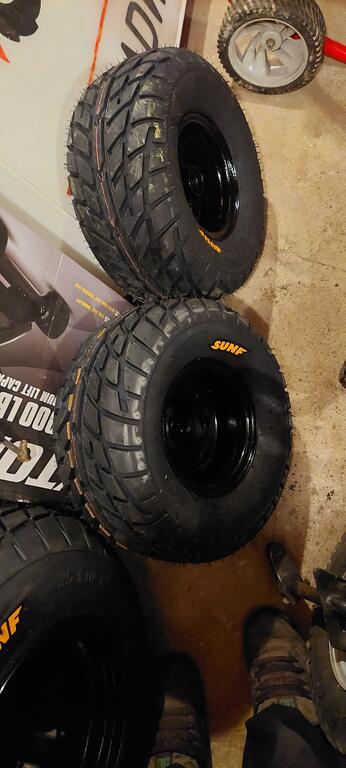

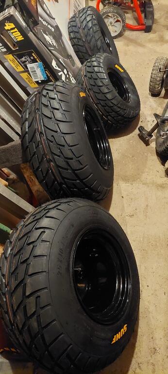

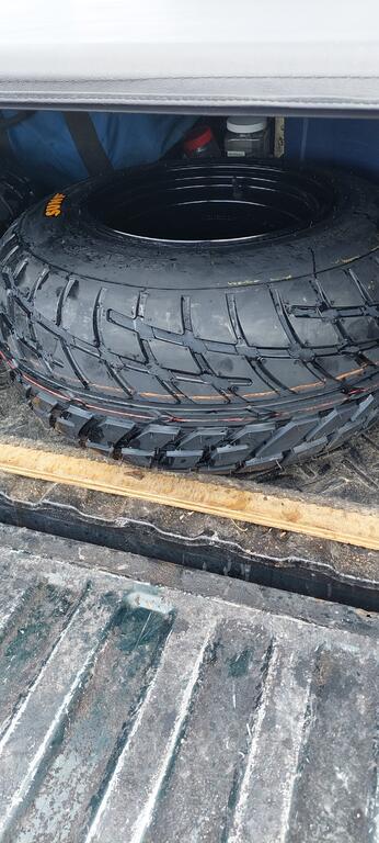

fast88pu 3,372 #52 Posted July 24, 2022 Tires mounted today, I have to get new bearings and races before installing them 9 Share this post Link to post Share on other sites

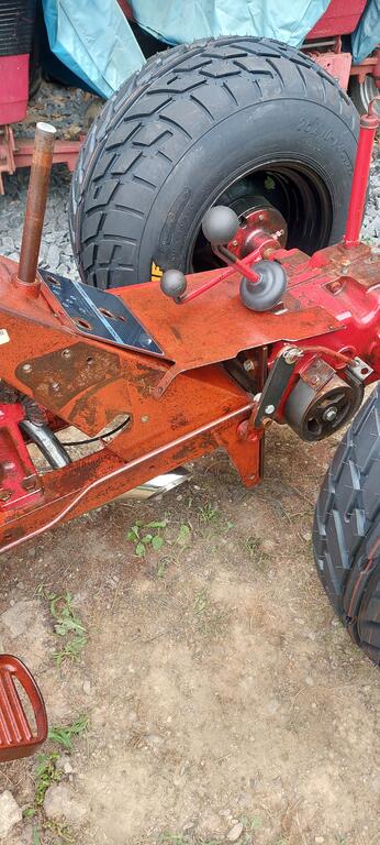

Handy Don 15,173 #53 Posted July 25, 2022 Looks cool. The inverted axle will give you a nifty low rider look, but you may want to reinforce the spindle-to-axle attachment beyond the stock c-clip. I'd consider drilling and tapping for a bolt into the ends of the vertical spindle shafts (similar to what holds the wheel on many Horses' horizontal spindle shaft). Mount with a good thick washer and thrust bearing to carry the weight and absorb impacts and secure the bolt with blue or green Loctite. 2 1 Share this post Link to post Share on other sites

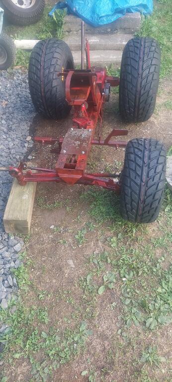

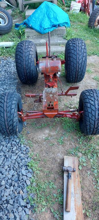

fast88pu 3,372 #54 Posted July 25, 2022 Rear tires mounted 6 Share this post Link to post Share on other sites
stevebo-(Moderator) 8,600 #55 Posted July 25, 2022 Want to see them mounted on machine!! 1 Share this post Link to post Share on other sites

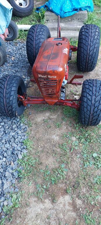

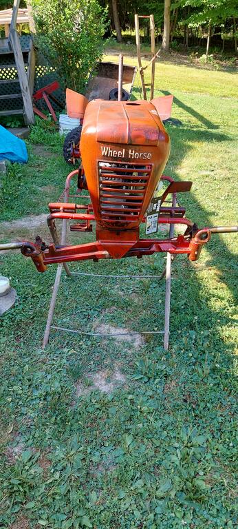

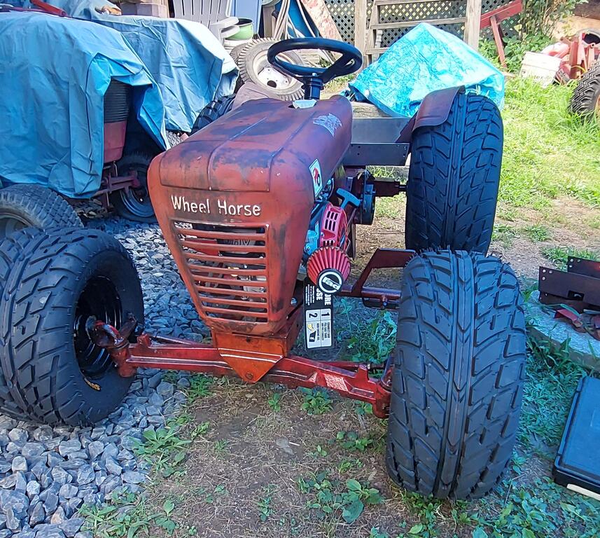

fast88pu 3,372 #56 Posted July 25, 2022 Fronts mounted too 5 Share this post Link to post Share on other sites

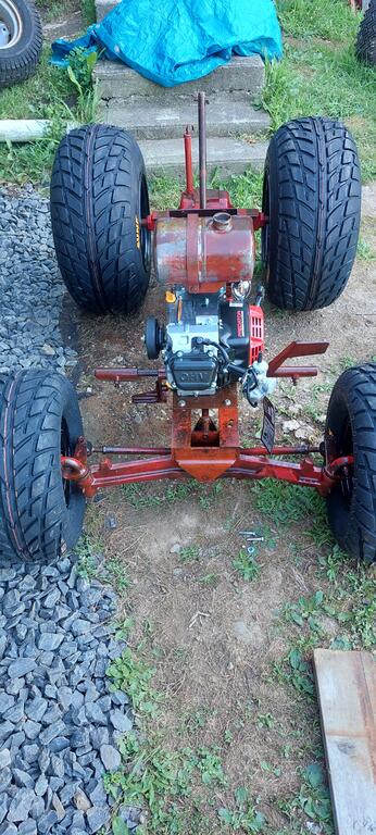

fast88pu 3,372 #57 Posted July 25, 2022 Rears bolted up 1 4 Share this post Link to post Share on other sites

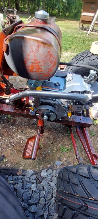

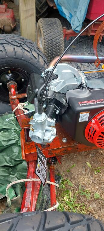

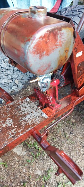

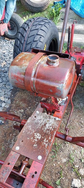

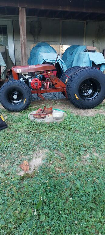

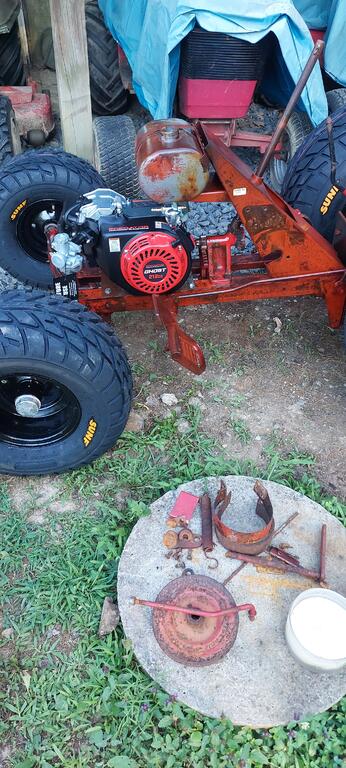

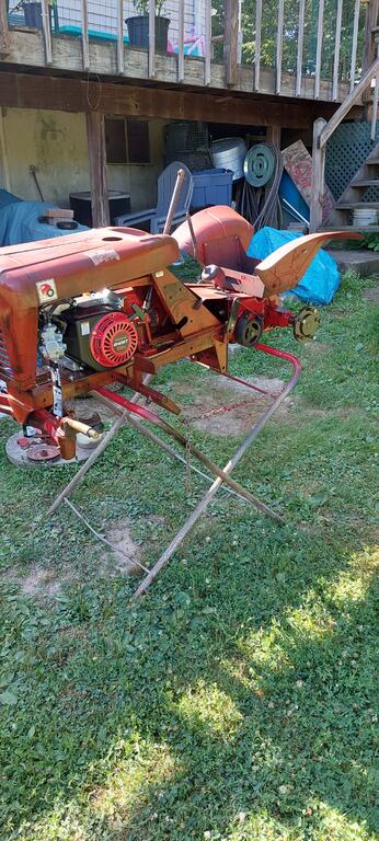

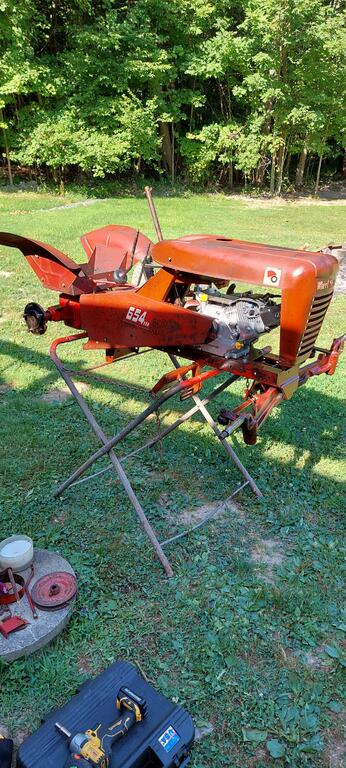

fast88pu 3,372 #58 Posted July 26, 2022 I grabbed the bearings today for the other front wheel. Also grabbed the fittings for the gas tank. Then mounted the wheel, gas tank and engine. 2 6 2 Share this post Link to post Share on other sites
wallfish 18,786 #59 Posted July 27, 2022 Looks fast just sitting there Centrifugal clutch I see. Any jack shaft with pulleys on it going in between that and the trans? 3 Share this post Link to post Share on other sites
fast88pu 3,372 #60 Posted July 27, 2022 1 hour ago, wallfish said: Looks fast just sitting there Centrifugal clutch I see. Any jack shaft with pulleys on it going in between that and the trans? No straight to tranny Share this post Link to post Share on other sites

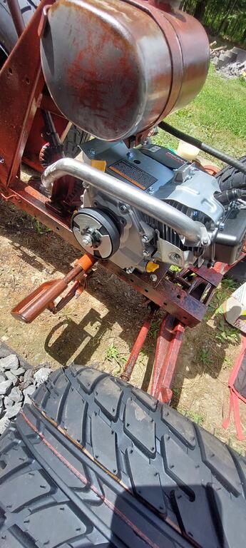

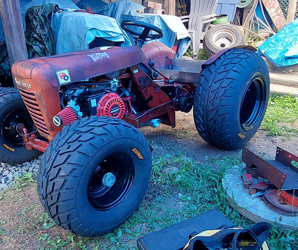

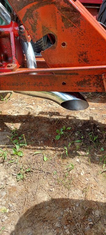

fast88pu 3,372 #61 Posted July 30, 2022 Had some free time today to make the exhaust then started her up and started heat cycling. 6 Share this post Link to post Share on other sites
fast88pu 3,372 #62 Posted July 30, 2022 It's alive 20220730_134917.mp4 5 Share this post Link to post Share on other sites

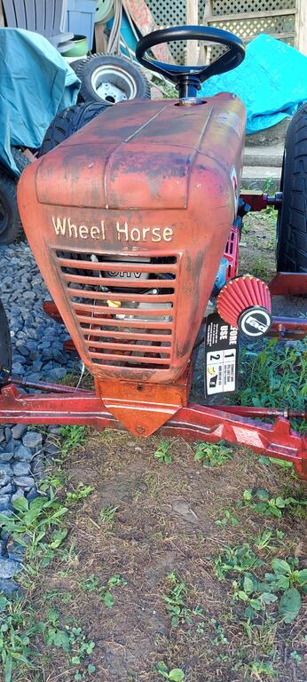

HUDSON89 202 #63 Posted July 31, 2022 On 7/17/2022 at 1:54 PM, fast88pu said: And for those that got butt hurt over me sandblasting this perfect patina machine (stevebo). Here are the real photos of it. Did you have to modify the front axle pivot to make that axle fit ? Share this post Link to post Share on other sites
fast88pu 3,372 #64 Posted August 1, 2022 4 hours ago, HUDSON89 said: Did you have to modify the front axle pivot to make that axle fit ? No I didn't Share this post Link to post Share on other sites

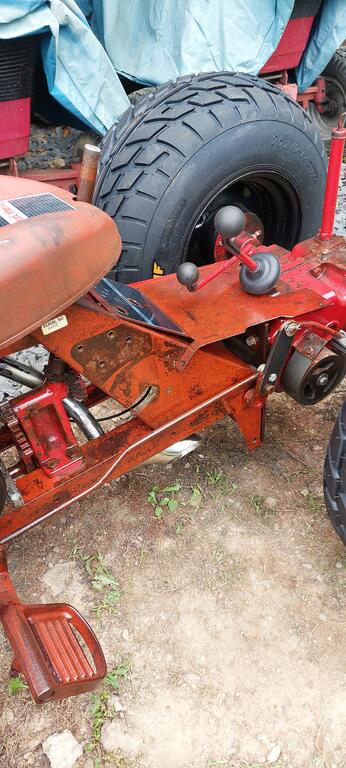

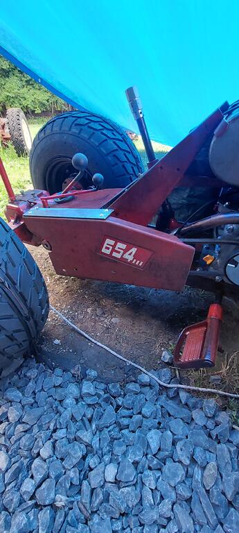

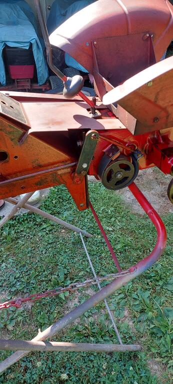

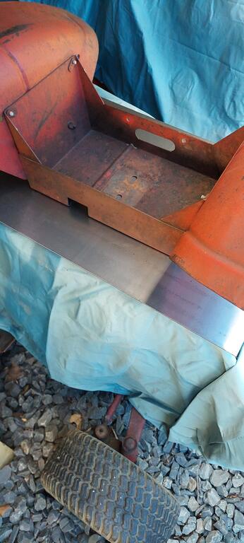

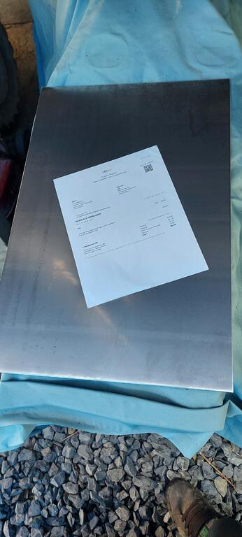

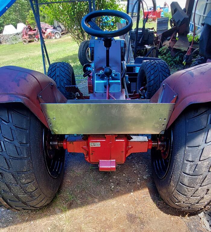

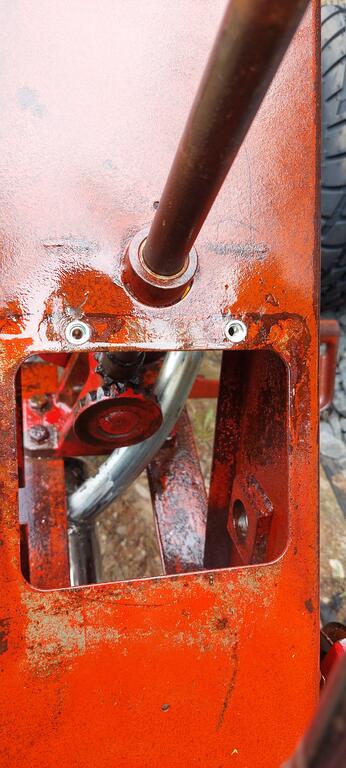

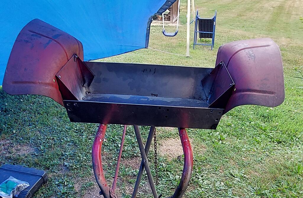

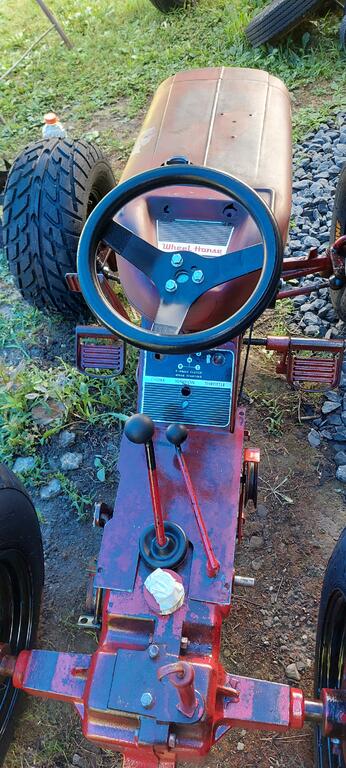

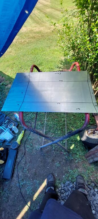

fast88pu 3,372 #65 Posted August 1, 2022 I cut down the shifters and steering shaft today. I also cleaned up all the sheet metal and cleared some of it. Now to figure out a foot throttle for it. Also had to install a few new nut serts where the originals were missing 1 6 Share this post Link to post Share on other sites

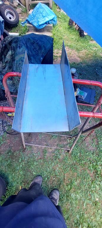

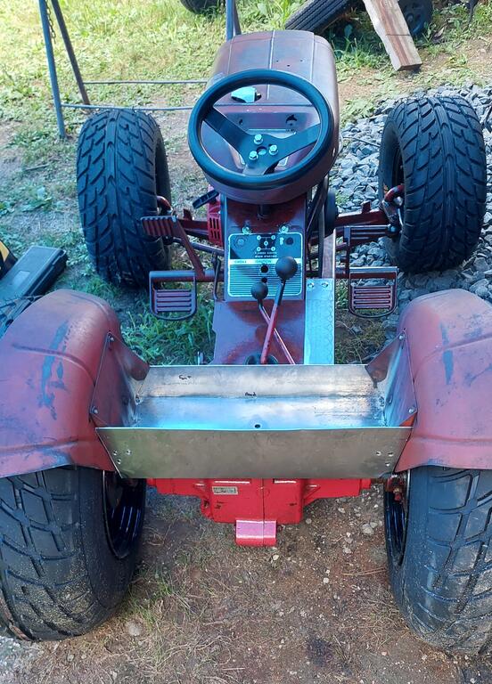

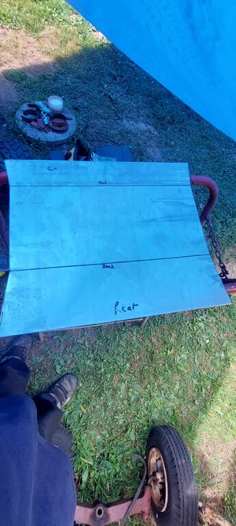

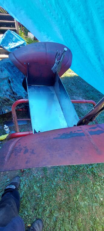

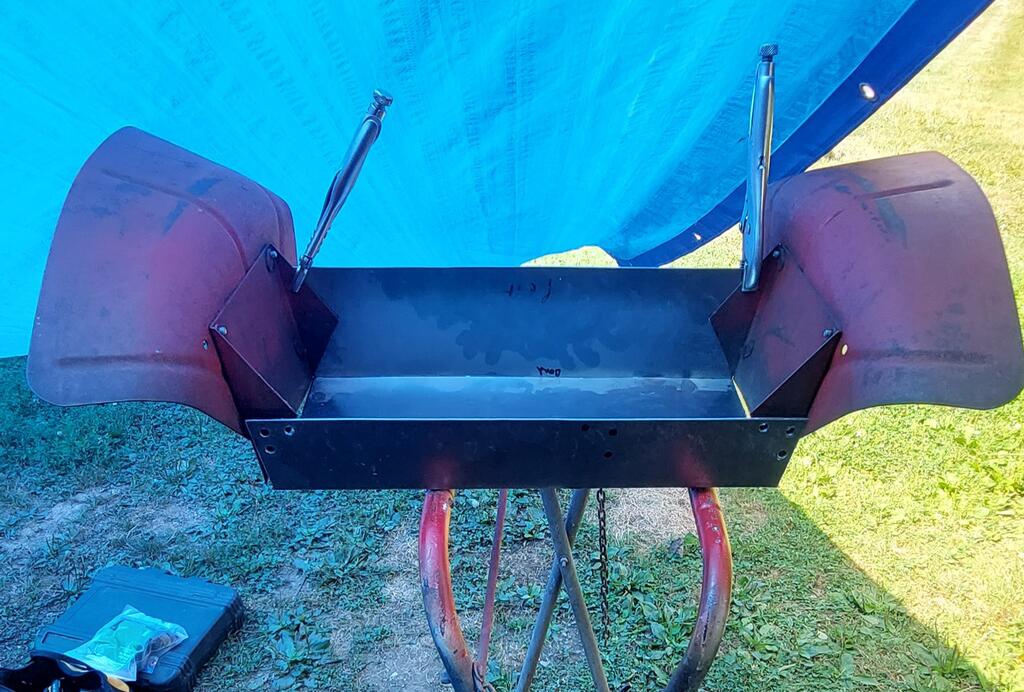

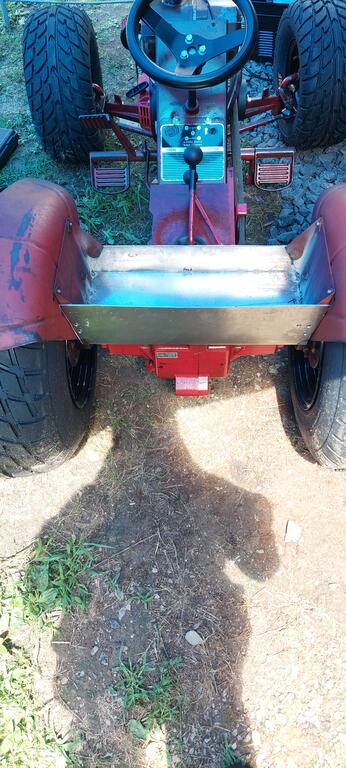

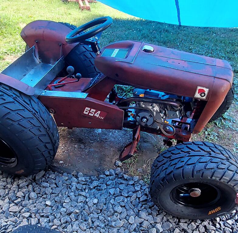

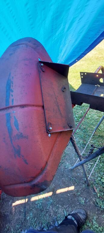

fast88pu 3,372 #66 Posted August 6, 2022 So the ne steering wheel showed up yesterday and the metal I ordered also came. I mounted the quick connect for the steering wheel so can take the hood off. I also modified the belt guard and that is almost complete now. Then I made the new tool box for the fenders. That took a little bit of time but it is just tacked together for now. Steady progress is always nice. 1 8 Share this post Link to post Share on other sites
Bill D 2,442 #67 Posted August 6, 2022 (edited) Nice. Where did you get the wheel and adapter from? Can you post part numbers for them please? Thanks Edited August 6, 2022 by Bill D Share this post Link to post Share on other sites
fast88pu 3,372 #68 Posted August 6, 2022 14 minutes ago, Bill D said: Nice. Where did you get the wheel and adapter from? Can you post part numbers for them please? Thanks Wheels are 10.5" wide 12" rims. Made up. And the spacers are just 5 x 4.5 car wheel spacers. Same pattern as jeeps and mustangs 1 Share this post Link to post Share on other sites
Pullstart 68,521 #69 Posted August 6, 2022 That looks real nice Kyle! 1 1 Share this post Link to post Share on other sites
Snoopy11 5,723 #70 Posted August 6, 2022 Looks great, but I'd make a guard so when that cast flywheel comes apart... it doesn't go into your groin... Or just invest in some of these... Don 1 Share this post Link to post Share on other sites
Bill D 2,442 #71 Posted August 6, 2022 1 hour ago, fast88pu said: Wheels are 10.5" wide 12" rims. Made up. And the spacers are just 5 x 4.5 car wheel spacers. Same pattern as jeeps and mustangs I'm sorry, I meant the steering wheel and adapter. I should have been more specific. Share this post Link to post Share on other sites
fast88pu 3,372 #72 Posted August 7, 2022 33 minutes ago, Bill D said: I'm sorry, I meant the steering wheel and adapter. I should have been more specific. Steering wheel is a grant and the adapter is just a 3/4" quick removal for racing Share this post Link to post Share on other sites
