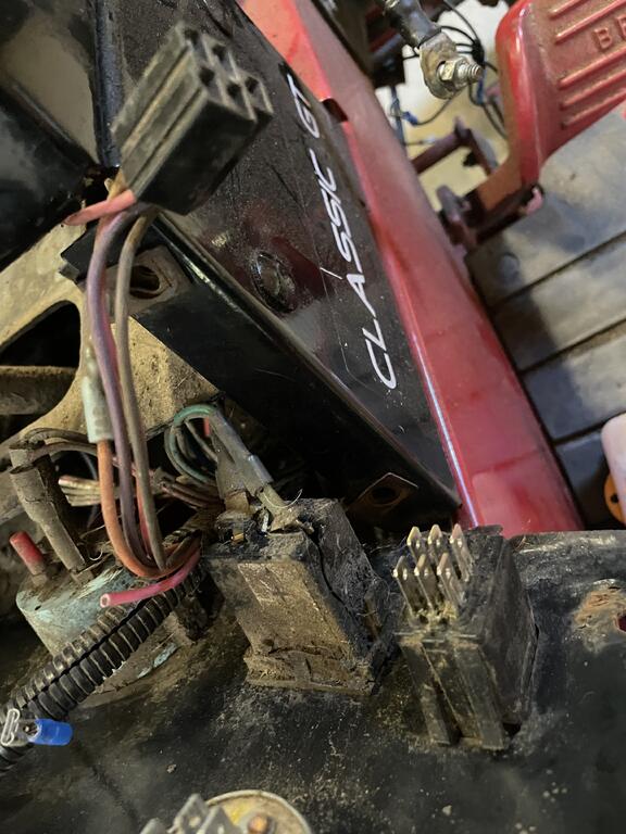

RustyGold 88 #1 Posted June 29, 2022 Just picked up a clean wheelhorse 315-8. Only 308 hours & it sounds good . When I shut off the key , it stays running. I have to shut the gas off to make it stall . Lights don’t work & someone relocated the electric PTO to the light switch . I noticed many wire harnesses are disconnected or hacked up whomever worked on the electricals on this was a bad hack . Share this post Link to post Share on other sites
RustyGold 88 #3 Posted June 29, 2022 (edited) Edited June 29, 2022 by RustyGold . 2 Share this post Link to post Share on other sites
wallfish 17,507 #4 Posted June 29, 2022 Un-10 yr-old it and you should be fine. The key switch needs to ground the ignition magneto to shut down spark. Looks like they were jumping the safety switches to over ride them 5 Share this post Link to post Share on other sites

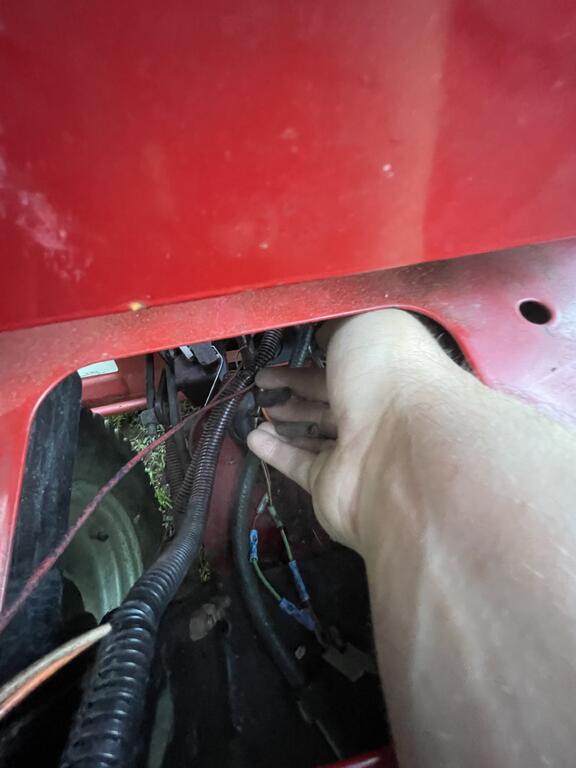

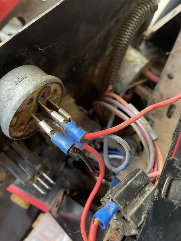

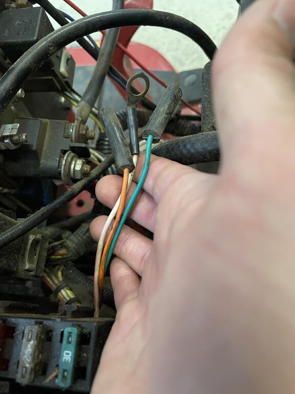

RustyGold 88 #12 Posted June 29, 2022 (edited) So I spent all day today , re-attaching all the color coded looms going to the control panel . What a mess . Most of the factory looms were cut & bypassed with hack crimp connections & jumpers . No more crimp connections, only Solder & heat sink tubing ! Still have a few mystery wires to figure out … Orange/ green/ white wires near the fuse block hanging free . & two wires off the engine block . Your input is appreciated! Edited June 29, 2022 by RustyGold . Share this post Link to post Share on other sites
peter lena 9,092 #13 Posted June 29, 2022 @RustyGold like your soldering fix ,https://www.amazon.com/Sleeve-Flexible-Bundler-Management- , regularly use these , wire wraps to prevent chafing and controlling your runs. consider adding an additional battery cable , from your cowl area , ground bolt from battery bolt down , to the corner of your engine / chassis , use serrated washers dielectric grease , engine corner next to clutch pedal . that will enhance the engine tin rectifier ground spot , better amperage readings . I also use that engine ground to enhance headlights, grounding is a weak spot on these units . just an idea , pete Share this post Link to post Share on other sites

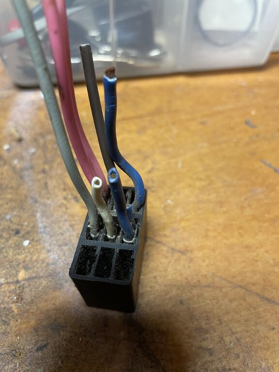

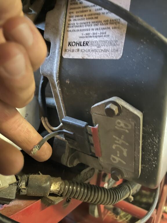

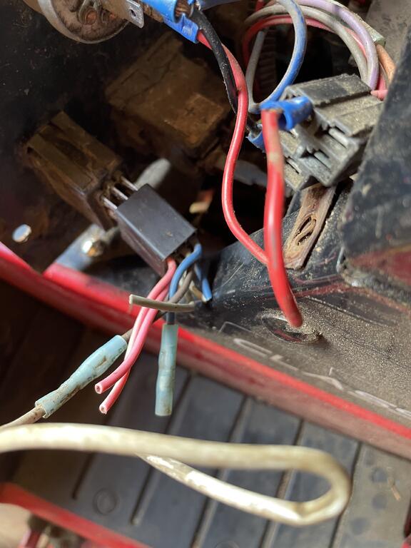

RustyGold 88 #14 Posted June 29, 2022 Also what is this mystery front connector for ? Share this post Link to post Share on other sites
gwest_ca-(File Mod) 11,251 #15 Posted June 29, 2022 The voltage regulator has 9-24-18 written on it. The outside terminals go to the AC wires of the flywheel stator. The center terminal goes to the violet wire and fuse and this circuit charges the battery. See a ground strap on the lower regulator mounting bolt. The body of the regulator requires a good ground for it to function correctly. Share this post Link to post Share on other sites

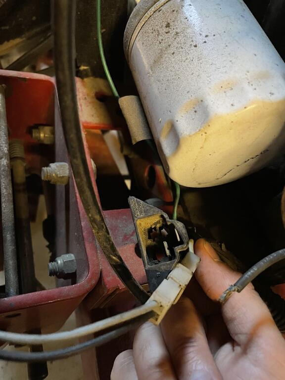

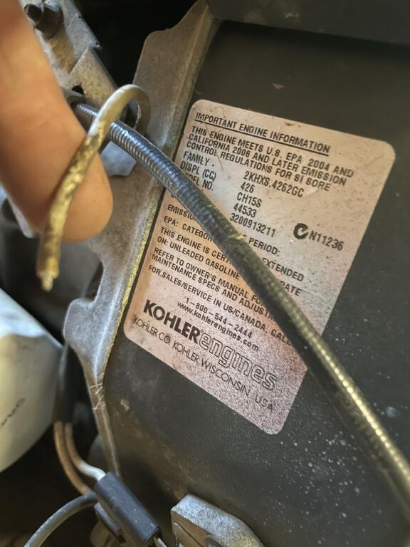

RustyGold 88 #16 Posted June 30, 2022 what is this mystery front connector for ? Can someone confirm this is for the (2) engine wires pictured (light blue & white) ? They hacked up these wires too & im missing the oem connector .. Share this post Link to post Share on other sites
gwest_ca-(File Mod) 11,251 #17 Posted June 30, 2022 Do you still have the NMIR (no mow in reverse) module? There is a blue and white that goes to it. If the wires go into the engine we do not know what colors Kohler used so the wire colors may not be correct in our diagrams. Share this post Link to post Share on other sites

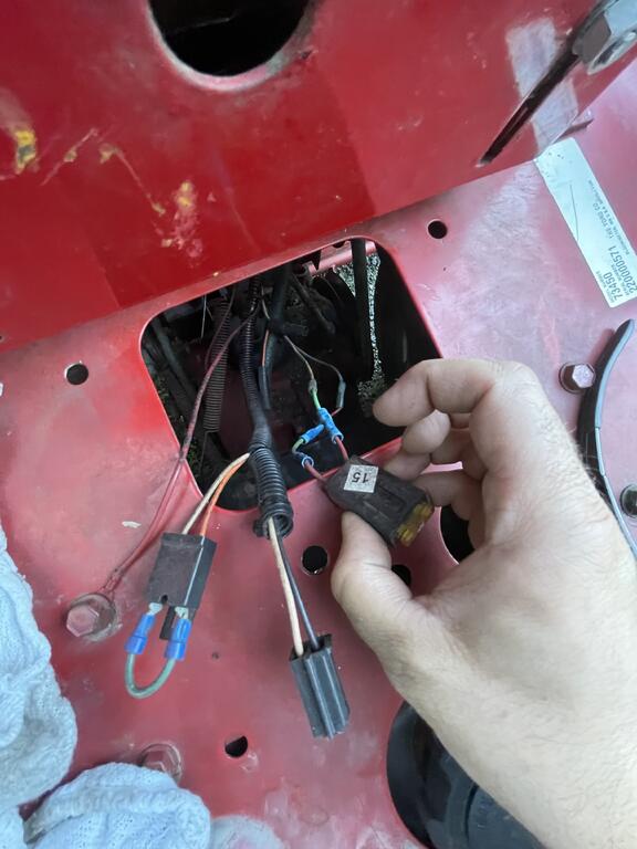

RustyGold 88 #18 Posted June 30, 2022 (edited) 6 minutes ago, gwest_ca said: Do you still have the NMIR (no mow in reverse) module? There is a blue and white that goes to it. If the wires go into the engine we do not know what colors Kohler used so the wire colors may not be correct in our diagrams. Yep , the NMIR module is there . I figured out that the 2 engine wires are supposed to go to a harness that plugs into the empty harness in the front. They cut the plug off . Someone replaced the OEM solenoid With a non-wheelhorse one . I ordered the correct one that the orange/green wires are supposed to connect to . The only one left to figure out , is the white wire with a ring terminal near the fuse block . Where does it connect to ? Edited June 30, 2022 by RustyGold Share this post Link to post Share on other sites

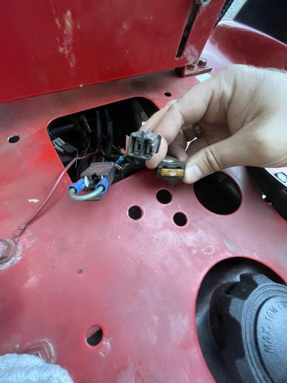

gwest_ca-(File Mod) 11,251 #19 Posted June 30, 2022 A ring terminal would indicate it goes on a screw or bolt and I have no idea what or where that would be. The ignition wire shows as being white from the ignition coil to the kill relay. With the battery disconnected can you check with an ohmmeter to see if the ring terminal on white wire is common with the white ignition wire? The Kohler wiring diagram shows a white wire to an optional low oil pressure switch to kill the ignition if no oil pressure. I don't think Wheel Horse used that but the wire may exist unused in the harness. The only way to identify the relays is to compare the wire colors going to the relay. These would get a big white identifier letter added to the case so one could keep them straight if it were mine. Most often each relay is identical so can be interchanged if needed. Share this post Link to post Share on other sites
RustyGold 88 #20 Posted July 1, 2022 (edited) On 6/30/2022 at 11:37 AM, gwest_ca said: A ring terminal would indicate it goes on a screw or bolt and I have no idea what or where that would be. The ignition wire shows as being white from the ignition coil to the kill relay. With the battery disconnected can you check with an ohmmeter to see if the ring terminal on white wire is common with the white ignition wire? The Kohler wiring diagram shows a white wire to an optional low oil pressure switch to kill the ignition if no oil pressure. I don't think Wheel Horse used that but the wire may exist unused in the harness. The only way to identify the relays is to compare the wire colors going to the relay. These would get a big white identifier letter added to the case so one could keep them straight if it were mine. Most often each relay is identical so can be interchanged if needed. . The white/red striped ring terminal appears like it should attach to the B+ side of the solenoid .it comes from the 30A main fuse block . The schematics aren’t much help on this one Edited July 1, 2022 by RustyGold Share this post Link to post Share on other sites

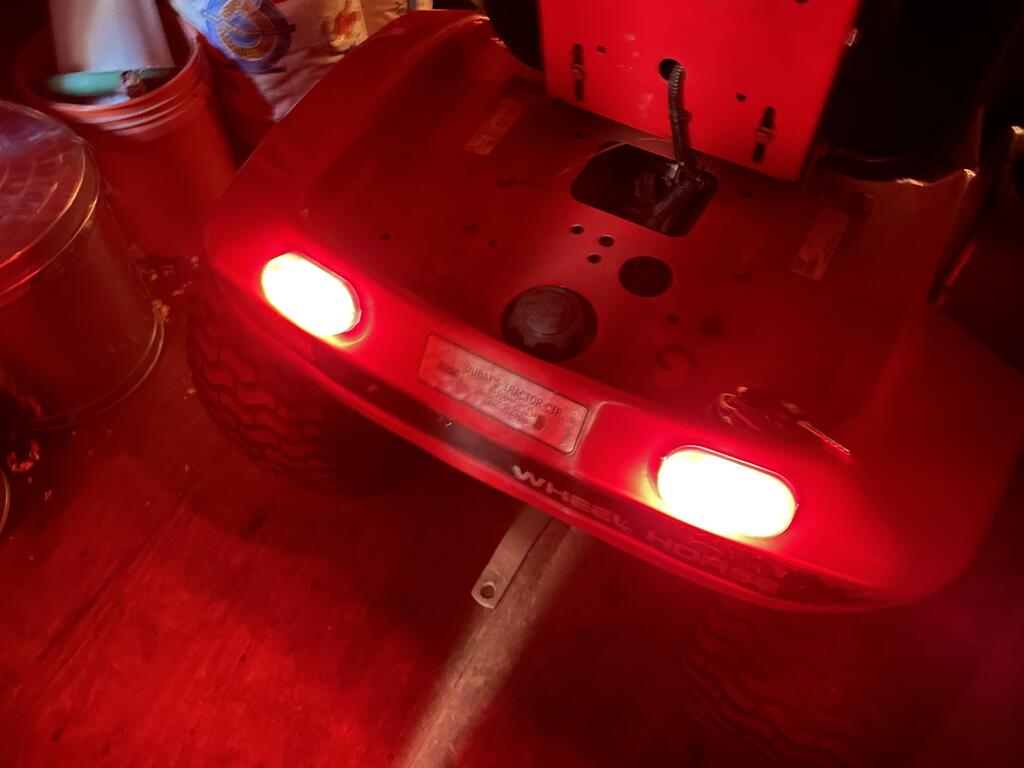

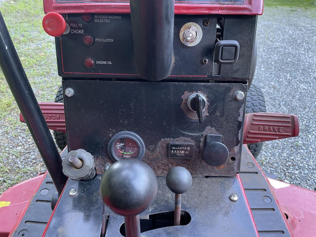

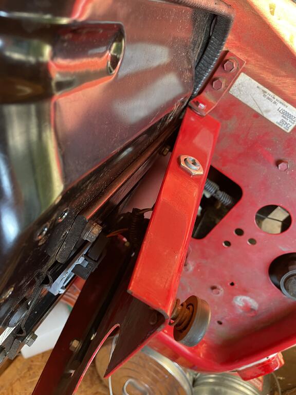

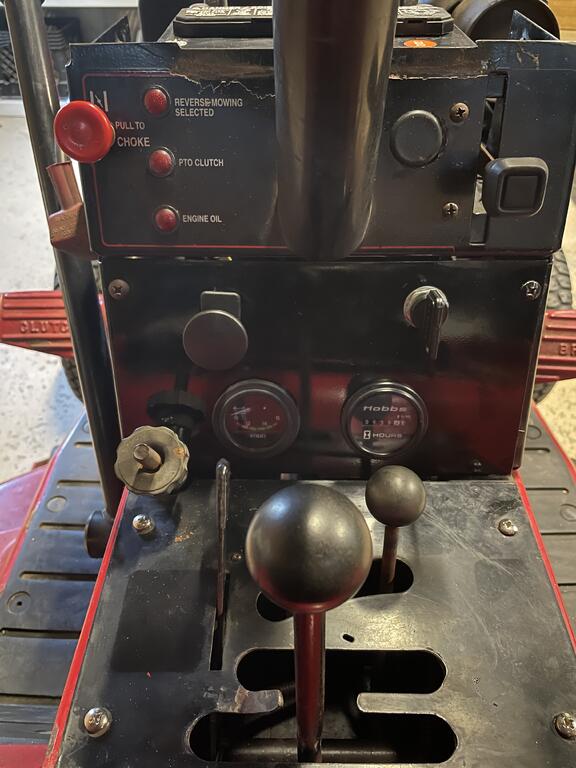

RustyGold 88 #22 Posted July 15, 2022 (edited) We’ll after many hours & sourcing many replacement parts . The horse is back running off the OEM umbilical cord as it’s supposed to .I had to solder extensions to all the cut harness wires & reconnect them with solder & heat sink tubing . I reconnected the front & rear lights which were also cut & non-functional. Put in a new control panel with the correct new PTO switch & new key switch. Sanded , primed & painted it with 4 coats . Went with a new round dial hour meter , since the existing rectangular one was broken 😡 I sourced a heavy rubber hole plug for the hole someone sloppily drilled next to the throttle . I even went through the trouble of drilling a hole in the seat mount bracket & installed the reverse key switch & seat safety switch which was missing of course . Replaced the solenoid with a OEM toro one . What a hack job the prior owner did . I learned a valuable lesson from all this , check & recheck everything well when buying used , not all sellers are honest ! Edited July 15, 2022 by RustyGold 3 Share this post Link to post Share on other sites
peter lena 9,092 #23 Posted July 16, 2022 @RustyGold you made out ,good for you ! taillights are solid bright , telling you solid ground , another thing about regularly going over your horse , is to take advantage its running condition and make improvements , for any related functional problems , basically , tweak / improve the function . typically levers and linkage ends are a sloppy rusty fit , add washers and grease , firm up the function and they work easier . ever think about a lubrication soak down on that paint ? it looks pretty good now , penetrating oil will feed that paint , spray it down , let it sit a day , wipe it down with a clean cloth, till dry , no sandpaper or scratch pad . do it again , that paint will pop with depth and slick finish . finish it with linseed oil rub down , only an idea , been doing it for years , paint looks very deep and solid . pete 2 Share this post Link to post Share on other sites
