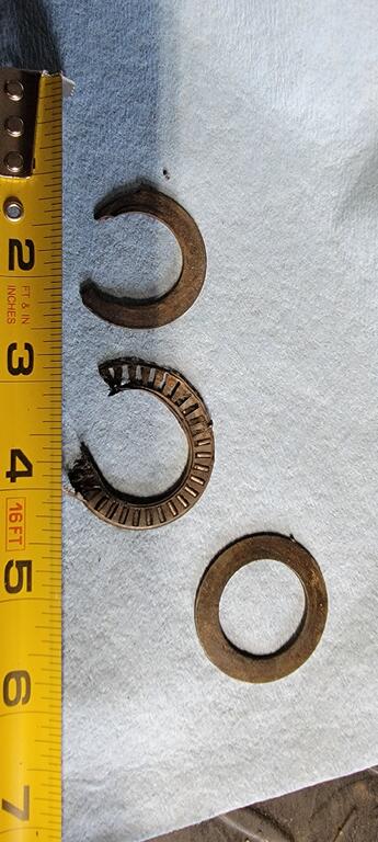

dennycc 11 #1 Posted June 28, 2022 I need this part it is a spindle for a c 195 . can anyone help me? Share this post Link to post Share on other sites
Jeff-C175 7,203 #2 Posted June 28, 2022 (edited) 31 minutes ago, dennycc said: it is a spindle for a c 195 Actually, that looks like a thrust bearing and washers. #32 and #33 Found in this part list: Check with Brian at K&B Horse Parts, he's listed in the vendor section. Parts Tree has the bearings for $12 each. The washers are supposedly 'discontinued', but Brian probably has those. I'm sure you can use a regular flat washer. Edited June 28, 2022 by Jeff-C175 2 Share this post Link to post Share on other sites

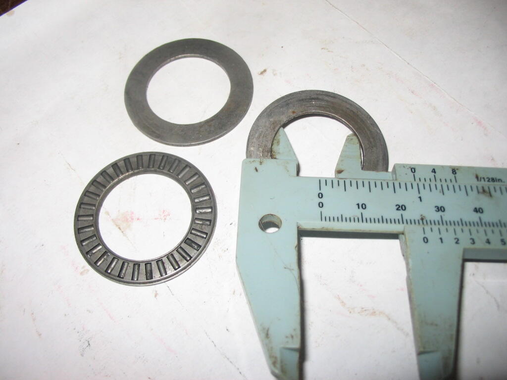

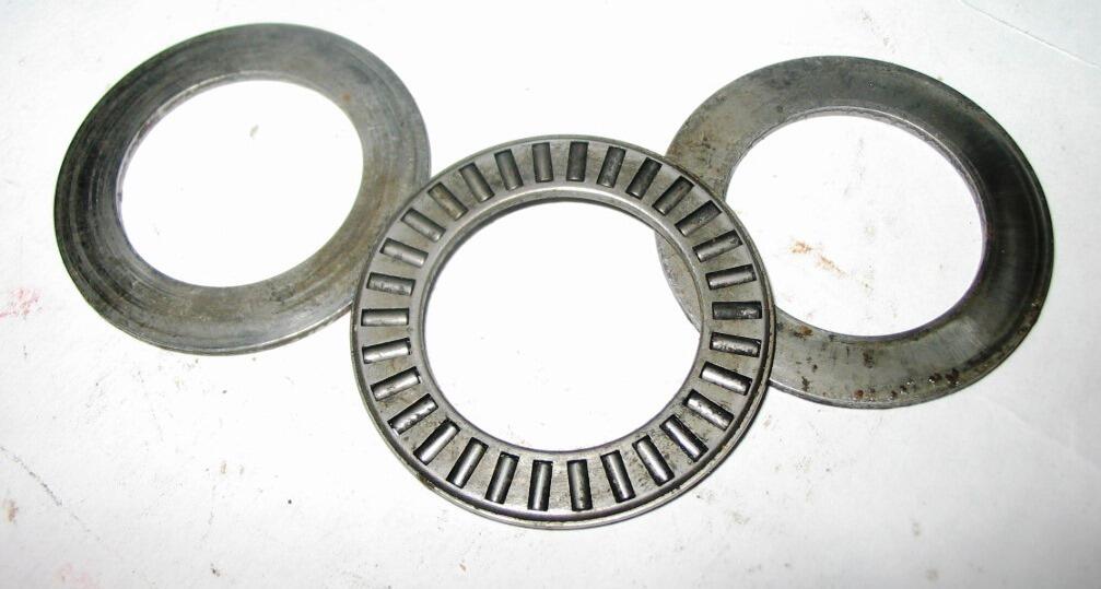

daveoman1966 3,813 #3 Posted June 28, 2022 This is for 1" spindle... THAT what you need? Put $20 in my Paypal and I'll send this set out to you. Paypal name is : daveoman@windstream.net 3 Share this post Link to post Share on other sites
8ntruck 7,395 #4 Posted June 28, 2022 Those washers are probably harder than a regular flat washer. They are flatter, too. Probably available through McMaster Carr. 5 Share this post Link to post Share on other sites

daveoman1966 3,813 #8 Posted June 29, 2022 This is a THRUST bearing. The two THRUST WASHERS are...in fact...VERY hard; hence the name THRUST. Regular hardware store washers will soon fail, taking out the thrust bearing too as they are just too soft. Secondly, these thrust washers are MACHINE ground for precision. 4 Share this post Link to post Share on other sites

pfrederi 18,336 #11 Posted June 29, 2022 Probably should get 2 sets other side may not be much better off. 2 Share this post Link to post Share on other sites
