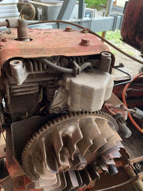

Hi I recently got an old charger 12 that had been sitting in a friends backyard for at least 20 years. The engine spins over and the starter works but it has no spark, I’ve been looking online for some solutions but I can’t seem to find any other charger 12s with my ignition setup. It seems to have a sort CDI box but I’m not sure. Does anybody know how this works or any tips on how to test for where the problem is ? 24F12862-1C5D-4FA6-AF12-D78385675267.jpeg.02846353310eed5905515f602b5e7528.jpeg

Welcome to the forum.
What is the engine model number, spec number and serial number?
Have a tractor model number and serial? Maybe under the dash panel.
Info under the dash:
model: 1 7253
serial: 730610
Info on flywheel cover:
model: HH120-1201290
serial: 0106       08015

I know 0 about these except they are self-powered so never apply battery voltage to them. That will release the magic smoke.
I suspect the unit can be replaced by this if need be.
http://overnight-solutions.com/Index_Files/TSSS System Information.html
The service manual Section 8 will help.
  • Like 1
gwest_ca
Here is a parts list for the engine but discontinued parts are not listed. Was looking for the ignition part number.
https://www.partstree.com/models/hh120-120129c-tecumseh-engine/
May be of some help
I can not find the ignition part number.
The engine is original to the tractor and is model HH120-120129C
Someone will know what you need.
