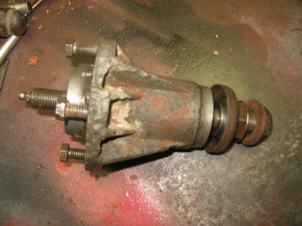

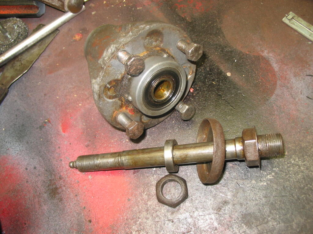

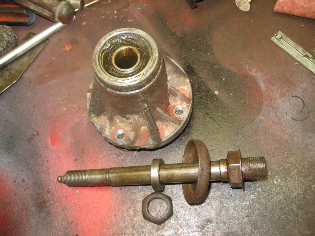

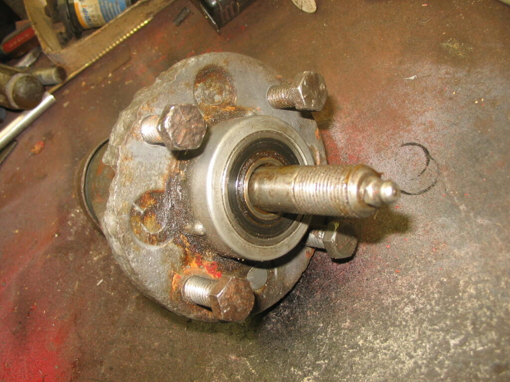

lynhill 1 #1 Posted June 21, 2022 I recently purchased a 10 hp (108?). It didn’t have a deck but found a 4’ deck that works on it. I don’t know that I would want to cut thick 6” grass with it often, but it works great for the ditches and roadside. The only number I can read is on the tag and it appears to be 5902090. I don’t think this is the model number, but the serial number. The housing is broke where the lock ring attaches at the bottom. Any suggestions? Thanks in advance. 1 Share this post Link to post Share on other sites
