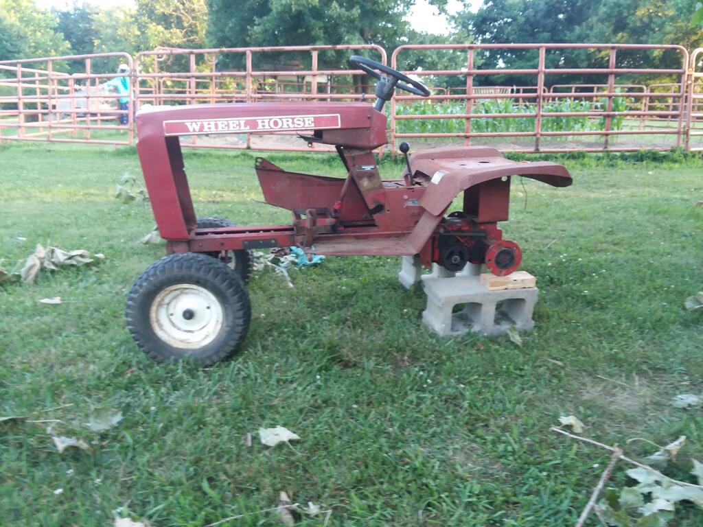

TJ5208 1,824 #1 Posted June 21, 2022 This is my first project I'm planning on putting a 212 Predator on it and pulley swapping it to be faster. The tractor is a 1976 C120-8. I just need a belt guard and engine mount. 3 1 Share this post Link to post Share on other sites
Achto 27,250 #2 Posted June 21, 2022 May not need a belt guard if you can position the Predator to line up with the one that is on the tractor. Good luck with your project, don't forget to keep us up to date on the progress. Share this post Link to post Share on other sites
953 nut 54,308 #3 Posted June 21, 2022 Measure the center line of the crankshaft to the base of the engine on the Predator and do the same on a Kohler, if memory serves me right the crank on the 212 will be a couple inches lower than the Kohler. There are a bunch of threads on this site to look over for Predator Engen swaps. https://www.wheelhorseforum.com/search/?q=predator engine swap&updated_after=any&sortby=relevancy&search_and_or=and Share this post Link to post Share on other sites
