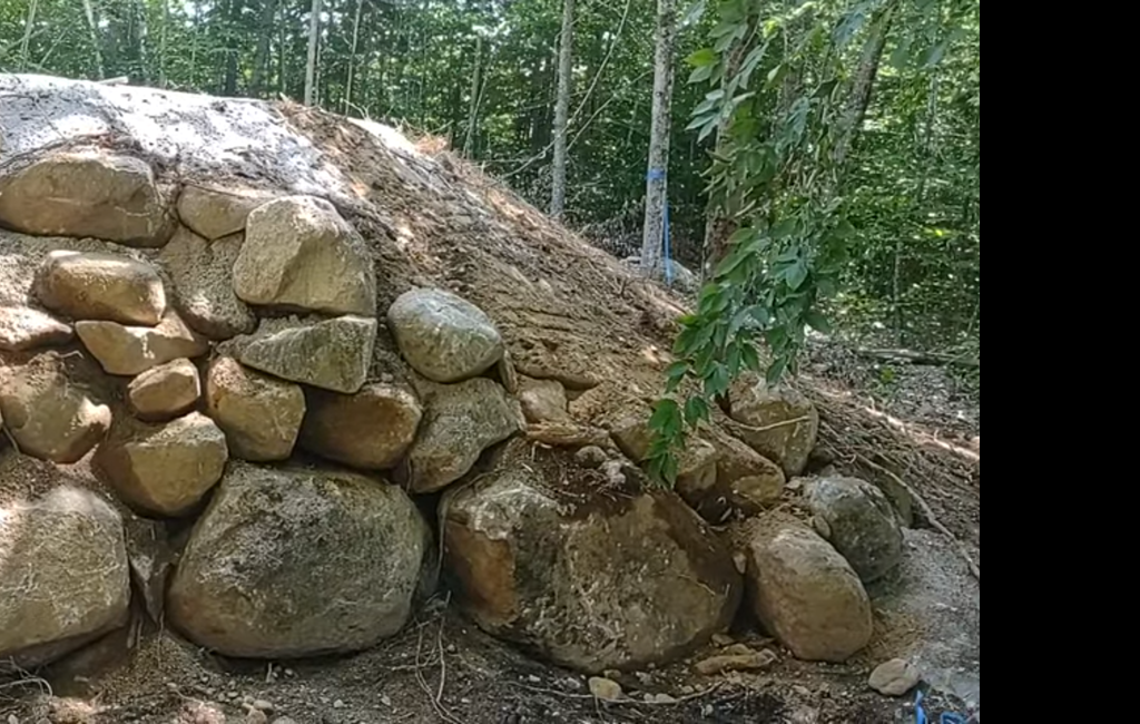

19richie66 17,560 #101 Posted August 21, 2022 That is very nice. He did a great job. 2 Share this post Link to post Share on other sites
ebinmaine 70,431 #102 Posted August 21, 2022 Just now, 19richie66 said: That is very nice. He did a great job. Absolutely agreed!! I've liked stone/rock walls since I were a wee one and had a nice row of boulders to play on. I'm VERY impressed with the way our new wall turned out. I was hoping to have the back of the area further into the woods so I can access the rear building door easier with the truck. Not a big deal. Trina and I will clean up the log pile and rearrange the stones in front of the building. I'll relocate the building a few feet closer to the road. Easy fix. There's a nice ramp on the far side of the area at the back for access to the forest on that side. It's a bit steep but no more so than a couple of the hill paths out in the woods we built ourselves. Should pack down nicely. He also built in a little ramp off the far side of the driveway for easier access. Again not something I asked for. Excellent work. 2 Share this post Link to post Share on other sites

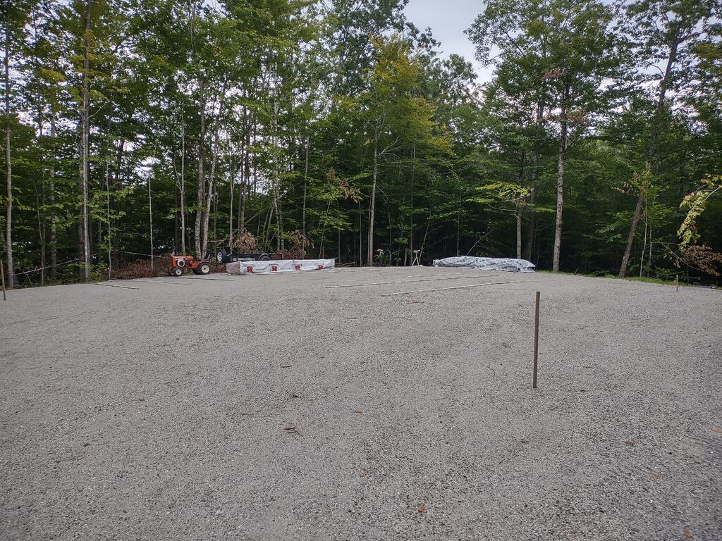

ebinmaine 70,431 #103 Posted August 25, 2022 At the back of the new excavation area there's a hill that covers maybe 15 x 40 or more square feet in area. Knowing we need to prevent erosion I asked the owner of the construction company and the counter folk at our local farm supply store. Both advised a fast growing winter rye wheat grass. I picked up a 50 lb bag and Trina and I tossed chucked and broadcast the wee little seeds all about. In the mostly shaded area we should see germination in a couple weeks. Not the best pic but it's the only one I have... Share this post Link to post Share on other sites

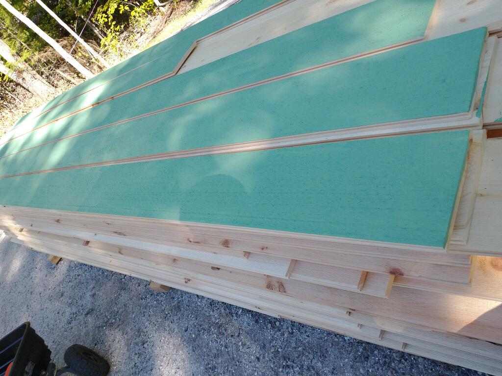

ebinmaine 70,431 #115 Posted September 17, 2022 This afternoon Trina AKA "The Paint Department" began coating the siding boards for the pole barn. 1 x 10 T&G rough one side. 1 1 Share this post Link to post Share on other sites
Oldskool 6,660 #116 Posted September 17, 2022 Looking good. You should get that girl a spray gun. It would free up some backhoe time for her. 1 1 Share this post Link to post Share on other sites
ebinmaine 70,431 #117 Posted September 17, 2022 7 minutes ago, Oldskool said: Looking good. You should get that girl a spray gun. It would free up some backhoe time for her. Yyyeeeaaahhh.... She's uhhh.... "Old s'kool" We have a couple guns. The Paint Department likes her rollers. 3 1 Share this post Link to post Share on other sites

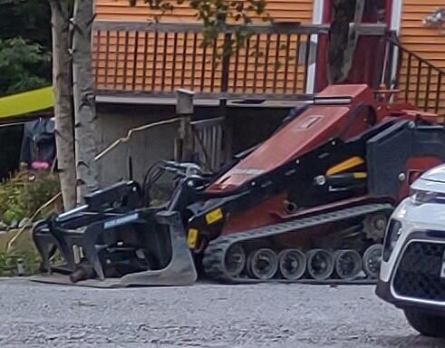

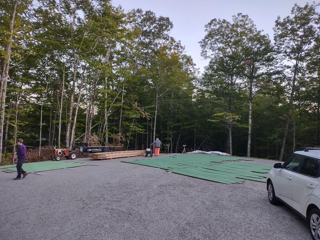

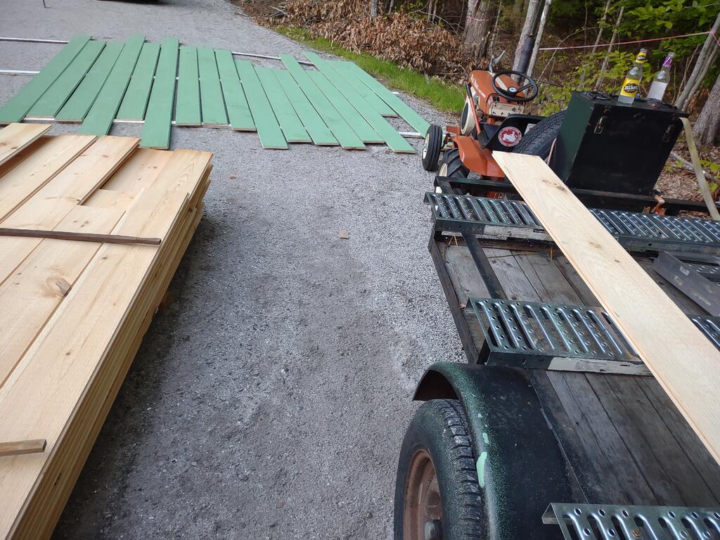

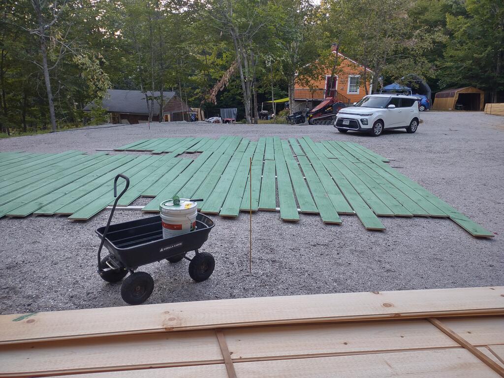

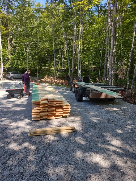

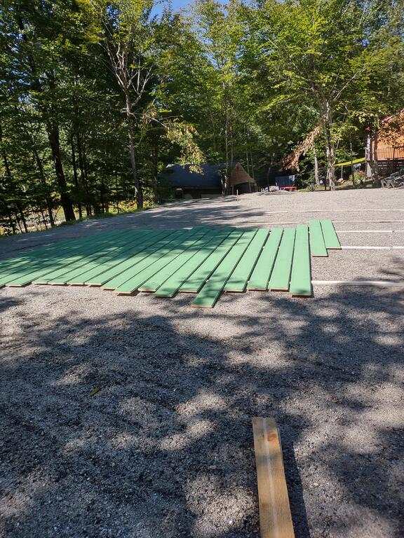

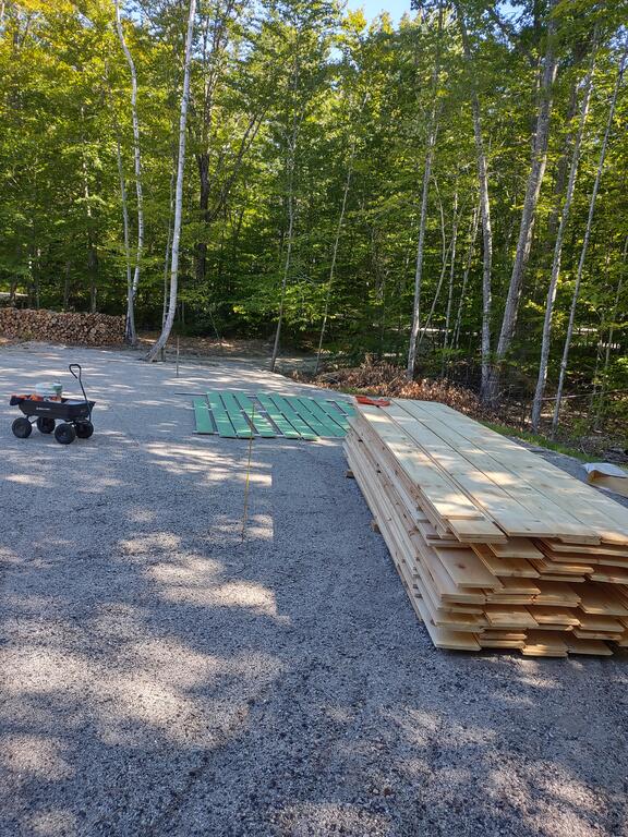

ebinmaine 70,431 #118 Posted September 17, 2022 WOW!! Did we get some painting done today. ..... Somewhere in the neighborhood of 1000 sq ft. That'll be more than enough to cover the second floor and then some. Here's a few pics starting from this morning. Trina and I were rolling the face and groove edge. Her mom was brushing the top surface of the tongue. We started out both just painting right on the pine unit but I found after a few minutes I needed a higher work area. Cinnamon Horse C160 and the utility trailer worked quite well. Long shot of the whole shebang. Earlier this morning the builder left his trailer and this Ditch Witch brand machine. Forks. Light ground work. Most importantly.. it's the auger for making the pole holes. 24" diameter holes 48"+ deep. Around 28 to 30 of them. 7 Share this post Link to post Share on other sites

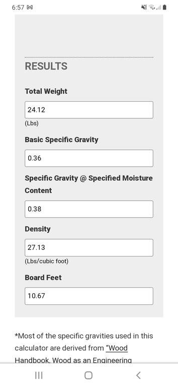

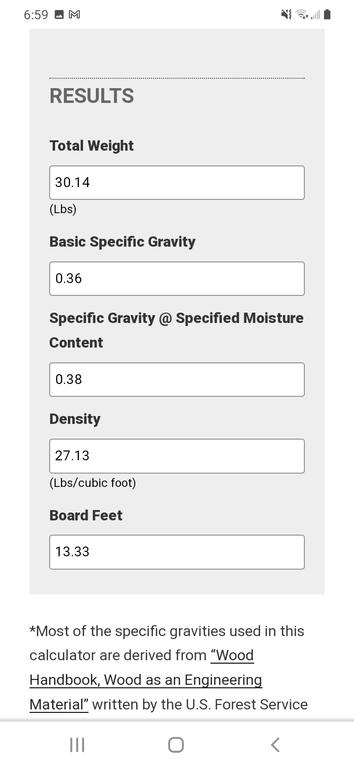

Handy Don 13,296 #119 Posted September 18, 2022 1 hour ago, ebinmaine said: Did we get some painting done today. ..... What do individual planks weigh? Share this post Link to post Share on other sites
ebinmaine 70,431 #120 Posted September 18, 2022 47 minutes ago, Handy Don said: What do individual planks weigh? The longest are 16'. I'd say 30, 35 lbs each. 1 Share this post Link to post Share on other sites

Oldskool 6,660 #123 Posted September 18, 2022 9 hours ago, ebinmaine said: The longest are 16'. I'd say 30, 35 lbs each. First pic 1x8x16' Second pic 1x10x16' 1 Share this post Link to post Share on other sites
