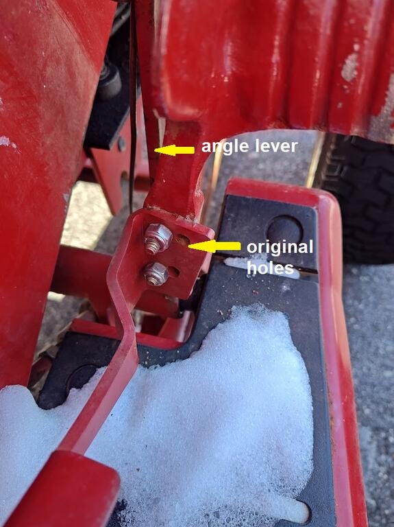

I have Matt's foot pedal on my 416-H. I will never go back. I had the column lever, but I removed mine. I can't think of a reason to leave it. By doing so, you don't have to worry about adjusting the tension on the cam plate. Since you are using your foot to maintain forward speed, and the linkage is always returned to neutral with a spring, you can loosen and lube that area. As far as the reverse pedal, the only modification that I did was to re-drill the mounting plate and move it outward so it didn't conflict with my snow plow angle lever.

The neutral switch was relocated but I can't remember where I relocated it. When I get back from the show I'll take pictures.
